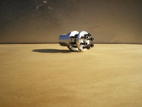

I think I have a 16x6 or 16x 8 oon the ryobi and it is turning about 7450 rpm I would like to try a homelite I think. I am pretty sure my electronic ignition from thje ryobi would fit on it but I need to make a ne prop adapter for it. anyone have a pic of a prop adapter for a short shaft homelite 30cc?
Old 05-19-2008 | 10:20 PM
buck1856's Avatar
My Feedback: (49)
Posts: 1,158
From: Superior, AZ
Default RE: Should I do a Homelite 30 to replace my ryobi?
Heres one i made for an echo.But the thread size on the homy is the same as a ryobi.5/16thsx24.A short shaft ryobi and homy can use the same adaptor.

I have the hub that mounts to the tapered section,with a magnet in it for the electronic ignition I just need to make the part that holds the prop. does this thread directly onto the shaft? is it ok if the threads are aluminum? will they hold up OK?
then you use a bolt through the center (what size and thread?) to hold the prop on. or like the echo one BUCK1856 made with the small screws threaded into the end. Correct?
Old 05-20-2008 | 09:15 PM
buck1856's Avatar
My Feedback: (49)
Posts: 1,158
From: Superior, AZ
Yes ya just thread the hub onto the shaft.Yes its ok if there aluminum.They will hold up fine if there T6 but i dont know about the other kinds of aluminum cause i only use T6.And yes you can use a single bolt in the center.I would use a 5/16thsx18 NC.Course threads hold better in aluminum than fine.The only reason or 2 i did the 6-bolt hub was for a WWI plane and i had just purchased my lathe and i was trying out it and my new drill press to see how everything was alighned and checked for runout.Plus it just looks cool on a small echo engine.You could also use a piece of all thread or a stud and then use a nut like on a glow engine.

I am going to have to either buy one or have one made because I just don't have the tools to do it properly right now, would anyone be interrested in making one for me? I am willing to pay for it!
I have the part that fits on the taper I just need something like you have pictured ther BUCK1856.
