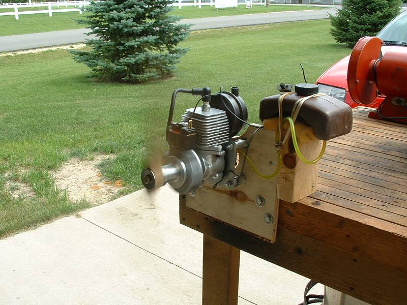

Love this site-Found a second hobbie/passion and reasons to use my shop, lathe ect...
Question-My first conversion a Ryobi 31, short shaft, running a #28 carb (11.1) i believe, a Scimitar 18x8 prop and 40:1 mix. I'm getting 6600 even for RPM-Is this about right or is this motor tired. Like to see 7200-7500 with this prop without alot of mods. I'll will try opening the exhaust.

Heres the results:
18x8 Scimitar Prop, #28 Carb-11mm, 40 to 1 Huski oil, Started at 6600 rpm
Cut extra hole in muffler-6720
Gutted the exhaust with two outlets/ bend reed valve stop-6840
Changed to Amsoil 100 to 1 mixed at 80 to 1-6930
Thats going to be it. The bowman ring should help, but without advancing the timing i don't think she will see 7200 to 7500 with that prop.

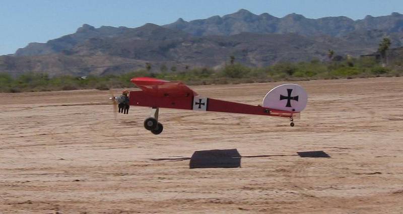

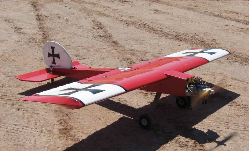

I have a Giant Big Stik. It is a fun plane and a good test bed.
Good idea Captain John:
Frank Bowman says for the most power, use just one of his rings, even if the engine was a two ring engine to begin with. He says for the longest life, use two rings. Lifespan usually isn't a problem with these engines....

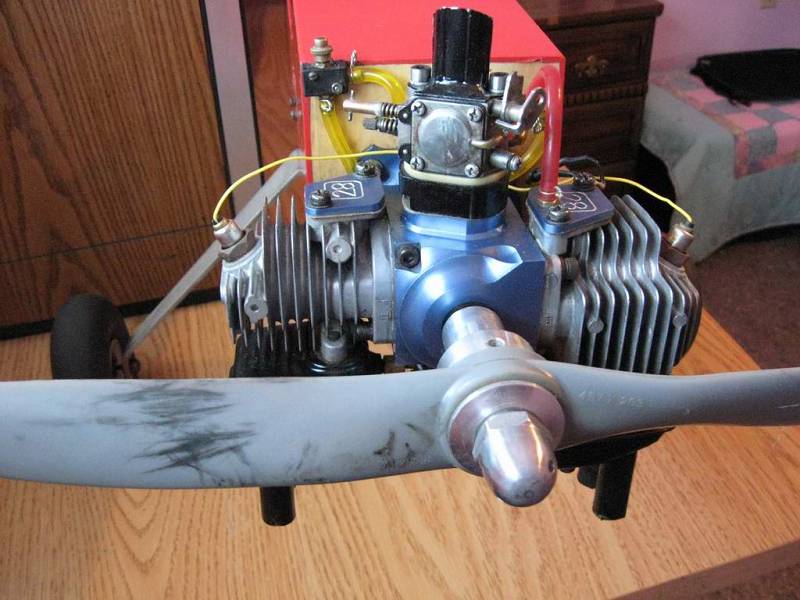

Av8tor-That is a neat engine, do you have a closer shot, looks like you did something to the exhaust-Variable perhaps???
Old 06-27-2008 | 11:49 AM

Default RE: Ryobi Experts
It is a twin I made out of two Echo 23.6 cc engines. There is more info about them in the BME Twin thread.
YEP! All of the above!
The red hose going to the original intake port, and the needle valve on the firewall are for the impulse pump type smoke system. Looks pretty cool with smoke coming out of the four exhaust tubes...
