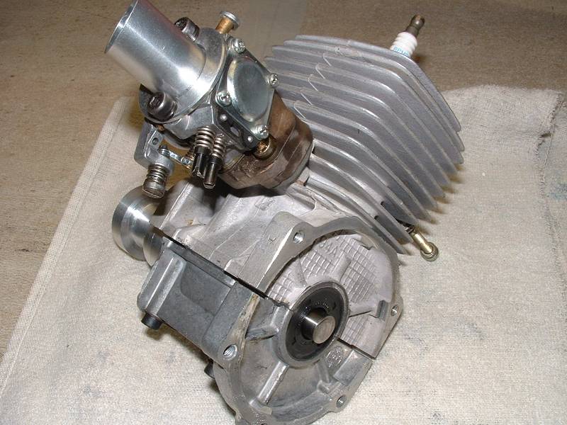

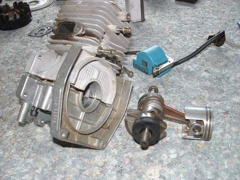

I haven't seen this engine posted, hoping someone could tell me if it's worth doing. It's a Jonsered Big Red-BR420, 40cc. The motor is by Efco and built between 1990-92. Needs new main bearings and rings (Dual Ring), don't want to spend$$$ if not worth it.

Whats the matter with the ball bearing on crank? How are the seals? Mostley....how is the cylinder bore? Capt,n
Old 07-21-2008 | 01:36 PM
Joined: Apr 2007
Posts: 1,111
From: Lancaster, WI
Default RE: Jonsered BR420 a gem???
The Bearings feel slightly pitted, everything else is fine, someone must have thrown this in the corner of the garage for a year or two. Have you converted this???

Jonsered engines are a class act.
I understood that they were built by Husqvarna and were an up scale version on the standard Husky..
The lower grade engines had plastic lower cases, as did a few other brands.
It looks easy to convert. I say go for it.
One thing I would do is get a set of rings from frank bowman.
ringmaster46msn.com
If you sent him the cylinder and piston you would end up with a "perfect Fit"
Yes I believe franks ring are worth getting and the cost is very reasonable.
By the way, because it is a chain saw engine you will not need to do any port work.
The porting on saw engines are just about perfect for airplane use.
What are the numbers on the bearings? NO use paying more than you have to.

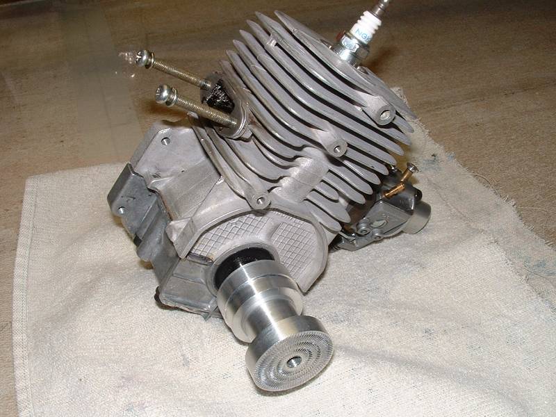

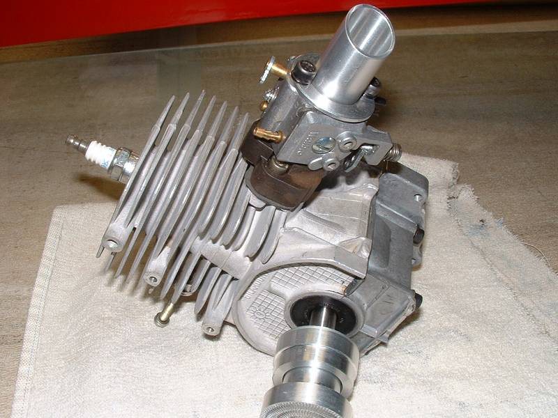

I'm getting close on the Big Red 40cc. Need to finish the sensor mount and muffler. The engine as shown weighs 3lbs 3oz. This is a very solid engine and i hope it runs well. Not sure of what prop to run on it.

Hello
i am inspecting your photos and see in front of engine a label "GILARDONI" , i believe it is because the first photo hide the last letters because of angle of shooting.
If it is true , the Gilardoni label , you have a real gem, Gilardoni is famous making cylinders for motorcycle and made cylinder for world champion engines like minarelli.
I have Alpina engines, made in Italy and the cylinder is Gilardoni.
Good luck and enjoy.
Happy landings
Jose

Well that explains it. It is made in Italy and the quality is super. Finished the Sensor mount and installed the Magnet and locking screw for the adjustable collar last night Thanks for the post.
