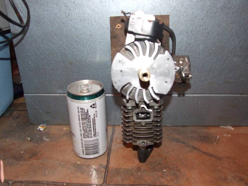

GOOD NEWS the engine is all stipped down and looking good. its down to 3 lbs, is that good for a 40cc engine (2hp)? now i need to turn up a longer shaft, and make a mounting plate. is left hand thread good or made for the prop? i ask because most rc engine i know have right hand thread, is this for any special reason??

Is there a chance we could see some pictures?

ok here they are, got everything but the prop and the exhaust on, can is standard size. it now weighs in at 3.7lbs....

Old 08-31-2008 | 09:47 PM
Posts: 12,957
From: Hesperia Michigan, MI
Default RE: stihl 009l help!!!
e300s, Can you take the wood off the back of engine and post a photo. I got a simular engine. Thanks , Capt,n
