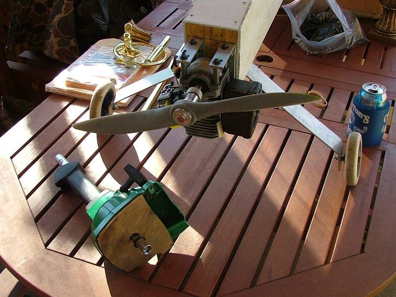

Here's a picture of my 42cc Poulan on gas/glow setup along with my homemade starter. Check out this thread for more info on it.
[link]http://Success! Poulan 42cc on gas/glow[/link].

Plastic Master-Is that a homemade starter??? Interesting and neat idea if it works. Thats what i love about this forum-Ingenious ideas from some clever people. Does it work? probably don't need it with EI Ignition.
Joined: Apr 2004
Posts: 190
From: irmo, SC
Frenchie79, indeed it does work. It's a homemade starter that I made from the recoil of a weedeater. It works very well. Read the thread that I linked to for a full description of it. I don't have this plane and engine anymore because I crashed it a few weeks ago and totally destroyed the plane and engine. I was running the engine on gas/glow and used my homemade starter to start it for the first flight of the day. After that, I could usually flip start it with my hand (wearing a leather glove of course).
