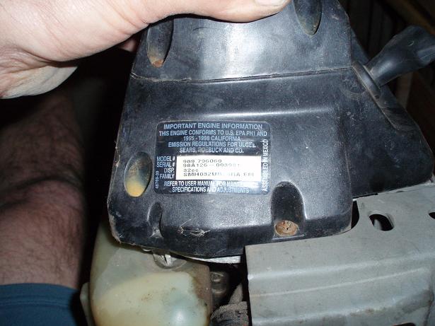

Hi all! I just came across two more weedwackers for conversion during this winter. One is a Stihl FS80AV and the other one is a Crapsman 32cc. I need to know the cc of the Sthil as Google says it's 25cc but the cylinder looks a bit small for that. The Crapsman I need to know the engine manufacturer because as usual Crapsman is absolutely no help on this one, maybe a Poulan?
The first picture of the naked engine is the Stihl
I would be grateful for any help
Thanks Rich

that craftsman is a McCulloch 32, I haven't seen any of them like that, they're usually the Poulan thats like the Ryobi being rear carb and exhaust
if you're interested I have a prop hub made up for the mac for using the flywheel, I swapped it over to gas/glow and just made a one piece hub for that purpose... I also have the trimmed mag mount plate if you're interested...
I believe that Stihl is a 25cc, there's been a couple of them on here lately, I have one, I never did get the Mikuni carb on that thing to work even after a rebuild... but I just put it together the way it came apart which could have been my problem...

That Crapsman has got to be the loudest most obnoxiuos weedwhacker I have ever seen!!!!! I had it running for a few mins and my ears were ringing for ages and my hands went numb!!!! As usual the previous owner messed with the mixture settings and wrecked it and that's why I ended up with it. A couple of mins on the mixture screws and it runs really well if not loud as hell! As for the Stihl, that was dropped on the floor or ran over by the previous owner and it broke off the front cover. I need to get it to my work and have the cover spot welded so I can see if it works ok before spending time and money on it to convert into an airplane engine. It also needs the exhaust port welded and re machined as the previous owner ran it with a missing exhaust bolt and the muffler wore away the exhaust port! Thanks for the offer on the prop hub but I am going to run both these engines on CDI and will machine up my own prop hub to suit. The Mac is probably going to end up in a boat so I will have to machine up a hub / flywheel and a water jacket. I'm going to machine the cooling fins off the head and weld a water jacket around it.

on the mac, the spring attached muffler had a gasket, they don't do much after a few years of service, mine was gone completely, once it's to that point it's easy to get out of it's cradle or whatever you want to call it, with the stock unmodified muffler they're a little louder than say a weedeater brand, but not much noise comes out of the 1/4" hole in the thing...
with the two 1/2" tubes coming out of my muffler, it's pretty loud in front of my garage, but pretty quiet at the field...

The FS 80 is 25.4 (26CC) I fount the FS74 to be 22cc. Nice running engine, Don't like the end play with these but is a strong runner. Check out the Stihl site above.
