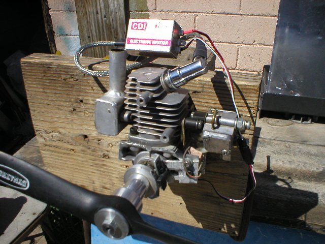

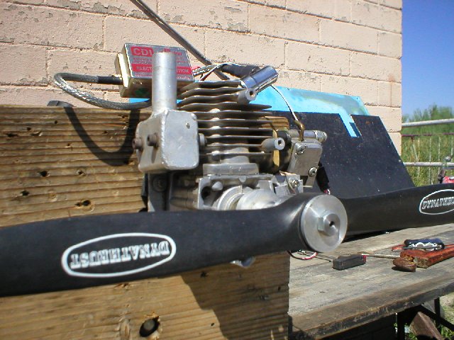

Heres a few pics of my stihl 28cc.Youll notice it can be rail mounted like a glow engine or flat mounted from the 3 lugs on the back.This engine weighs 3-1/2lbs as you see it in the pics.It will swing an apc 17x8 at 72oo RPMS.Its off a FS46 trimmer.

Heres a 24cc echo off of a SRM2400 trimmer.Basicly the same weight as the stihl.

ORIGINAL: buck1856
That looks like the one that was on sale on The Bay. Same ignition, actually the same pics.
