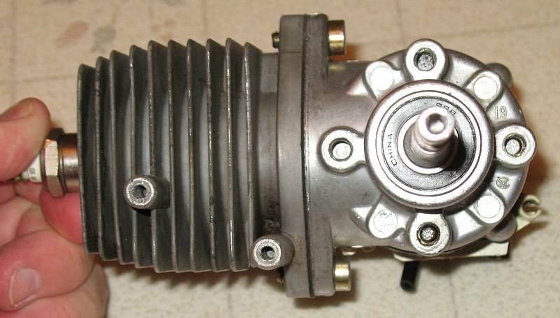

Other than knowing the brand, what's the secret to identification of any particular engine? I can see measuring the bore and stroke by taking the engine apart, but what if there's no other markings on a motor? I just got a Stihl engine out of an older FS-40 line trimmer, but it sure doesn't have the rail and rear mounting holes like the other Stihl motors I've seen on this site. It looks noticeably smaller than the Poulan 30cc I found. Is there a book or manual that has the info to determine exactly what critter you have on your hands?

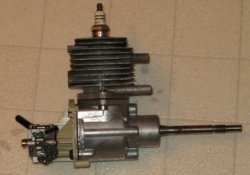

Yup,think i had one once.I think stihl came out with a cheaper curved shaft trimmer just for lower income population.I had one thinking it would be some great engine to convert and when i dismantled it thats what i found,a long shaft ryobi 31cc.sold it.

Ryobi, huh? It has the letters "ST" inside a big letter "C" on the lower right front of the crank case - wouldn't that mean "Stihl Corporation" or something like that? Also on the front of the crank case is a "5" with some dots on/around it and a raised "19". The jug has a "B" cast on the lower front corner and on the back a "11" on the left side of the exhaust port and the "95" on the other side. The carb is a Walbro, it has "Stihl" on one of the plates, "62-118" on the choke plate, and "WT 160B L" on the side.
The stroke came out to 1.300". It was harder to measure the bore since the exhaust port is split down the middle by part of the cylinder liner. I tried to measure it the best I could and got 1.350" on the diameter. That would work out to 30.49cc. If I was off on the bore by even a little (say it was 1.30 instead of 1.35) that could change the numbers by 2cc or so.

NG,farley has a repair shop,he knows his stuff.Anyway,theres nothing wrong with the long shaft other than your right.You would just use a short hub,put prop on,then use a nut and washer on top.Or cut crank and rethread.Theres just to many shortshafts around that are easier and mine have 2 rings.[not thatr it maters much].Ive attached a pic of one of mine i sold.Converted to cdi ign.
Your also right about the ccs.Your so close at 30.49 that its a 31cc.If you want to use it let me know i have a hub setup already made for that engine that im not going to use.PM me if you need it.
