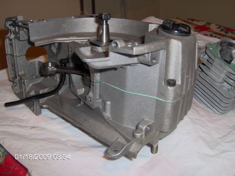

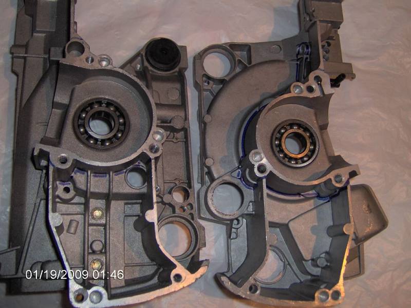

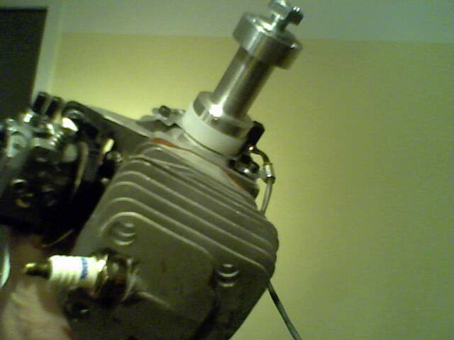

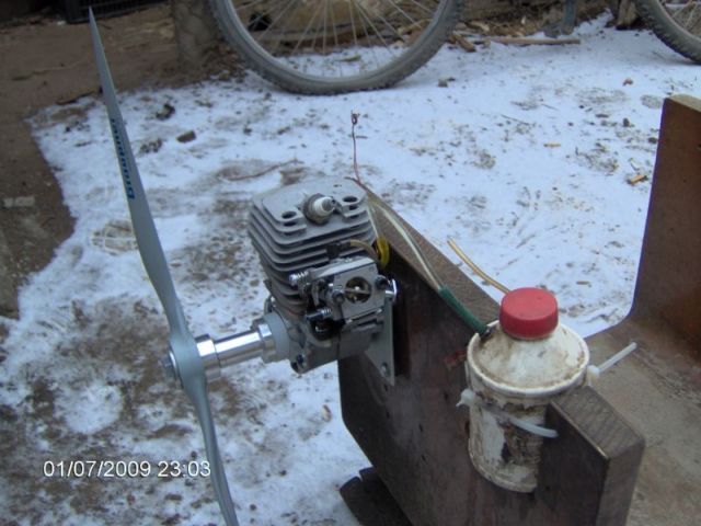

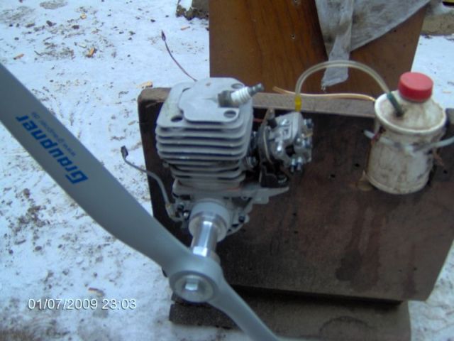

Hello,
I managed a new conversion, a 45cc Chainsaw made in China without a name. Results: 7500rpm without silencer and 6800rpm with original silencer, prop 22x8 g-sonic graupner
Best regards
Mugurel

To the label was written only Husqvarna, nothing else.To the chain was not written Husqvarna. Cylinder is the same as in ZG45 and those of almost all RC 45cc engines manufactured in China, Bore = 43mm, Stroke = 31mm (same ZG45),has 2 rings on the piston. At Chainsaw crankcase body made with a bath oil for chain.These parts were cut. At Husqvarna is not so. The engine is separated from the rest being fixed with four screws.
The engine is almost identical FTL45 from Hobbycity
Best regards
Mugurel

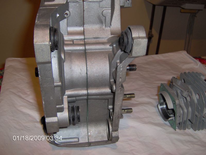

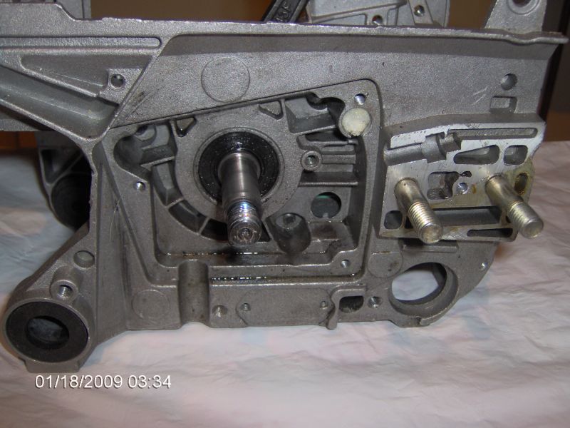

Hello,
I found a new Chainsaw of the same model of 45cc converted. Everything was just on the outside, the same labels, the carburetor, close the cylinder, piston differ in shape. Surprise is 50cc engine. 45 bore and stroke 31. Put some pictures of the engine block. I got the engine without plastic carcasses.
And I have to work again![:@]
Best regards
Mugurel

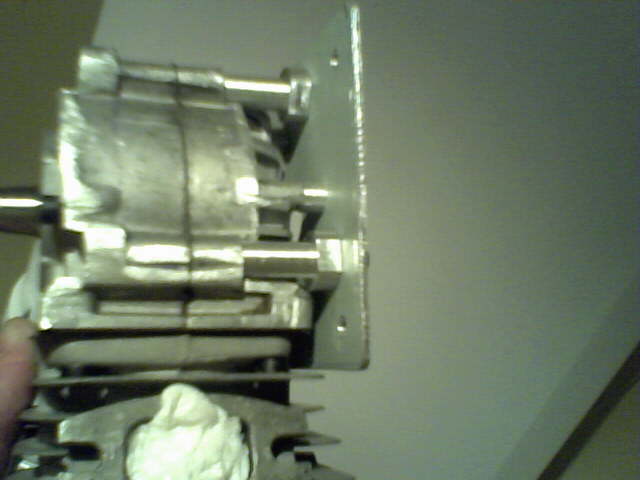

Hi,
Crankcase is ready to cut. While the engine was new, original ignition and crankcase gaskets are damaged. In other engine seems OK. My friend Jimmy put ignition from 45cc engine and started. Continue after cutting.
Best regards,
Mugurel

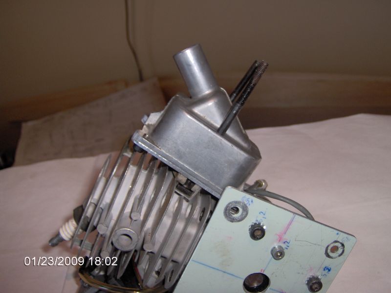

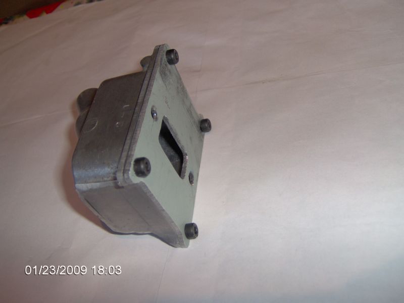

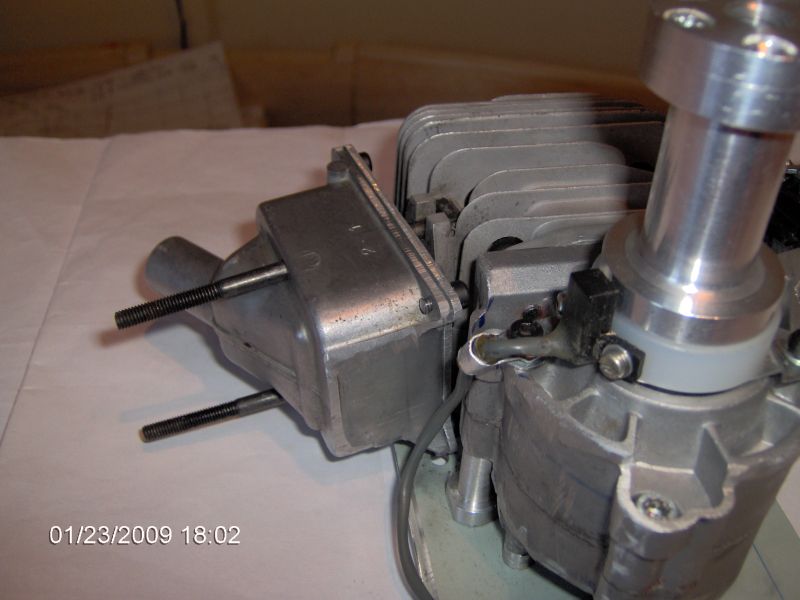

Hi,
I finally managed to make me a muffler, light and compact, 100g- 0,22lbs, so the final weight of the engine is 1800g- 3,97lbs. I play the muffler is made from air filter housing from an old Mazda 626. Volume is nearly 2 times the capacity of cylindrical engine so it is OK. May need to adjust screws, bushings to do the 2 screws to mount the muffler. Also need to make an intermediate piece between the muffler and engine.
Best regards,
Mugurel

Today I did test the engine -static thrust: 10.5 kg (23.2 lbs) , G-sonic graupner 22x8 ,rpm=? . I think it's OK!
Regards,
Mugurel

Hello,
now my engine is running very well. Start very easy and never stops in flight. I changed the ignition with Rcexl for 10mm spark plug.
http://www.youtube.com/watch?v=va8eU8KtWRI
Regards
