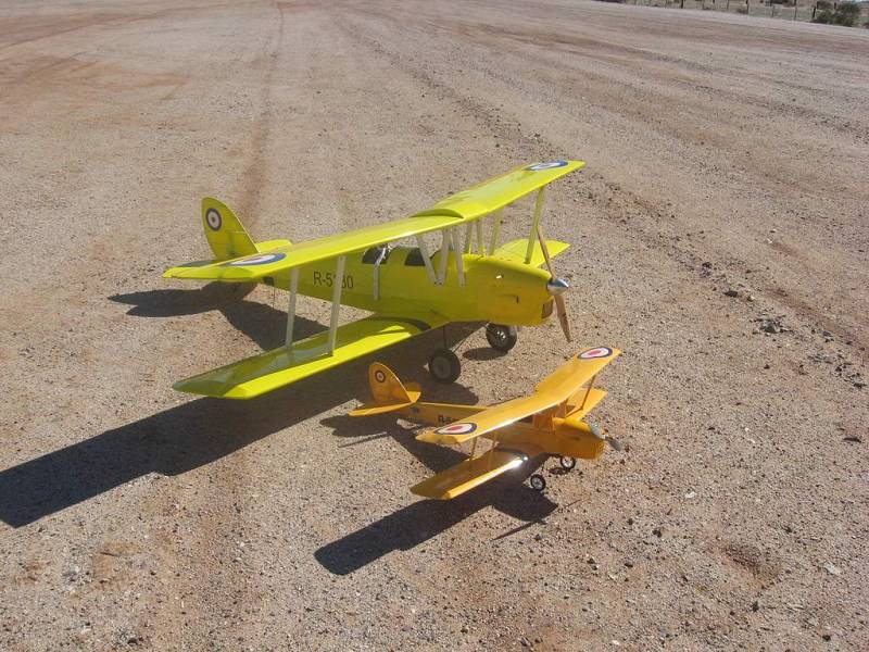

Hi,
Just thought I would post some pics of my NitroPlanes 76" wingspan Tiger Moth. It has a Ryobi with an 11mm carb, aftermarket two tube muffler, exhaust port timing raised to 150 degrees, cylinder lowered by leaving out base gasket, and CDI ignition. It turns an 18 x 6 prop at 8500 rpms, which is too high for the Ryobi, but I will put a larger prop on later, and for now just avoid high throttle. That is no problem, because the bipe flies well at less than half throttle, and can do huge loops at 3/4 throttle.
I really like the setup because it flies well, and the engine fits entirely within the cowl. I modified the plane to have four ailerons instead of two, and I am glad I did. It looks like the large Tiger Moth that they sell now comes with four ailerons.

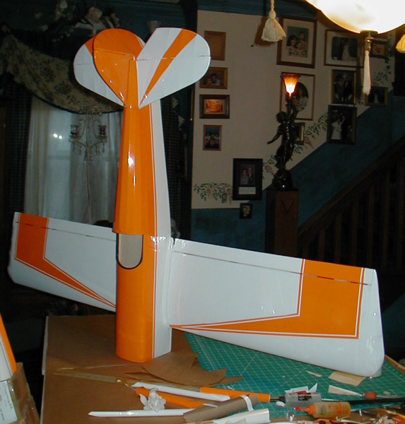

Hey AV8TOR what size is the engine? is it a 31 cc? How does it fly with that engine?That is the engine I have for mine.I do agree with you that engine really fits well under the cowling. I posted some pictures of it last year but I have not had a chance to get back to work on it yet and I have alot to do.What kit is it? mine is a Duncan Huston.I just finished covering my Nutten Special that I will put a 25cc gas/glow in and then I have to cover my ultimate 10-300- and then cover a wing for the Sig LT 40 and then I can start back to work on the Moth.Out here I have a couple months of work time before it gets warm enough to fly so hopefully I will get everything finished.OH yes I have a few engines to finish also.

Thanks for the comments guys. I've always loved the classic lines of the Tiger Moth. I've often thought about building a full size one to fly myself. (LOT of work....) I've built RV4's and a Harmon Rocket in full size, but they were for other people. It would be cool to have a Moth to cruise around in on nice days, but in reality it's a dream project I will probably never get around to doing. But hey, the model is fun.
Yeah, it is the 31cc Ryobi. My brother has a stock except for gutted/large outlet muffler Ryobi 31cc on his 14+ lb. Ryan Rebel and it flies just fine, including aerobatics. I really didn't need to hop this one up for this plane, but I'm just that way; I can't leave anything stock!!
