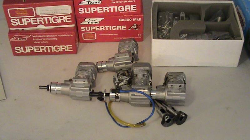

here is what I do with them
ID:	1123125   Click image for larger version
ID:	1123126   Click image for larger version

Hellow Ken.....keep up the good work!!! Capt,n
