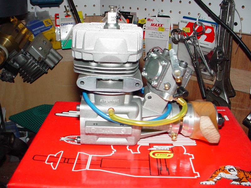

Got my engine running today on the test stand. I played with the timing and got it pretty close. The problem I have now is with the carb. It's a walbro 414 I believe is a 13mm. It's flooding the engine and the only way to get it started is with an electric starter. I have to disconnect the pressure line to get it to run and as soon as I hook it back up it dies immediately. I think I need a different carb, maybe a smaller one. Any suggestions?
Also the engine is inverted and gas steady drips when its not running.
Old 05-11-2009 | 08:40 PM

"pressure" line with a walbro carb? Is that correct? Do you mean your using a pressurized fuel tank with a walbro carb?

I bought a carb adapter from Ken Lambert which has a fuel line nipple on it. In the pics on his website the line is hooked up to crank case pressure to work the diaphram. My fuel tank is back on the CG so I need the carb pump. I know I'm doing something wrong, I just don't know what.
Since I have got off the subject, Ill stop here and do a search about troubleshooting walbro carbs.

Your plumbings riht in the pic.
\Crankcase line goes to the adaptor with supplies a pulse to the carb.
Tank line should go to black nipple.
If theres another nipple,block it off.
Vent from tank goes to where ever its not in the way.
In a plane i make one coll on top of tank,starp it down.Then i run the line out the bottom of cowl towards ground.
The only time a carb will drip fuel on its own is whe the needle and seat are stuck open or wrn out.
There under the cover with the 4 screws in it.
The pump is on the other side with 1 screw.
Get a different carb or reset the needle.Or take it to a repair shop.Or buy a new one.[from here on RCU or ebay].

There are a number of things that can cause a walbro to "flood". Buck mentioned a couple of items above that will cause the problem and also the rocker arm that moves the needle can get bent up too far and cause the needle to stay off the seat when the diaphragm and cover are installed. Like you said, do some research on the walbros and you will find a wealth of information. Also, the kit for these little fellows comes with a new needle, rocker, rocker shaft and many other parts including new diaphragms and they can generally be found for less than 10 or 12 bucks. My friendly neighborhood lawn mower shop sold me mine for $7.95. Good luck with the Tigre.

I solved the problem. Gas was dripping from the carb due to the needle not seating properly. I took it to a saw shop and got a kit, installed it and it did the same thing. You could set it in a cup of gas and blow air through the fuel line and the needle leaked like crazy. It must have had a bur on it because after pressing the needle hard and twisting a little it finally sealed up. The dripping stopped and it cranks and runs even with the crank case pressure line hooked up. It runs great now.
