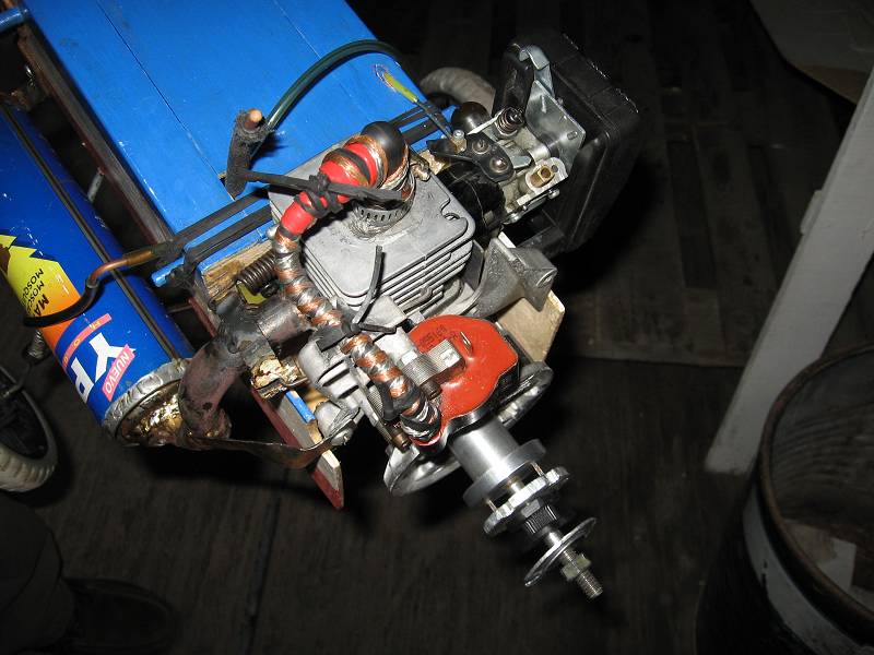

Hey, I just picked up a weedeater featherlite 25cc engine the other day, and decided to do some testing. I did couple mods right off the hop, like putting a thinner gasket on the backplate, making the exhaust port bigger. (the port is an eliptical shape, so i used my dremel to make it the same size. I also took about .010 off the top of the port to increase the timing. I didnt check with a degree wheel so im not sure what the port timing is. I drilled a 1/2" hole in the muffler, and used a bigger carb (walbro WA19A)
So far its not as bad as i thought. It spins a jxf 16-8 prop at 7200 rpm and idles a bit high at 2600 rpm.
Im running it on avgas mixed 32-1.
here is the video of the first run. I didnt have time to edit it, but is not bad.
http://www.youtube.com/watch?v=Yu7YgABmKXk

Sorry i didnt get video. I forgot to charge my camera. The test went ok, but i need to improve the performance of this engine. The 14-8 only put out a mere 7.5 lbs @ 8300rpm, and the 16-8 did just under 10lbs @ 7200rpm. I was thinking about this engine after, and was wondering at what rpm the rev limiter kicks in? it doesnt surge or piss around at 8300. When the limiter is hit, does it just stay at a steady rpm? or is it kinda like a car? I honestly think that if it will turn a 16-8@7200 it should spin that little 14-8 a little more than that. I ordered a 16-6 today, to see what it will do. I get my props at a very good price, so i would rather try everything before tearing down the engine again.

As per the timing issue, I removed the gasket completely and checked again. Now the exhaust is at 180. Just for the hell of it, i decided to check what the timing was on my Stihl 24.5cc. For the little amount that i have run it, it seems like a strong engine (the heavier alternative to the poulan) and the timing on it is very similar +/- 5 degrees. Im going to clean up the port so it looks a little nicer, and so its nice and straight across the top and bottom. Im also going to get a smaller bit and try and square up the corners of the port a bit to give it more surface area. The piston also travels just a bit past the bottom of the port when its at BDC, so im going to remove that as well. Then if i have time today, I will try and test run it again. My new prop should also be here tomorrow, and i have charged the camera up, so I will try and get a video as promised.
