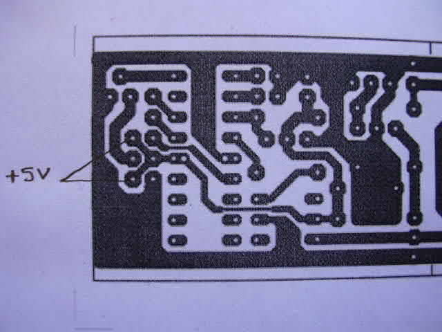

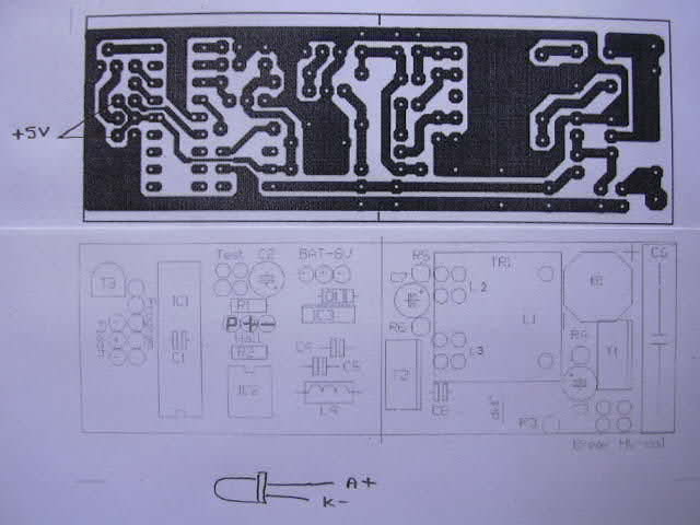

I will dedicate this post to the cdi here: http://www.modelbouw.gompy.net/newcdi/newcdi.htm
With all respect to the designer I feel it necessary to outline some errors I found with this project.
I have built and tested this cdi. Built as outlined it "will not work".
I downloaded all related info for this maybe 8 weeks ago, since then at least one change has been made.
The two biggest errors are the wiring connection for both the sensor and led strobe as shown on the component layout. With these wired as per the diagrams I received the cdi will not work in any mode, test or normal.
Pictures below show sensor connections that have been corrected by designer in last month or so.
+ to -
P to +
- to P
LEDs are polarised and must be orientated correctly. Have a look at both the pcb and component layout. Component layout shows to wire led incorrectly. It puts the kathode or - on the positive 5 volt rail.
Corrections to parts list to follow.

I think you will find the system used a 16F628A pic chip and it never really ever worked successfully.
It was a good idea basically and the supporting software to upgrade the curve worked nicely.
Connect all but the power section and all worked beautifully.
Connect the power section and a spark plug and down it would go.
Many tried and contributed a lot but there was a basic flaw somewhere in the software(as far as anyone could make out) for which the source was never released.
Apparently written by a third party somewhere (anon).
Problem most had was the chip would lock up, sometimes the program would become unusable and one had to re-program while at other times the chip would never recover.
John's little 12F683 system came along and worked great so the former was abandoned.

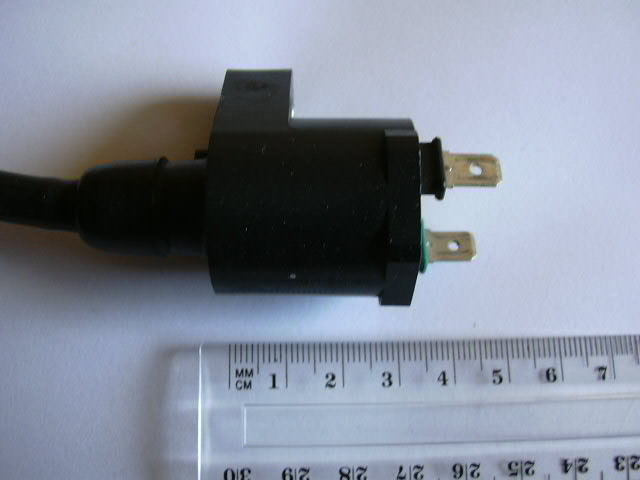

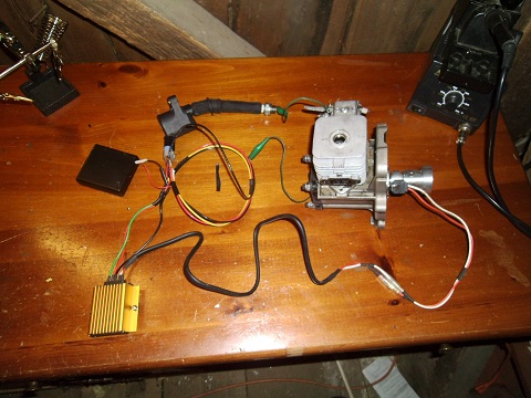

Here is my take on the diy cd ignition setup using some cots parts and a 25cc homie.
I'm using a RPT C-500 coil and a VW electronic ignition conversion module with magnetic coil pickup.
Crank magnet is pressed into the original flywheel after cutting it down to minimum diameter.
I still need to get a short plug wire and remove the original C-500 rubber boot.
Works well with 4 -AA batteries.
Correction: 4 AA alkaline batteries work for a little while, switched over to 3S Li-Po, works better Found better unit at work update more later.
