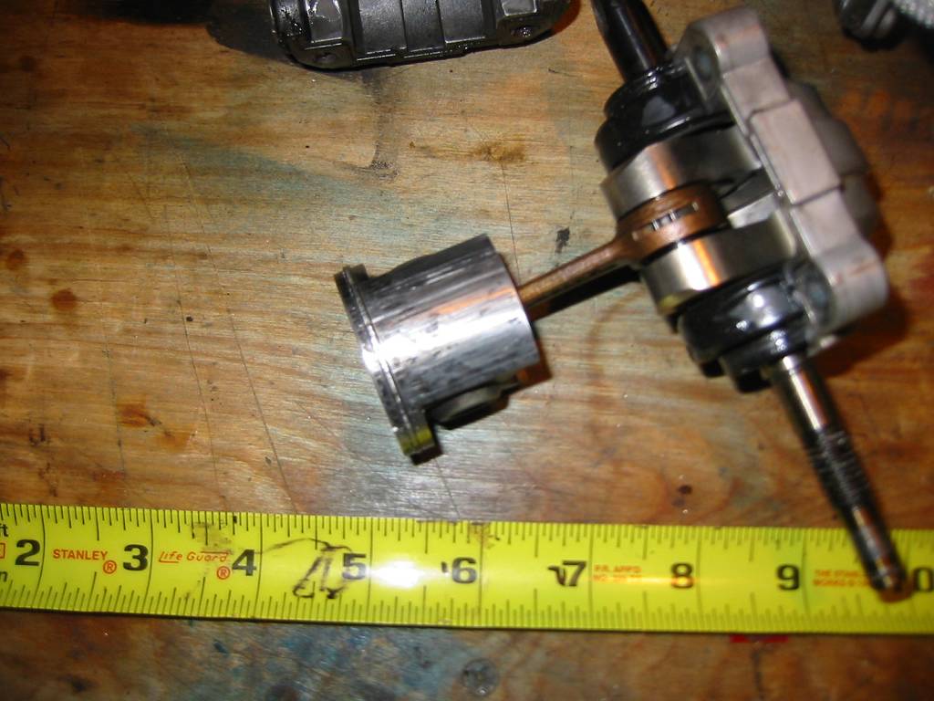

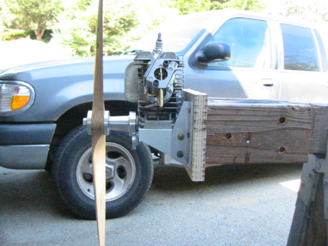

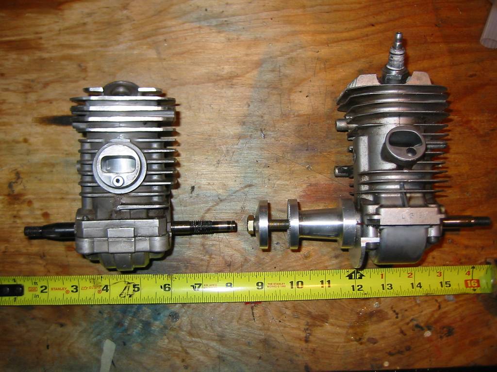

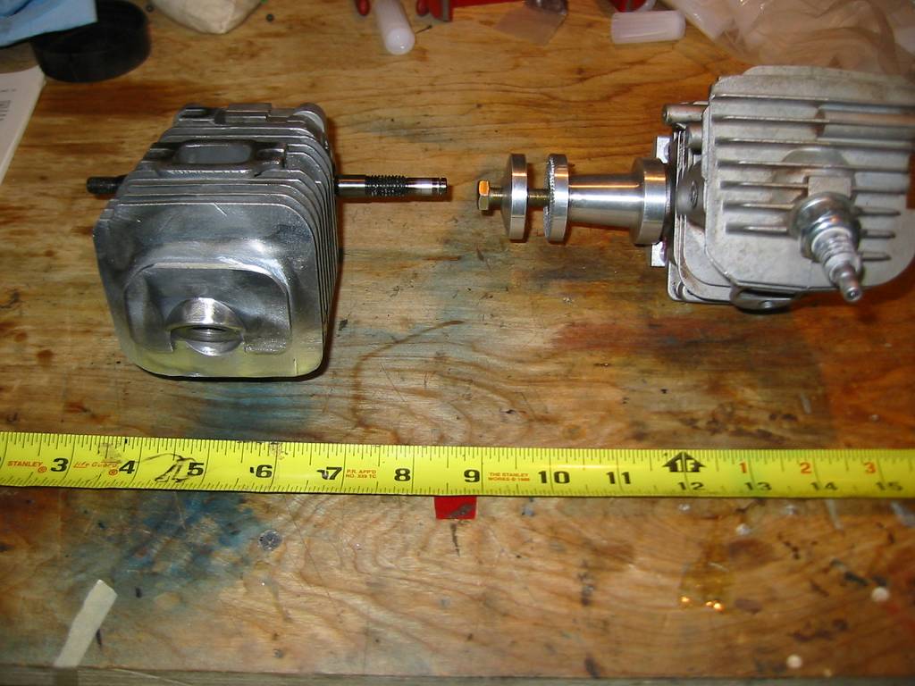

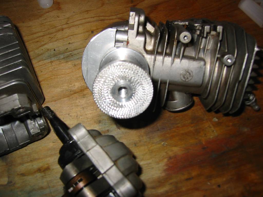

Some pics were asked for, here you go. On the left is the 42cc homelite. I pared down the extra bits for fun. Check out how trashed the piston is. Yikes! Never leave straight gas in the same area as illeterate laborers.
On the right is an EFCO 39cc. That one looks like a winner. It is ready for a beam mount, no mods. I only removed a little bit of extranious cooling fins. It has two rings and huge compression with very slow leak down. The inside is as pretty as new shiny penny. The hub came out straight first time, with in 0.002" wobble a the prop end, good enough for me!. Nottice the knurling? I did that with a regular old knurling tool. I set up the cross feed at 4 TPI and ran the edge of one wheel of the the knurling tool out from the center in back gear. One pass and done! I had been broaching radial grooves with the taper cross feed manually, a huge pain. This was about 10 second in back gear to do an equivelent job. The prop was about 1/8" of kilter a the tips. I fixed that with a file. Here is a tip, my new favorite cutting lube for aluminum is a shot of castor oil in mineral spirits. It makes the cuts really clean an smooth.

Nice work Scota. Good tip on the knurling.

Huh, I'll kepp the soft mout idea in mind. Before I read that I made the carb manifold and split ring. The intake maniforld is bolted to the split ring. The split ring is afew thousands lower than the flat face of the boss on the jug. That permits a good seal. I guess the good news is that by using the split ring I did not mess up the jug. I could go ahead and use the rubber boot if it looks like and advantage.
Here is a tip for making two holes meet in the middle, like for the pulse pressure tap the carb uses. Look at the thing real carefully and make use the planned route does not come out the side. Start each side of the hole in the normal way. Put a slightly smaller bit in the drill press vice and secure it such that the bit in the chuck line up with it. Drill the hole a little alternatly from both sides using the bit shank in the drill table vice to align the work. They will meet up in the middle.

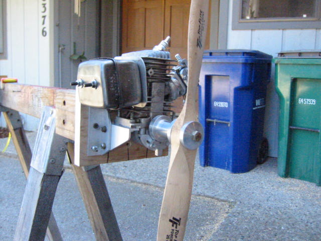

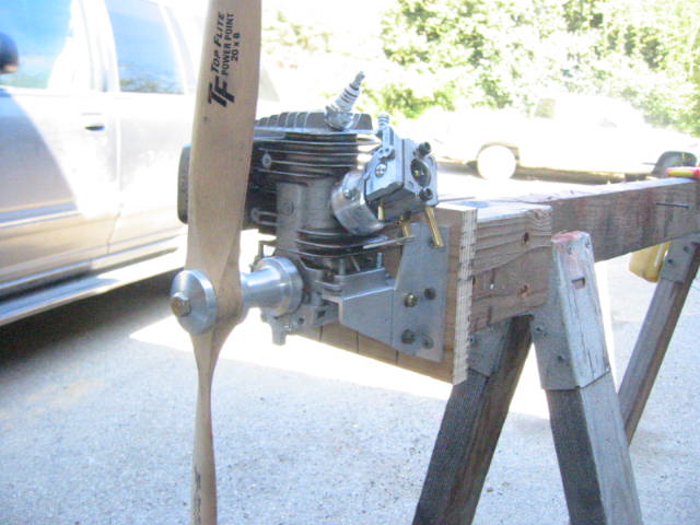

Progress is made on the EFCO. The ignition arrives next week.

It runs! props, 20 x 8 6400, 18 x 8 7200rpm, 15 x 6 9200, it idles down to 1600. I have not messed with the timeng yet, it is 28 deg BTDC. The muffler is too heavy for real use. It is odd, to me that I pick up 100 rpm with the guts installed. The hub turned out nice and straight, it runs real smooth.
I had a thought for locating the magnent on the hub. Next time I will tape it in place to get the location before I drill the hole. Then I will fuss with it until the sensor is located in the middle of the ajustment range at 28 DBTDC. Once I know the exact location I will then mark it and drill.
Later that day.....
I set the plug to 0.020" gap and installed a Menz 21 x 8. The wider plug gap made it run a little smoother. I also packed the muffler full of chor boy scrub pad to keep the neighbores happy. 6100 and got the idle down to 1300. It is fun to watch it run so slow.
