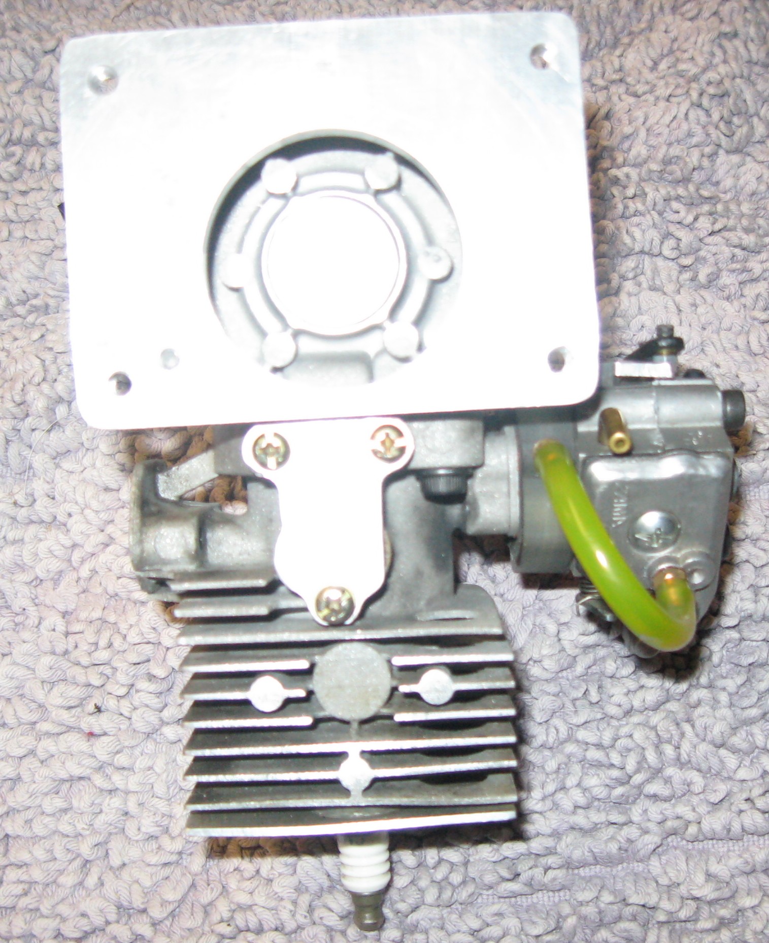

Do you have the side ports blocked off?

Ralphbf's Avatar
My Feedback: (27)
Joined: Mar 2004
Posts: 1,450
From: Woodland, CA
Default RE: toro 25cc problems
This is the 2 barrel version.
With everything cut off and glass bead blasted.
The nipples where the hoses go have been blocked off with the plates.
I had this on a 60 size Tiger Moth so I had to loose the flywheel and go with EI.
The gas line you see goes from the manifold to the pump diaphram, in lew of the hole in the manifold and the Carb.
I rotated the Carb. so the throttle linkage would line up.
It looks a little different now. I bent the crank and sent it to www.rcignitions.com to have it straightened.
Ralph C. cut the back shaft off, put on a new prop hub and sensor and timed it for me, plus made a new manifold for the Carb.
