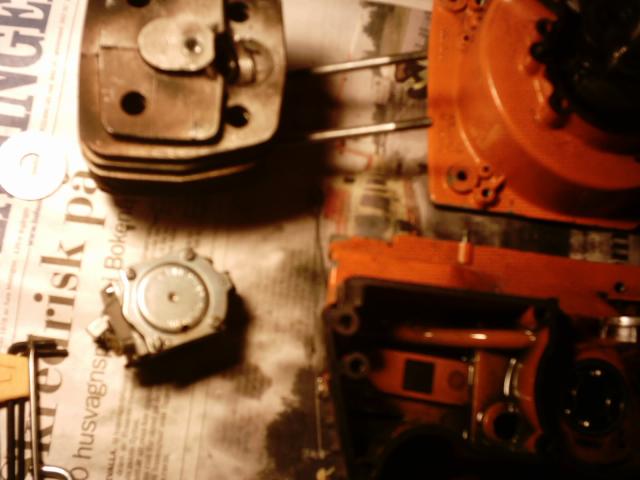

Old 07-03-2003 | 01:01 PM
jacs's Avatar
Posts: 394
From: Uddevalla, SWEDEN
Default Husqvarna engine
One pic of the engine, the crankcase is 60mm in diameter

Old 07-03-2003 | 01:02 PM
jacs's Avatar
Posts: 394
The weight of cylinderhead and carburator is 625gr. Must take away a lot on cylinderhead.

Old 07-03-2003 | 01:47 PM
jacs's Avatar
Posts: 394
Oops I weighted to hole lot now and it's up to 2150gr and that's before i have put my dremel on it (He, he, he)

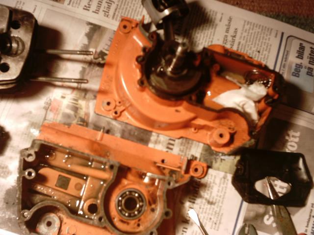

Old 07-04-2003 | 02:48 PM
jacs's Avatar
Posts: 394
He, He, He
The total weight now is 1625gr after some modifications on the crankcase. Need help on how to remove a stuck ball bearing on the crankshaft?
Old 07-04-2003 | 06:44 PM
Antique's Avatar
Posts: 9,825
From: Somewhere, DC
If it's good leave it on, otherwise it takes a puller..It will be tight only the width of the bearing, the crank is very slightly smaller the rest of the way...
Old 07-04-2003 | 08:24 PM
jacs's Avatar
Posts: 394
I coulden't wait for an answer so I just mountet the crankcase together with the gasket and started to tighen the screws one by one in crossorder. No problem so far just need to call my old workpals so they can start the lathe on the flywheel.
On this flywheel I have one question or more on the shape of it. I'm thinking of make it about 30-40 mm in diameter and bolt it with the M8 nut that came along. Drill and thread 4 pcs M5 and 2 positionholes and insert 2 cylindrical pins for guidence. Have another part made in the lathe for mounting the propeller in with the correct fitt to the flywheel.
