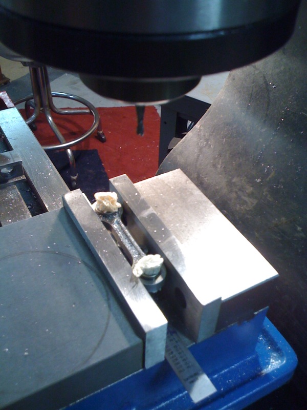

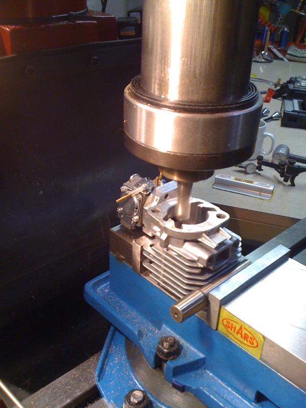

I have made two PHENOLIC LINEN carb twisters on Featherlite gas coversion engines. The insulative properties raises the intake air density, making the carb work much better and increasing power. I think it also prevents vapor lock, as my experience showed restarting the engine with an aluminum block was almost impossible. Here's some pics, one of them shows the phenolic block. Machining fine details in the material, such as the vacuum pulse port channel was easy. Also, tapping the material was straightforward and the threads were sufficiently strong to withstand reasonable torque for mounting the carb.
The other pictures show engine mods I did to raise the compression ratio and to lighten the con rod. Net increase from baseline was 150 RPM. This engine is now running sucessfully on a Seagull Models 120 sized Decathlon with PLENTY of power. The featherlite motor is a 25cc. Did any of you know that the effective displacement of a two-stroke gasser is not really 25cc? It's more like 20cc because the exhaust port is open for part of the piston upstroke. Real compression doesn't really start until that port is closed off.
