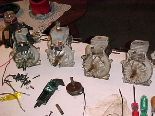

Here are four of the engines I've torn out of the shell so far. The one on the left is one of the electric start models. All of them need some work but I've got nothing but time to piddle around with them.

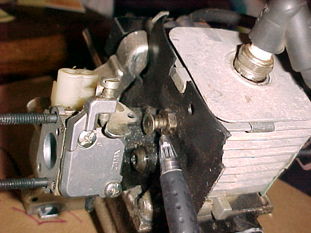

Here is a picture of the CR. I was wrong, it is operated by the throttle, Hmmmmmm! Would make going to full throttle somewhat of a problem.

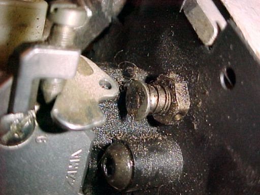

This one is even closer.

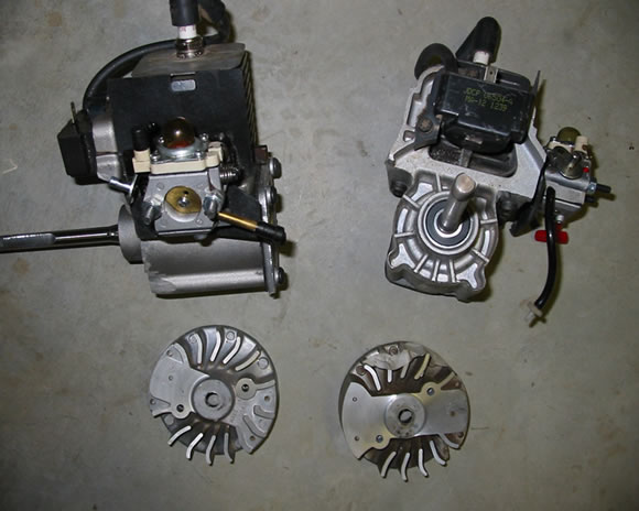

well... just from looking at those 4 engines you posted, they look like plain ol 25cc homelites. Never seen a CR on them before though. Here is a shot of some I did once. You can cut most of that aluminum off of the crank.

Agree with the 25cc. Have one on a new to me blower and it is mark 25cc and a family grp #.
What was attached to this CP on the outside? How do you figure it is activated?
The blower appears to have a hose attached in that area, figured it was just an emissions requirement on newer models.
Old 07-11-2003 | 11:03 PM
Joined: Feb 2003
Posts: 1,126
From: Humble, TX
Default Compression Release
The only thing attached on the outside is a small cap like head. It is actuated by the throttle going to full position. During Start, the throttle is held and the start button is pushed. This allows the engine to spin up enough to fire and when the start button is released I guess the person driving the weed eater lets off the throttle ???????????
I do know it it operated by the throttle. If you look at the first picture you can see that when the throttle rotates it contacts the CR.

? Once it starts compression may provide enough resistance to close valve and then valve may act as a full throttle stop to prevent butterfly lever from travelling past a full open position??

Just converted one that was of recent vintage. On mine there was a compression release HOLE above the exhaust port. In a prior posting on conversions someone recomended sealing that hole to increase power.
Looks like on your motor this was handled automatically with the release.

I was thinking along the lines of using it and being able to start the motor with a regular electric starter. Once it's running cylinder pressure will keep it closed.

Tower catalog show a Fuji twin 86 with CR on both cylinders. I'd keep it until it gives a problem.
Does the moveable part have any type of rotation lock? Might be fun trying to hold it open while running an electric starter!
Old 07-13-2003 | 04:59 PM
Joined: Feb 2003
Posts: 1,126
From: Humble, TX
Default CR
There is no kind of lock on the mechanism at all. It is strictly operated by the throttle position. At full throttle it is engaged and is released when throttle is reduced any amount off full.

As another check, look down the throat of the carb and see if the butterfly is going past centre when the decompressor is on.
