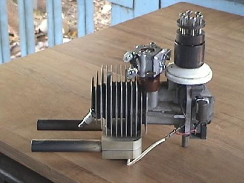

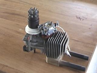

Ok, guys I need your help. I'm trying to find out what this engine is or what it used to be. I did some math on the bore and stroke and came up with 43.3cc each time I did the calculations.
On the back of the case above the exhaust port the numbers are
68501
4
IMP.
I've ran it useing its points and a 6V coil and got about 7K with a 18-10Z. As you see it, 3.8lbs.
3 things throw me, left-hand threads on the flywheel side(same way the engine spins) carb location and because of the carb location where did the stock flywheel mount?!
Ive had it apart, looks real good inside. Runs strong, sounds like a saw.
I'm just trying to deside if its worth messin' with.
ANY help at all would be appreciated.

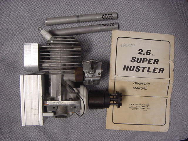

Dave, You are correct in your calculations. The engine you have is a 44cc. I have one of these that has been converted over to glow power, but have never attempted to run it. From what Info I have gathered on this engine it is an E.W.H. 2.6 "Super-Hustler" engine powered by Homelite. It was produced by E.W.H. Specialties, Inc out of Arlington, Texas. I don't know who sold these engines, or if they are available. I do not believe that they are produced any longer, although I have seen a few for sale on Ebay from time to time. I have included a photo of the engine that I found on the net.
I hope this info helps,

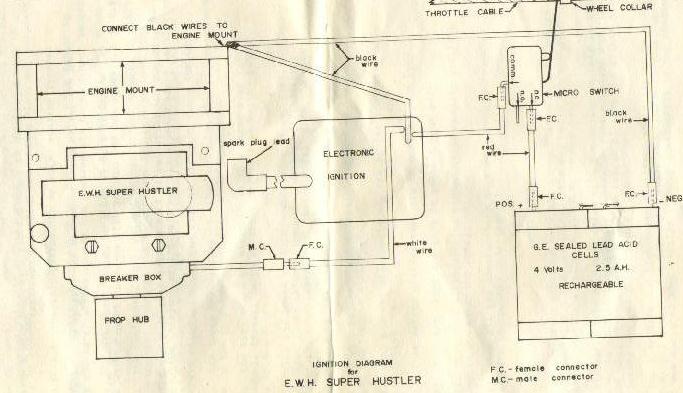

Here is another pic showing the Ignition system schematic as shown in the manual.

RIGHT ON! Wildflyr!
Man, thanks alot thats more info than I thought I'd ever get!
Well I guess I'll need to look in to a CH ign. for it now.

You will need to shield the carb opening from the blast of air from the prop...Only other engine I know of with that setup is a Aerrow 200 twin..It has a shield that looks like an aluminum can, about 1.5 inches around and 1/2 inch deep,solid on the front with holes all around the side...direct air blast into the carb won't work....

I ran it on the test stand with an 18-10, ran great.
I guess the velocity off the prop is not near the speed of the on-comeing air. What about inside a cowl?

Its got points, does anyone make small coils that will work with that setup or is it best to rip em out and go with the CH type setup?

It was a chainsaw, probably Homelite, about 20 or so years ago..They don't make 'em any more.The points would probably work if you could find the original ignition setup, but a call to C&H to check on a conversion would be a good idea....Less hassle, and give TK something to do.

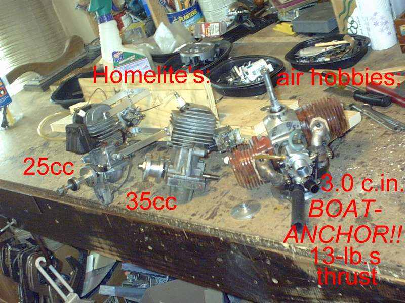

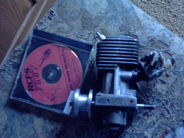

I found what appears to be the same engine (in the trash!) has same #68501 above exhaust port, I raised the piston to just close the exhaust port, removed the spark plug and filled the cyl. with oil, from a calibrated syringe, until it started out the spark plug hole,and ended up with 35cc's.
I reversed the crankshaft so the carb is at the back (makes throttle link a breeze and eliminates anti-siphoning)
Stole prop adapter and ch ign. from air hobbies eng. I got from an auction ($150.00)(BOAT ANCHOR!!! good ign.)
here's some pics:
