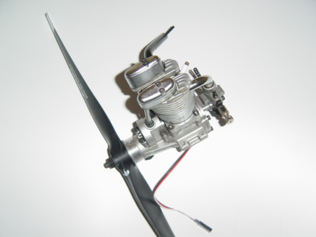

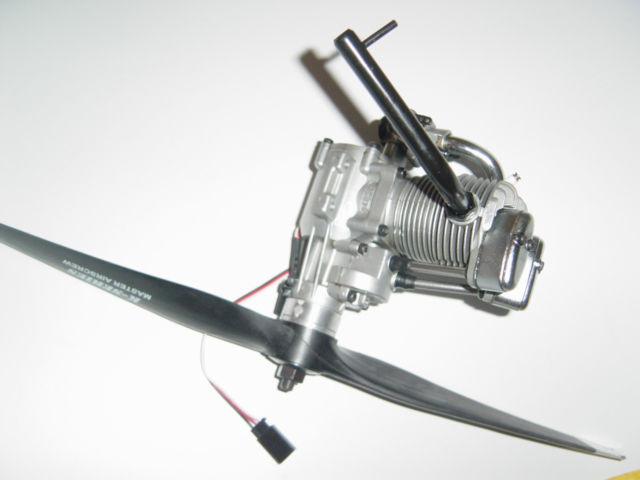

I did convert 3 engine to gas
O.S FT-300
SAITO 90TS
SAITO FA-80
SOON WILL CONVERT O.S FT-160 to gas

Old 03-14-2010 | 12:01 PM
speedygonzales's Avatar
Joined: May 2004
Posts: 667
From: ontario, ON, CANADA
Default RE: saito 80 conversion to gas
that looks like my saito well it is.
you have any pics of the mounting of the magnet and sensor?
I need to give the engine a good cleaning.
questions.
- the piston top pin, what is it made out of? looks like some plastic?
- the cylinder appears to have the finish worn, is their anything that I could do to fix this.
has anyone ever tried to sleeve a engine? with cast iron?
