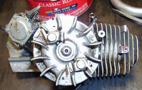

Someone gave me this older homey and the carb is on the bottom. Can this be converted into a useable engine?

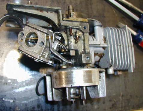

Default another pic
another pic

you got a very easy convert. shave the fly wheel lop off as much metal as possible where ever possible. mount holes on side of case make it real easy to make a motor mount

Does anyone know what CC it is? Or what do I measure to determin what CC it is. What should the end weight be? Should I take the flywheel to a machine shop or should I just take a die grinder to it...

It looks like one of the old XL150's from the 70's to me? They were around 2.4 c.i. I think? They were a 16" saw with 3/8" chain. They didn't have a isolated handle and would have your hands tingling in no time. I had a couple and other than my hands bothering me, I never had any trouble with them.

What size prop should I use? Can I get a Prop hub for it or should I get one made at a machine shop? and last of all, if I need to rebuild it can I still get parts for it?

Most of the flywheel ends are 5/16" - 24. Carr Precision makes hubs. If it's different, they can make one to fit.
A 18-10 should be about the right prop?
You shouldn't need any part except the ring maybe? You can get one from Frank Bowman. If you need other parts, you might find junk ones at a chain saw shop? New parts except for the ring, are not generally very cost effective for these things. It's cheaper to get one that does need any parts.
From looking at the picture, the carb doen't have a HS needle valve? There appears to be a seal in its place? If this is so, on these old engines, you can dig the seal out and there's a recessed screw underneath. You will have to have needle valves on a model engine because of the air flowing past the carb.

Measure (in centimeters) diameter of the piston and the stroke from TDC to BDC.
Then find the area of the top (I'm assuming its flat) of the piston.
Diameter/2=Radius
PIE(3.14) * radius squared=Area top of piston
Area of piston * stroke=displacement
If all calc. are in centimeters then you should get cubic centimeters (cc).

This Homey also has a rear shaft about 3" long. Can I just lop it off close to the case or should I leave it on there???

Here's a shot of mine. It came out of an XL-10 chainsaw, 30cc or 1.8 cubes. I've got the prop hub on another motor right now, but it weighs 3lbs 8oz as in the picture. Big ol' Walbro HDC carb (this was made before the tree huggers made the mfgs. start worrying about air polution) Needle bearings on the crank and no thrust washer (my crank moves forward and aft about a quarter inch while the motor is running) The best I can remember, it was turning a Zinger 18x8 around 6500. I might make another adapter this weekend and try it on the test stand again. If you do decide to convert yours, make sure that you remove all the steel parts from the lower crankcase half before doing any grinding on it. It's made of magnesium and will get a fire going in a hurry if you make any sparks (Yep, caught the bench grinder on fire 3 different times)

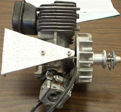

I'm converting a homey that is almost identical. Here's a photo of mine. One difference, mine has a high speed needle. I turned down the fins on the flywheel and made a hub and washer. I have made some mounts, and added a bell crank for the throttle linkage. Starting this beast is tough. I could not flip start it, but was able to fashion a rope starter using the hub to make sure it ran. I'm making a pulley to fit on the rear shaft for rope starting in the future. My application is a giant ugly stick, so access to the rear of the engine is not a problem.

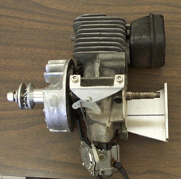

2nd Pic

Looks great Gary... Let me know how the pull start works out as I have been pondering that one for a wile...
