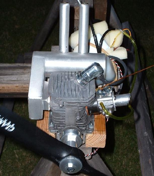

FWIW, here's my latest Poulan 46cc. I've gone through a couple of different setups, and here's one that I think will work great. Terry at CH Ignitions did the conversion work on this one. I also had him special order a couple of these BCM wrap-around style Pitts mufflers. It took Bisson a while to make these two prototypes, but I'm really happy with them. They will be $99 each now for those that might be interested in getting one.
I barely had time to run it briefly on the bench today before the sun went down. 90F, 95% RH, 30.02" Hg, at ~sea level, the 46cc turned the MA Classic 20x10 a steady 7000RPM on some old stale 25:1 gasoline. This engine is practically brand new and so should yield better performance as it starts to break in some.

That conversion looks perfect for my Byron eagle. How much would you say you have invested in that setup? Did you opt for the synchrospark ignition? Looks marvy! Please post if anything significant happens (like a performance increase after break-in). I am going to order a Poulan 46 'power head' from Lawnstation for $114.99 shipped. Hopefully it will be in good shape. I may have more questions later! In fact, could you send all the details on your conversion in an e-mail to me? Thanks in advance!

I'm glad you'all like the setup. I think the Bisson wrap-around muffler really makes this engine package. Mine has the SynchroSpark, which I think it's a must for this engine.
Unfortunately, with the move to our new house nearing, I haven't have much time even to go fly on Sundays, much less run my engines. Rest assured though, when I get around to it, I will post the results here first thing. Who knows, BB1 might just beat me to it.
I'm embarrassed to tell you exactly how much I have invested into this one - it's obscene.
Let's just say that I probably could have bought a BME50 or ZDZ50 instead. Then again, now that I have persuaded BCM to do the Poulan, we can easily put together a very nice package that rival the best in the 45-50cc category for:
Poulan 46cc: $110
CH conv kit: $210
BCM muffler: $100
Total: $420
Less if you can find the short block cheaper. Best thing, of course, is if you ever dork one into the ground, replacement engine is only a hundred buck away.
Just so you know, last month's RCM had a review of the ZDZ50. With a very similar BCM muffler, it reportedly weighed 59 Oz. That's almost exactly what my Poulan 46cc weighed, which is even before I make any attempt to lighten the engine some more. Easily done considering the generous cooling fins that are not all necessary for RC application. Plus the ZDZ50 only turned a Zinger 20x10 about 200rpm more than the Poulan. Both engines are practically brand new, so it remains to be seen how much power each will gain after break-in.
Again, I've got to give the credit of this conversion to Terry at CH, though. He did all the work on this one, and a superb job. I just kept pestering him to pester Bisson to make the muffler for me.

Where did you get that wrap around muffler for the poulan 46? I checked the Bisson web site and none is listed, e-mailed them a couple of times and got no response. Sure would like one.
My Feedback: (23)
Posts: 3,227
From: Houston, TX
The wrap-around BCM mufflers were special order items. The two I got were the very first two prototypes. Bisson does have the patterns now and can make them to order fairly quckly. I would imagine they will update their website to show availability sooner or later.

Got my muffler today......
Whew.....What a work of art.....
Tickled to death...
