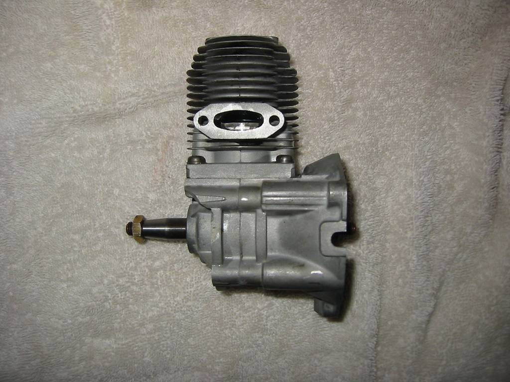

I notticed the LH thread, PTO side too. I had three ideas. First, cut it off and rethread: the shaft is pretty long. Second, make a left and thread tap: that is a pain. Finally, an ungainly hub that used the LH nut and a second piece that bolts over the whole works with several cap screws. I will be ditching the Flywheel.
Hey, that jug has so many fins that it looks like an angry porkypine. Anything wrong with removing the fins below the intake and exhaust holes? Make it more like a DLE-30. How about removing all or most of the belts of aluminum around the case? I think I could pare it down a bit more.

the way I've got around the LH threads on the crank was like Av8tor will mention... cut off the threads then drill and tap the crank and install a stud with the threads of your choice. did that on an old pioneer chainsaw I have that had LH threads on both ends of the crankshaft, I still need to finish that thing and get it running.

Well, here is how we did it on my brother's....
I just took a thick, large diameter flat washer, and chamfered it to match the chamfered part of the pto shaft. Then we just bolted the propellor right to the shaft without an adapter hub, and then used Loctite and two nuts "jammed" together to hold the prop on. Works fine and is very light. The prop ends up a bit close to the engine, but it is no problem.
The shaft on this engine is a bit too small to do the "bore, tap, and stud" method we used on the Echos...
AV8TOR

It got done. Came out 2#4-oz. I need to wait for the various sealers and adhesives to dry before I run it. The other engine is a BME-50 knock off I did for size comparison.
If if runs good I will make a new intake manifold. That one is too long. It is also made of bakalite. Do not cut bakalite on you bandsaw, it will ruin the blade. What makes it worse is the blade is a weird length so I have to shorten a longer blade. Bakalite cuts like a piece of rock and smells funny. You'll know after you do it once.
I did remove the belts of aluminum on the case. I don't know if it really saved any weight but it does look nicer.
