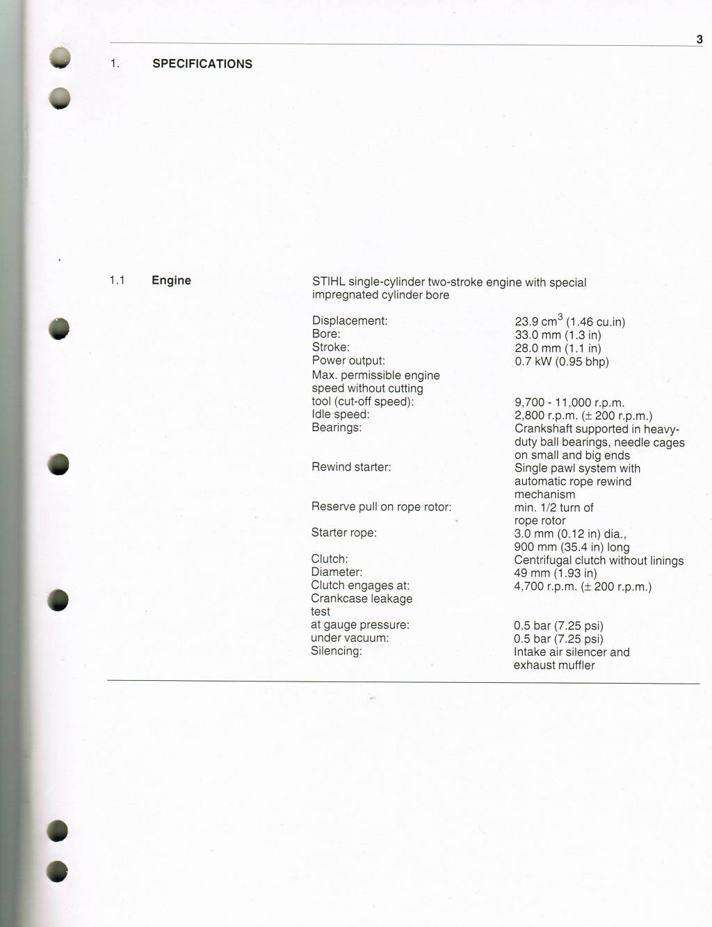

I picked up a Stihl FS74 trimmer today that is a prime candidate for conversion. The cutting head is trash and the shaft looks like it's been run over. Feels like it has good compression.
Does anyone know what the displacement may be. The only info I could find was for a FS75 and it said it was a 25.4cc

Does it look like mine in the beginning post? If it came from an FS-75, it is a 25.4cc. I haven't been able to finish mine and run it, but I am positive it is going to be a good "runner". Nice size ports and port timings.
Here is a copy of the owners manual for the FS-75: http://www.stihlusa.com/stihl_owners...S75_Manual.pdf
In the future, to get displacement, just measure the bore and stroke. Then use this forumula: (bore x bore) x stroke x .7854 = cubic inch displacement (If you measured in inches.) Then just divide that result by .061 to get cc's.

Well, I just spent a half hour searching, and can't come up with info on the FS-74 either. Stihl makes really good, high quality equipment, but they don't want anyone but the licensed dealers having access to the technical data, which is a huge pain in the *****!!

I have tech info on the Fs75 but not on the Fs74. I'll see what I can find at work tomorrow.

Here's the specs on the FS74
Jim

Well, It appears that the engine in the FS74 trimmer is a 23.9cc. It would probably be ok for something like a H9 Ultra Stik but not something in the 80" range as I had hoped. I don't have a Ultra Stik though.

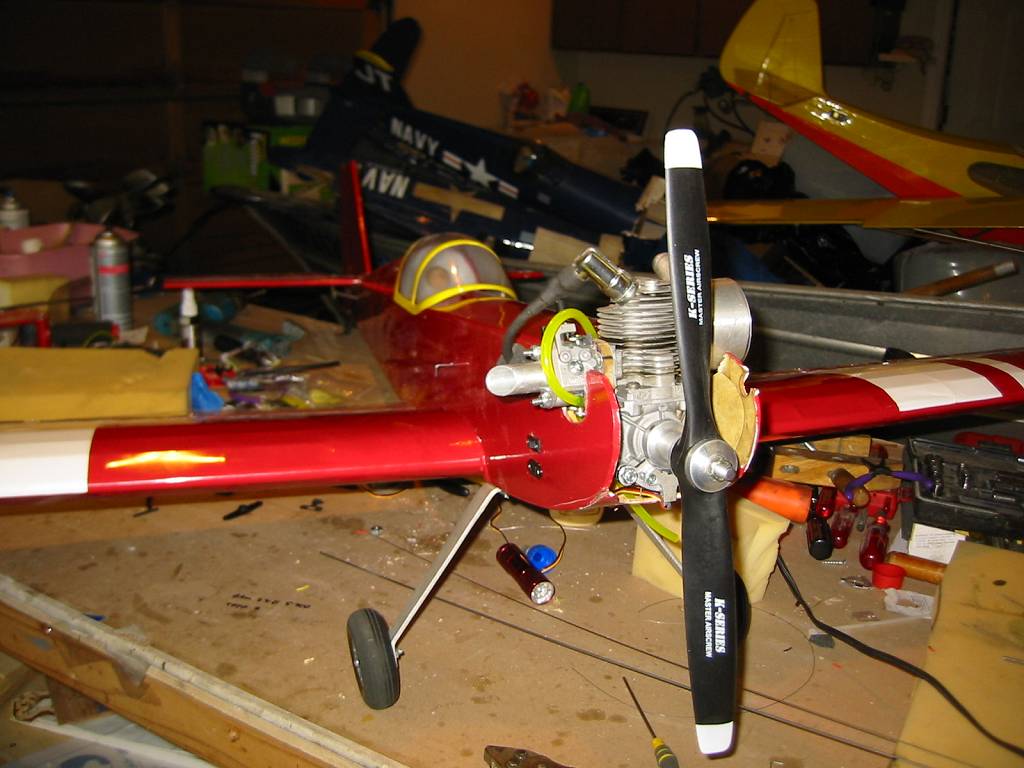

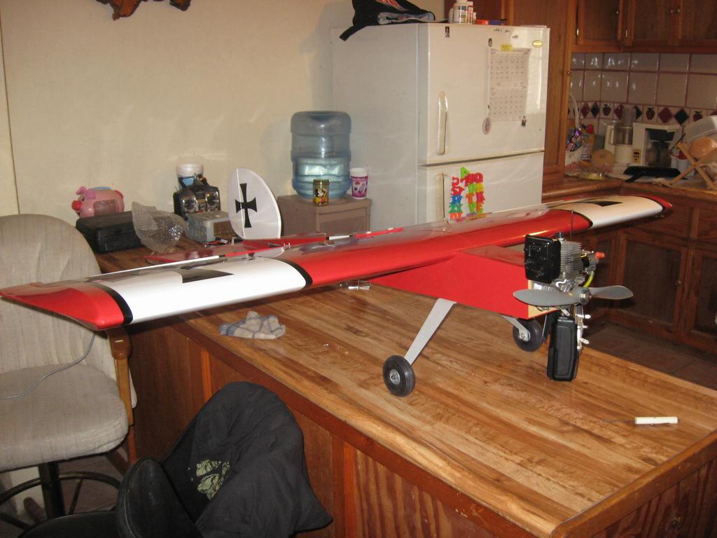

I put a little Stihl 20cc on my brother's Big Stik and it flew great. (We set it up on Gas/Glow) I think it would look a little better with the engine inverted, but he wanted it upright.
I think the 24cc would fly something like an 80" Giant Stik. It wouldn't have a big excess of power, but it should fly ok. The whole "power option" had soared upwards on models nowadays. What we considered sufficient 20 years ago would be considered way underpowered today. But it sure is fun to have all that power!!
