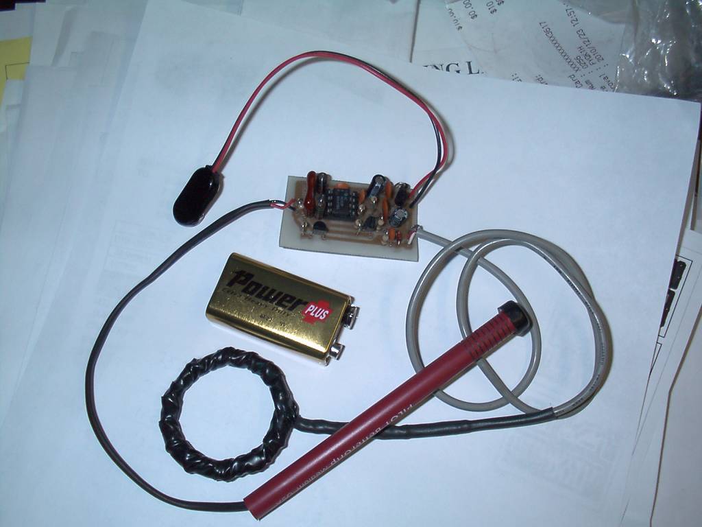

A $5 LED stroboscope
Old 07-17-2010 | 03:47 PM
Gompy's Avatar
Joined: Jul 2010
Posts: 404
From: Alkmaar, NETHERLANDS
Default A $5 LED stroboscope
If we building CDI's and TCI's, we need also a good strobe to see wat we are doing.
http://www.electronics.gompy.net/strobe/
The designe it's mine, I only redesigne the pcb and use normal components.

Is this sensitive enough to pick up the spark through a shielded spark lead like used in most model spark ignitions?
Old 07-18-2010 | 08:44 AM
Gompy's Avatar
Joined: Jul 2010
Posts: 404
Default RE: A $5 LED stroboscope
ORIGINAL: gkamysz
yes, it pickup even the spark of a electric lighter.

Old 08-19-2010 | 03:36 AM
Joined: Mar 2009
Posts: 293
From: xnot applicable, AUSTRALIA
made up one of your strobe units and it works fine...thanks

Old 08-20-2010 | 03:06 AM
Joined: Mar 2009
Posts: 293
OK...thanks for that. I will give it a try.
Yes, made my own pc board but do not get enough free time to make extras sorry.

Will this work even if the spark plug wire has a wire braided shield??
AV8TOR
Old 08-20-2010 | 05:30 AM
Gompy's Avatar
Joined: Jul 2010
Posts: 404
Yes, maybe it's even to sensitive.
Changes R3 into 1k and R4 to 15M.
Don't use a coil but a simple crocodilclamp.
