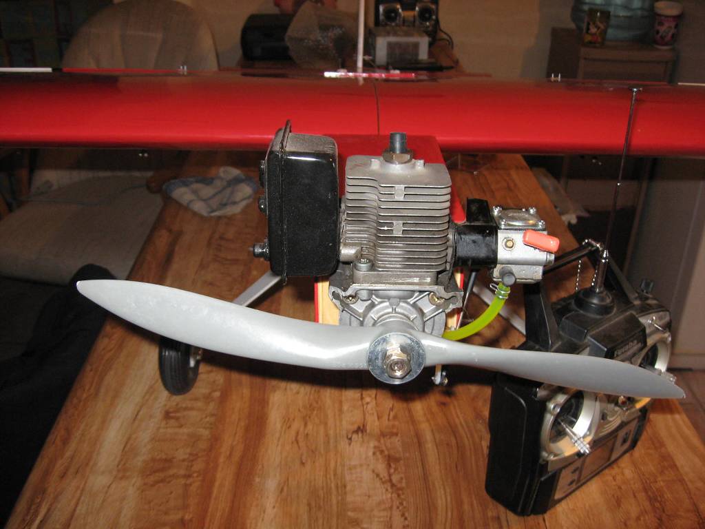

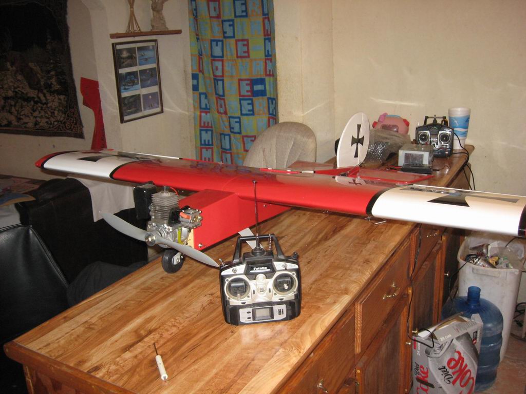

Some time ago, I converted a Stihl 19.8cc engine for my brother. I believe it came out of a Stihl FS-65 trimmer. We used Gas/Glow. I was impressed with the engine. Light weight, and nice size ports. It ran very well. Finally, my brother came to visit recently, and we got a chance to fly the engine. He put it on a Great Planes Big Stik. With the servos mounted in the tail, the airplane balanced perfectly. We used a 14 x 8 prop, mounted directly to the crankshaft with a large flat washer behind it. There is a chamfer on the crankshaft, and I used a thick washer that I machined the i.d. to a taper to match the chamfer on the crank. The crank threads are left hand, but I figured it might be alright with two nuts jam locking each other, and Loctite. That worked fine on the test stand, for numerous starts and a good bit of running time.
However, when we went to fly it, while checking the tightness of the nuts for the prop, I got overzealous and tightened the jam nut so tight the end of the crank broke off. My brother was anxious to try it anyway, so I Loctited the one nut, and put thick CA on the end of the shaft to stop the nut from coming all the way off, (and the prop), should the prop loosen.
It did come loose a couple of times while we were test running it on the plane, but then I think the prop quit compressing and finally it stayed tight. I don't recommend this idea whatsoever, as the prop certainly can come off and hurt you! But my brother really wanted to test fly the airplane while he was here to visit me, so we did it. I figured I would design a way around the left hand threads later. The crankshaft is small diameter and VERY hard, so options are limited.
Anyway, the test flights went great!! It is a sweet little engine, and perfect for the Big Stick. The airplane took off in about 20 feet without me even pushing it, and flew great at half throttle. It would even do aerobatics with half throttle, and full throttle was a blast. Really a neat little engine, and an excellent combo with the Big Stik.
I sat down and designed a prop hub I thought would work, but then I had the idea, "Why not use a pusher prop and run the engine backwards?" So, that's what I told my brother, and he has some pusher props on order. That should nicely solve the left hand thread problem. There is a pretty good supply of pusher props in the 14 x 8 size from various manufacturers.
I'll let you know when he gets around to flying it again. Here's some pics. I think it would have looked better if he had mounted the engine inverted, but it sure flies great....

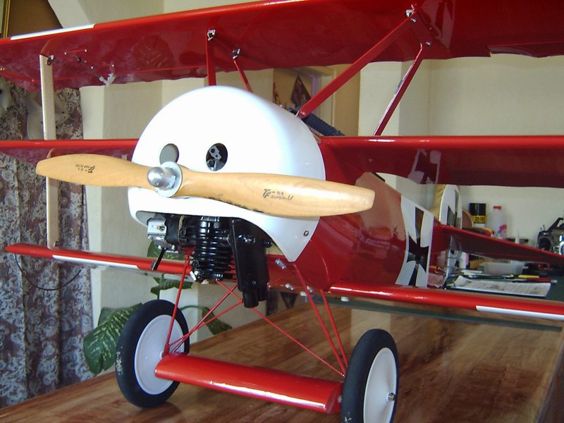

Hello AV8TOR... What size of pusher prop would I need on my LH 23cc Echo? Sounds like a good Idea...pusher prop for left handed crank threads. Take Care, Capt,n
A 15 x 8 to a 17 x 8 or 18 x 6 depending on it's state of tune Captain. I have one Echo 23.6cc that is stock except for running Gas/Glow, free breathing muffler, and an 11 mm carb. I run an old wide blade Top Flite 18 x 6 on that one. It turns that prop at 7500 and hauls the big Great Planes Fokker Triplane around really nice.
Then I have a fully hopped up Echo 23.6 on a 72" span Katana. I run an APC 16 x 8 on that. Turns over 9000 and flies well too. Depends on the plane and what you want, as you know.
