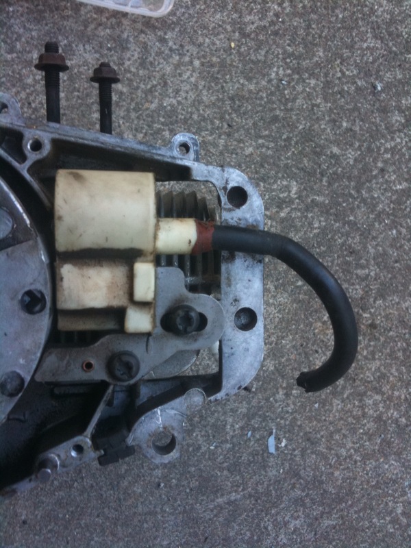

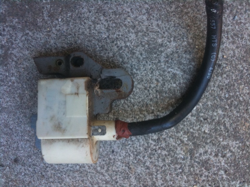

Here are the pics of the coil.
Iguess it is also possible that the gap was wronge. I havne't meesed with it and would assume it was in the right location.
Seems like it was set dead center when Ijust took it off to take the pictures.
What should I set the gap to and how can I measure what gap I am putting it at? use a spak glug gauge?
Or possibly it was just very greasy and dirty never thought of that as a possibilty until I took the pics.

The gap of the coil to the magnet of the flywheel should be about 0.020 inch or about the thickness of a matchbook cover. Do not use steel or magnetic metal to set the gap. Brass or plastic or paper is fine.

Sorry, don't have that particular coil. Clean it up good, and the flywheel too. Make sure the grounding lug isn't grounded out somehow. They don't go bad very often, but it is possible. Try a fresh spark plug as well.

I cleaned both and re gaped it with a business card but it was touching the flywheel when I tried to start it so I gapped it again with a thicker business card and it didn't touch but it still didn't have any spark.
What are you refering to when you say grounding lug?
WhenI first tried to get this thing running I noticed the little coil that was connects to the plug was rusted so I sanded it and cleaned it but it had also worked it's way loose of the plug wire which was a little rusted so Icut about a half inch off so get to clean wire.
I am wondering if possibly maybe the wire is bad and maybe not the coil?
Is it possible to check the coil any other way?

I was speaking of the ground terminal that the kill wire hooks to. You ground that wire/terminal to kill the engine. I have seen where that terminal gets bent over against something grounded and then the mag won't have spark.

Ok that makes more sense, it semed to be ok, I disconnected the kill switch so there shouldn't be anything causing it to ground out.

replaced the coil and the motor now has spark. Have to make some new gaskets and try to fire the engine up this weekend.
