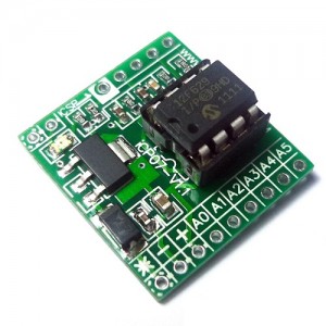

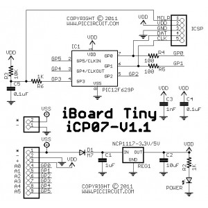

I'm using an iCP07 board connected to the timer board for most of my programming. That board seems pretty decent, so it might be a good place to start for figuring out our timer board design. I know that the ICP header setup works on it and all the pins are exposed.
You can find it here...
http://www.piccircuit.com/shop/pic-d...oard-tiny.html
http://www.piccircuit.com/shop/510-l...board-tiny.jpg
http://www.piccircuit.com/shop/512-l...board-tiny.jpg
We probably don't need the voltage regulator, especially since a UBEC is only around $3-4 from hobbyking. I'm not good enough at EE to figure out what other components could be tossed, but it might not hurt to keep some of the power filtering. Looks like they use 1nF, 0.1uF, 1uF, and 10uF caps for filtering. Other than that there's just a couple resistors and a diode for polarity protection.
There really isn't much to the timer board. We mainly just have to figure out the routing so that all the pins are exposed and organized in a way that suits our connection setup. I'd also like to have a temp sensor, so one of the pins should be arranged next to a +5V pin.
