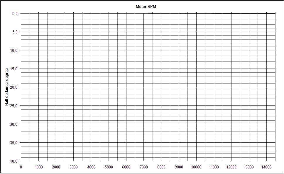

Hi Fly42
I'll show you gr8flyer55 hex CDI ignition curve. Hall position 28 &deg;.
Look at the picture.
I want my image of you. Ignition curve as you want.
I will send you a blank ignition curve.
Describe your idea.
Hall position 36 &deg;. OK?
RPM limiter 9973. OK?
If you have other ideas to communicate.
I'll write you PIC12F683 hex.
Regards nyemi.
