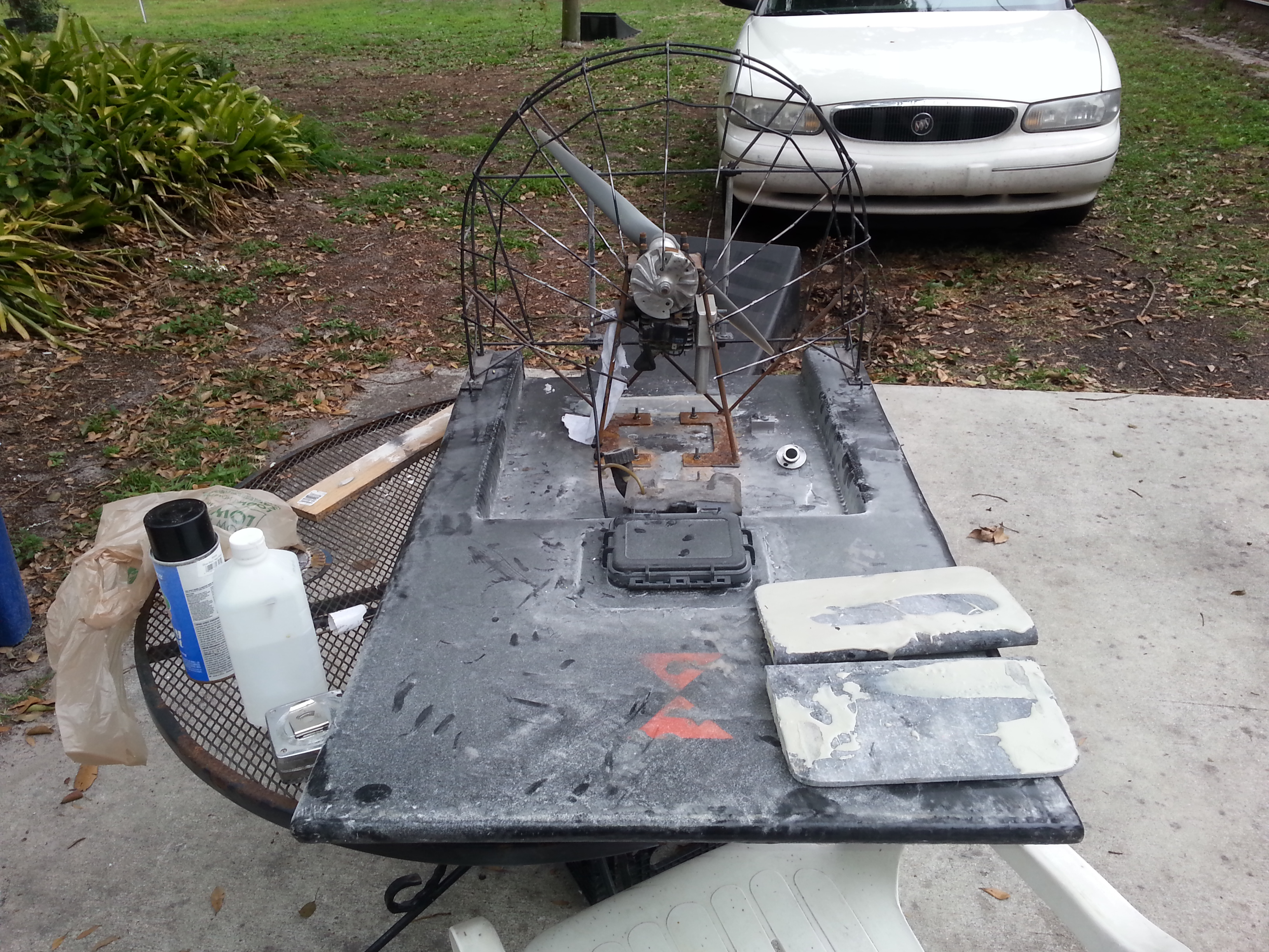

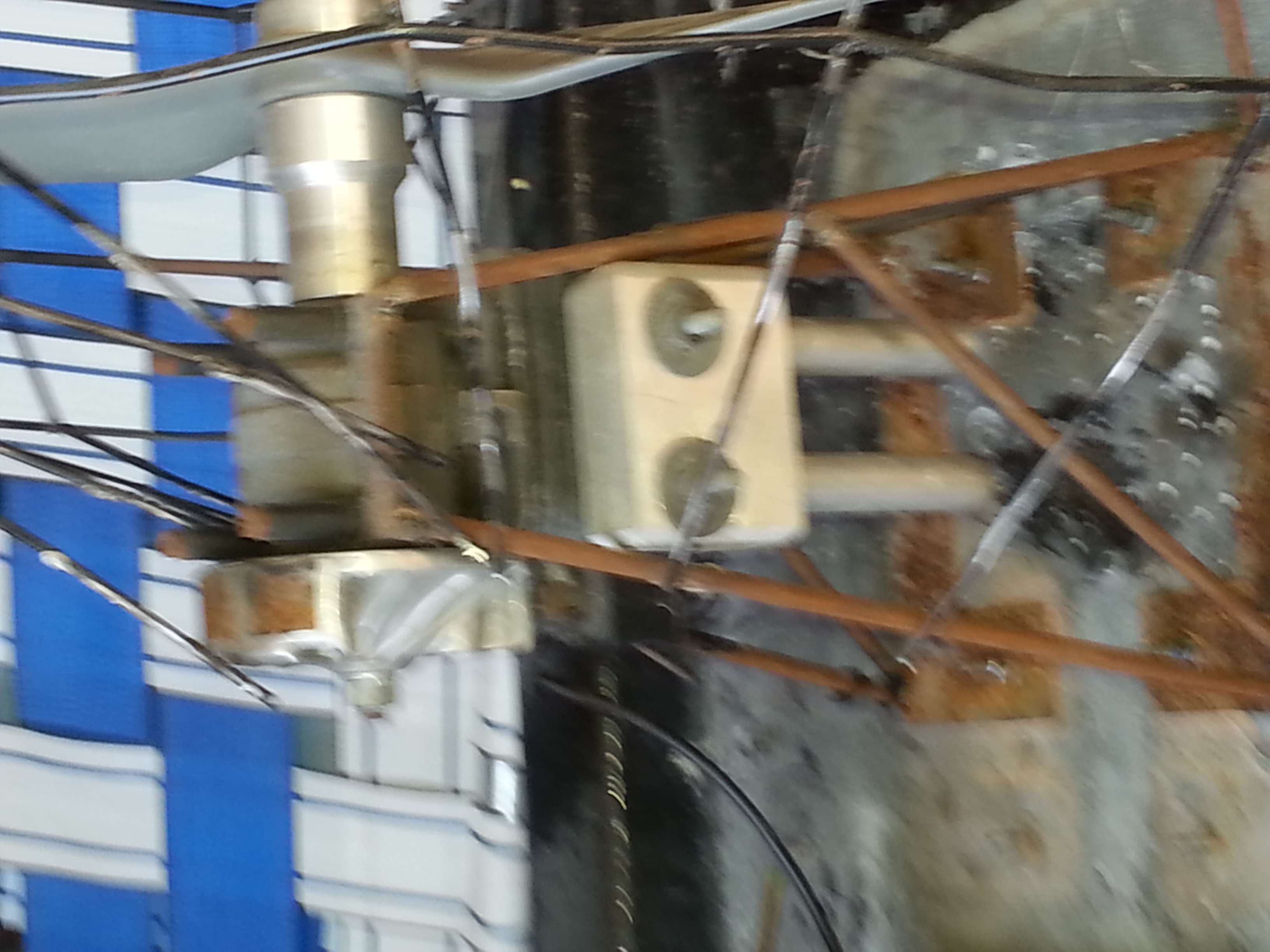

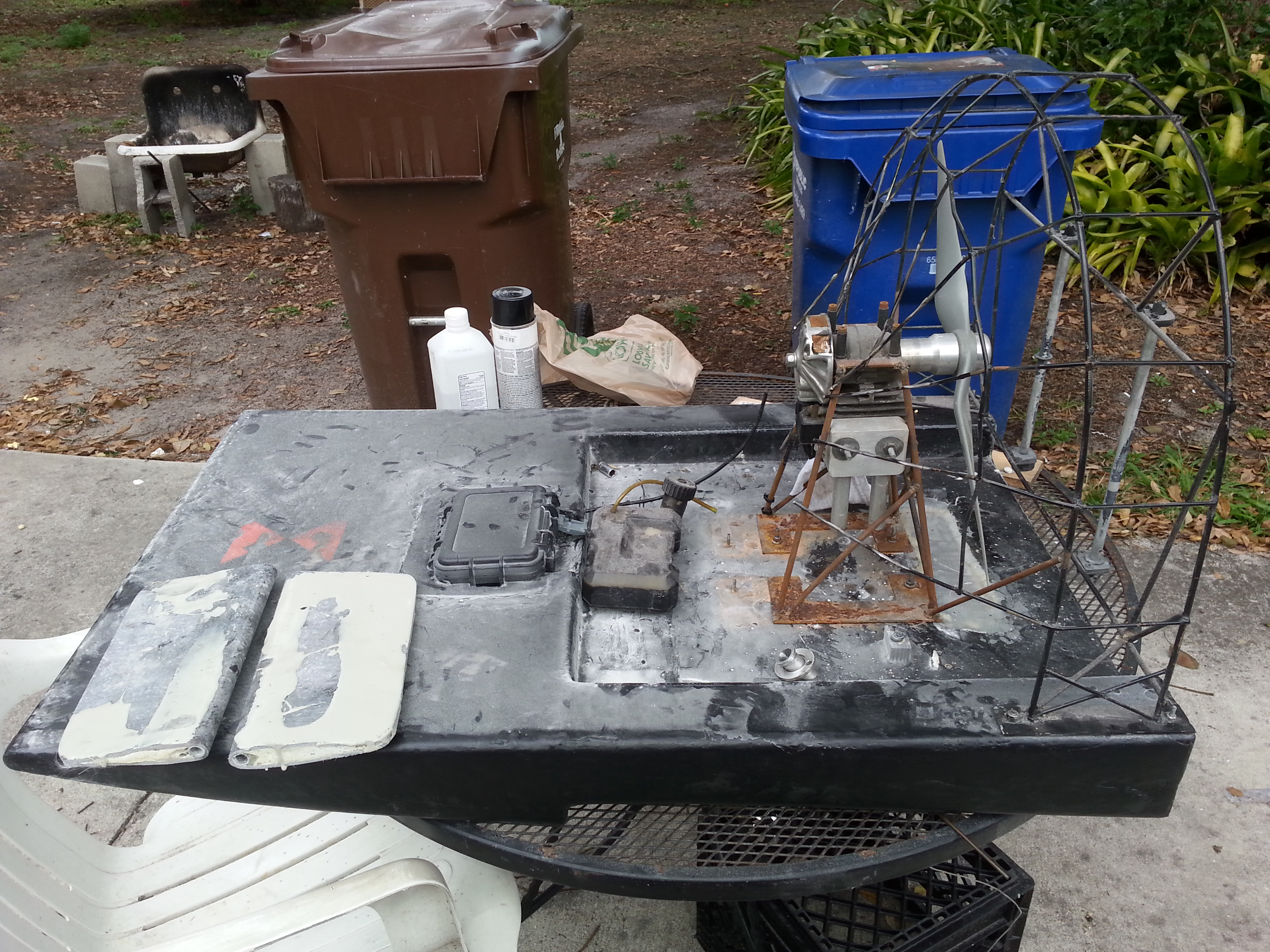

jetG23 02-15-2014 06:27 AM

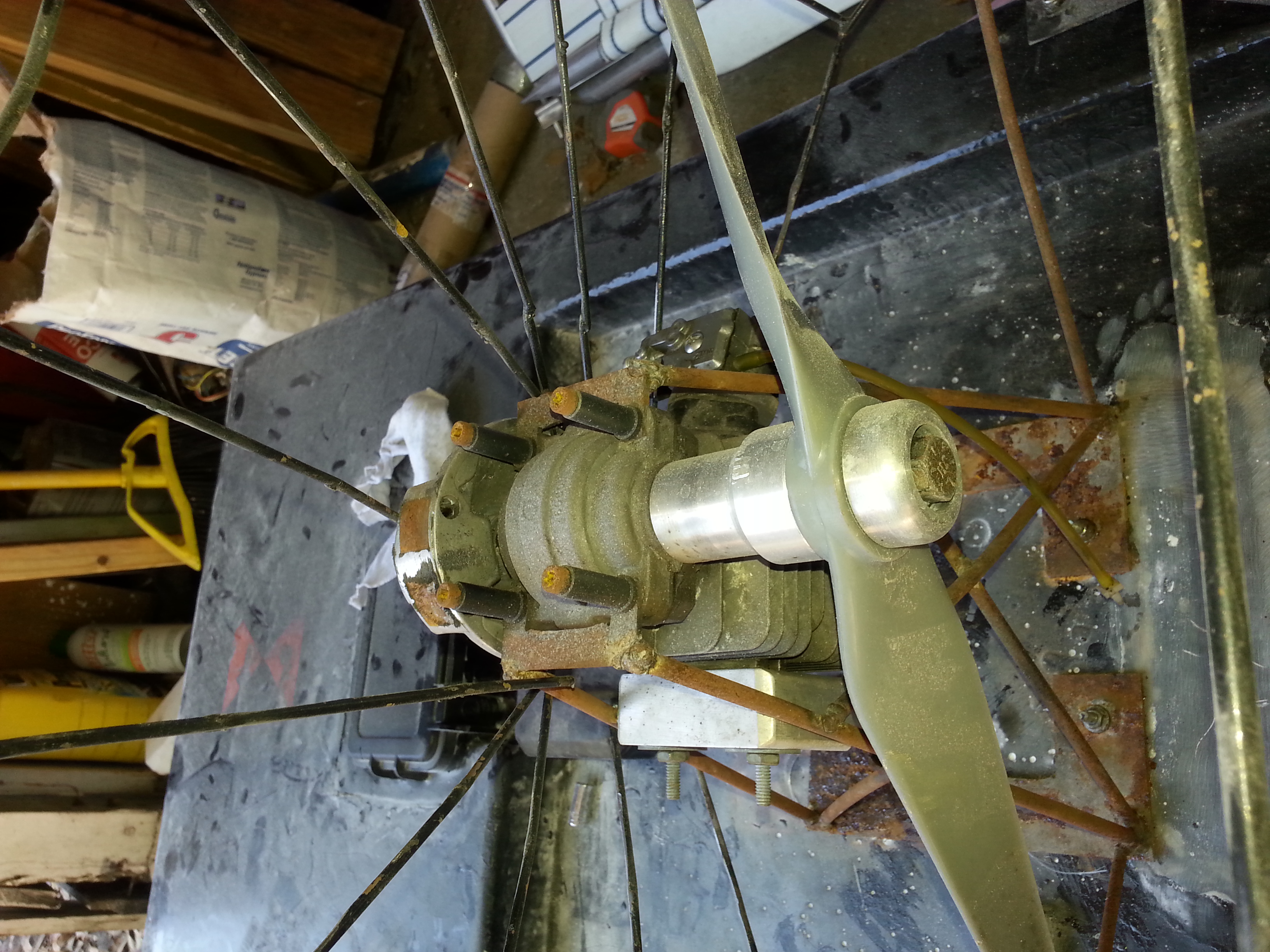

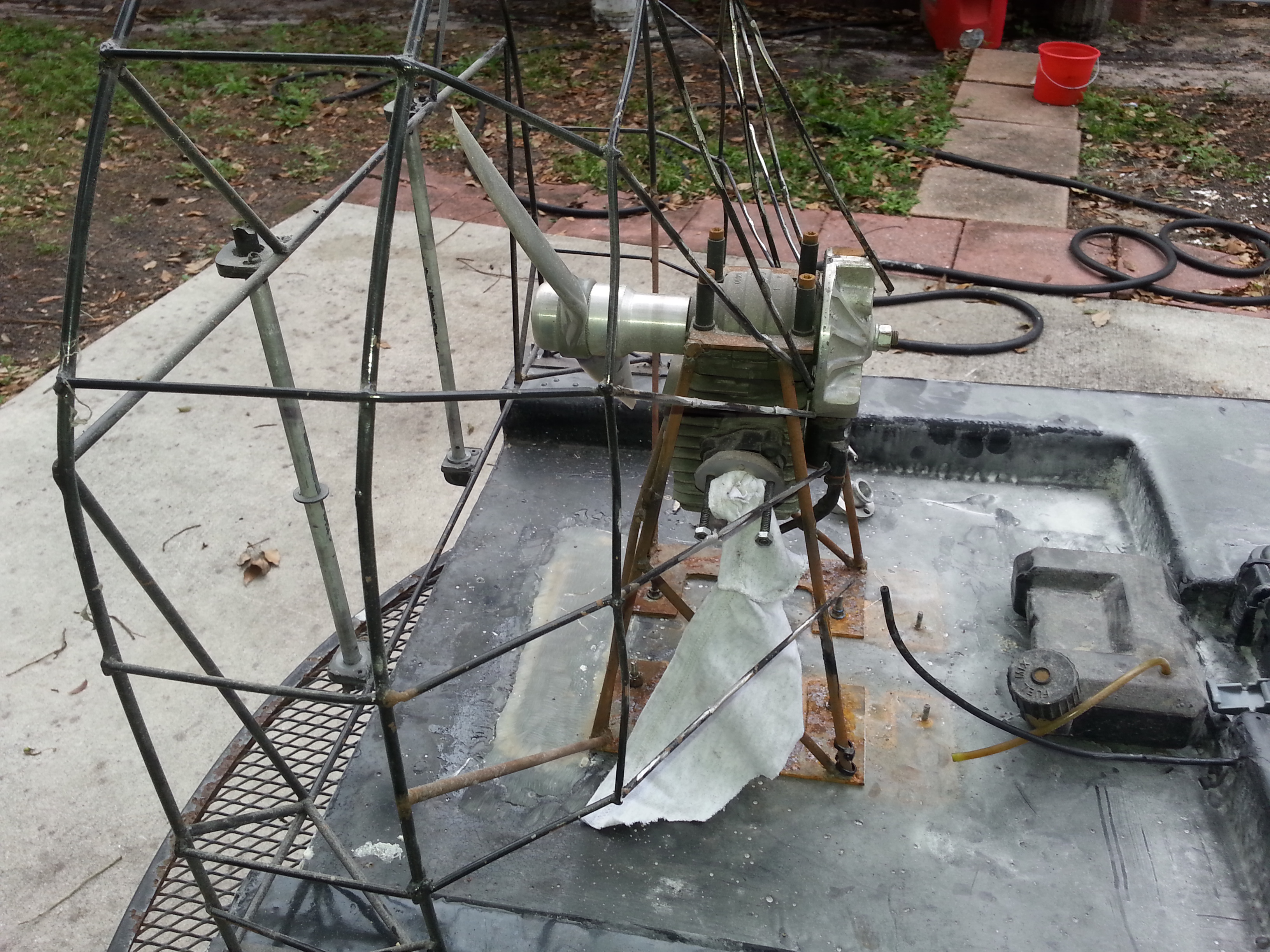

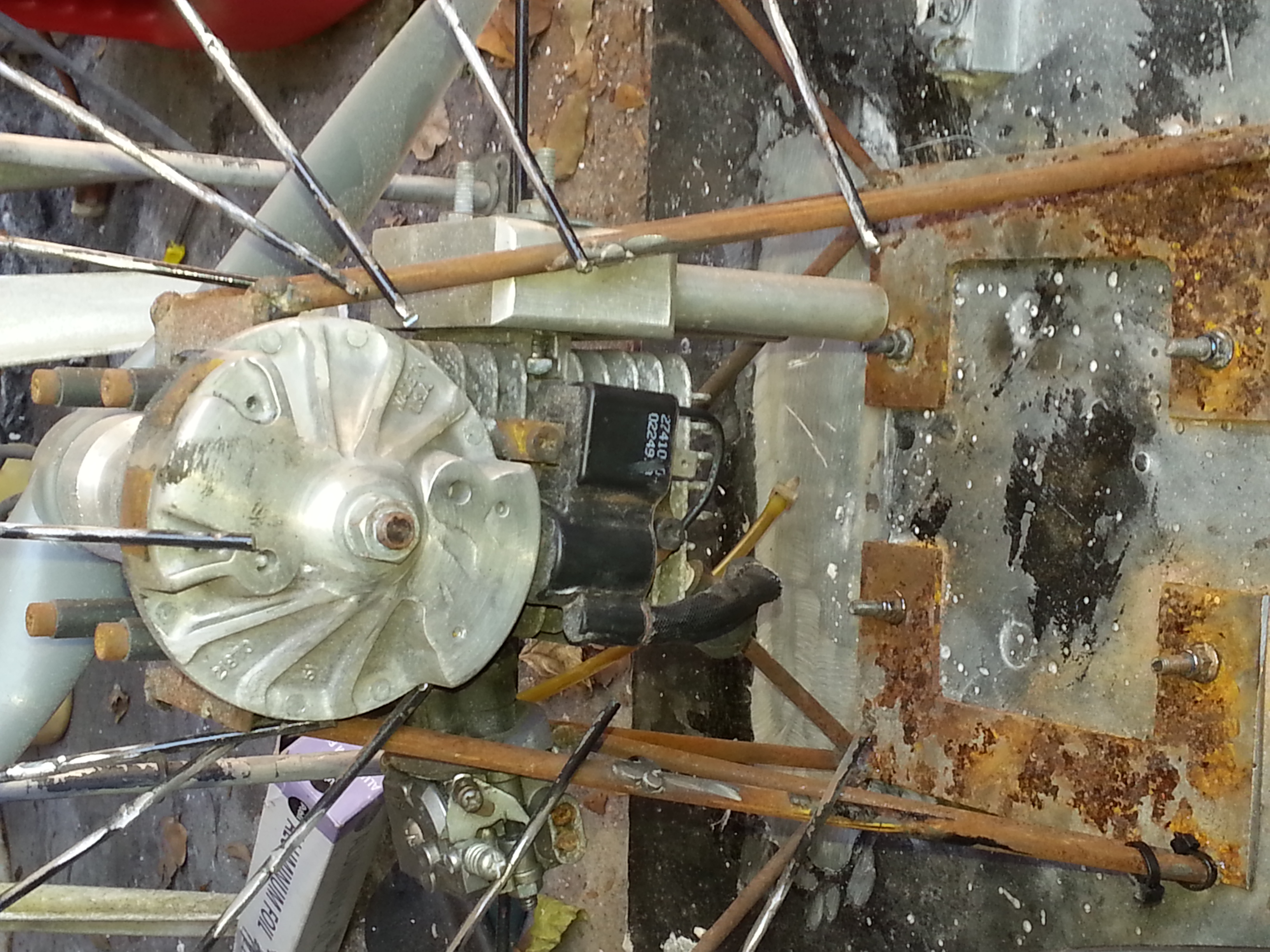

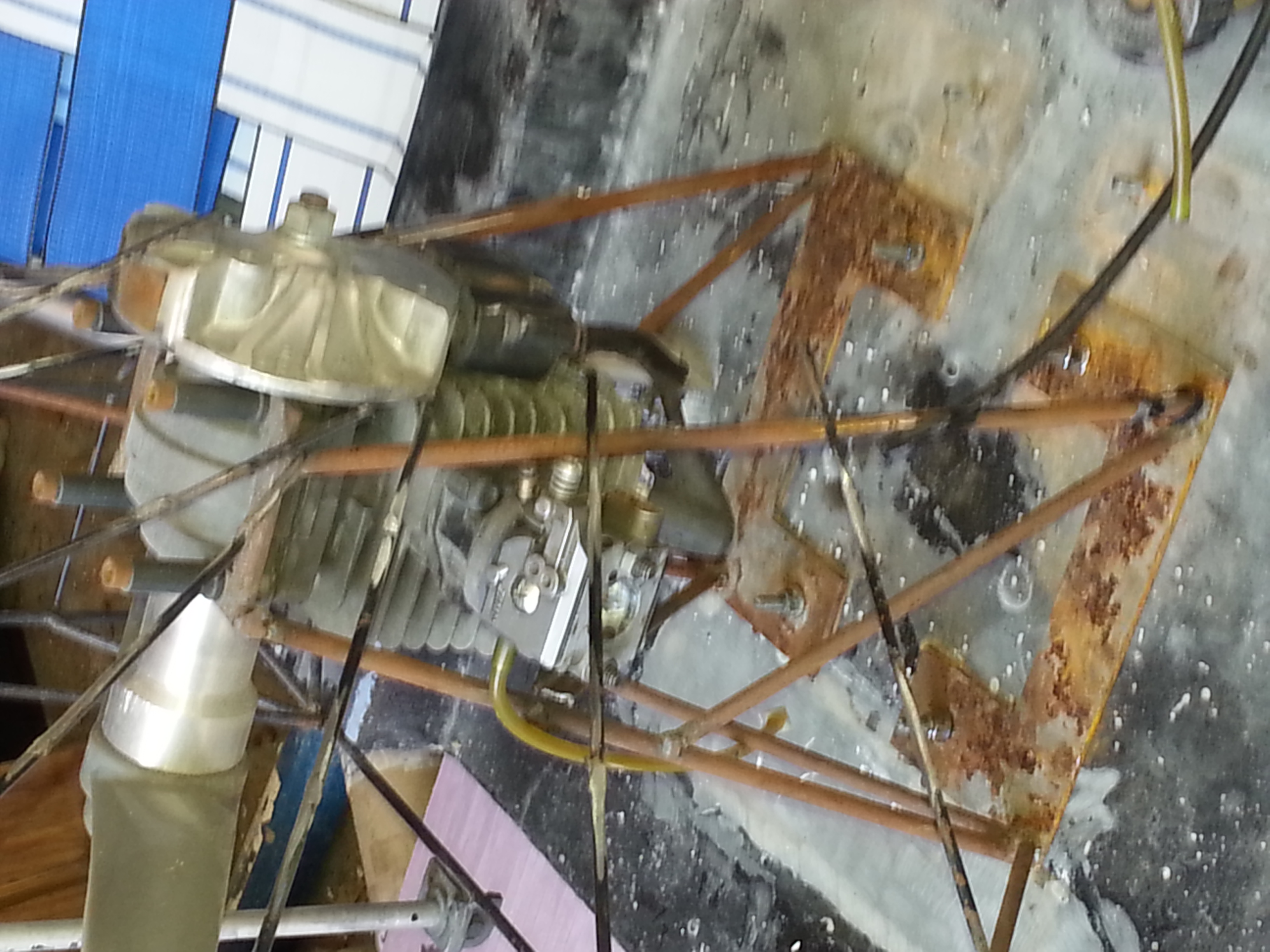

3 Attachment(s)
http://www.rcuniverse.com/forum/atta...mentid=1968619http://www.rcuniverse.com/forum/atta...mentid=1968620http://www.rcuniverse.com/forum/atta...mentid=1968621
jetG23 02-15-2014 06:51 AM
I can get some better close ups if you want !
rcairboater 02-15-2014 07:00 AM
If you have the time, that would be good. What size round bar did you use on the rigging? Is this the engine you are speaking of?

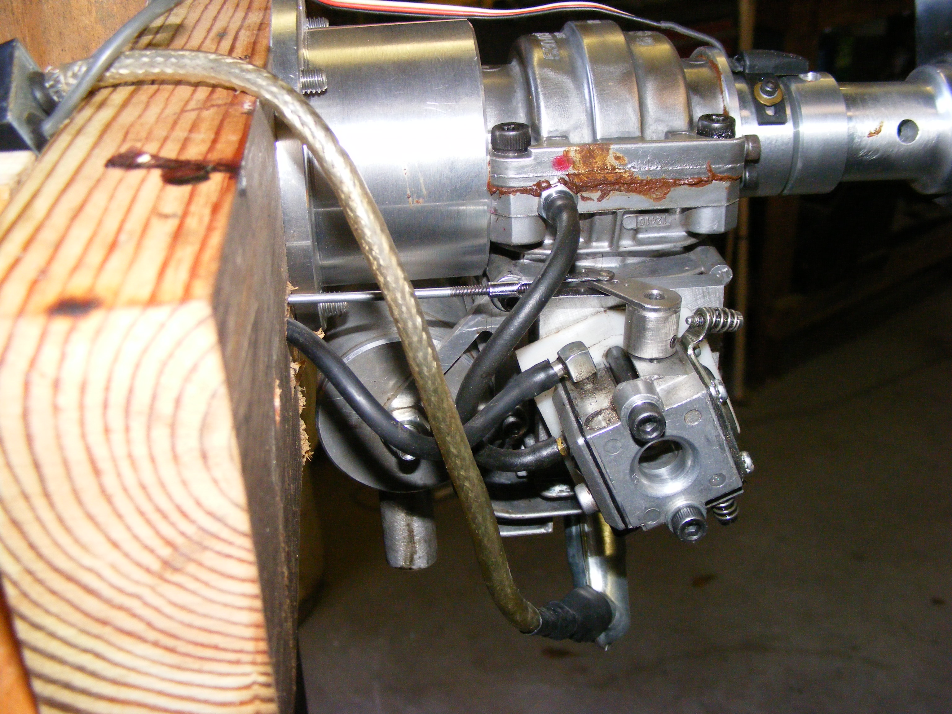

Larry882 02-15-2014 07:04 AM
1 Attachment(s)
Here is a picture of a 42CC Wildthing motor showing where I drilled the case for a pressure fitting. I used a 8-32 screw and drilled threw it with a 3/32" drill bit. You still need to use some type of fiber block to keep the heat from traveling to the carb.http://www.rcuniverse.com/forum/atta...mentid=1968655
av8tor1977 02-15-2014 10:04 AM
That air boat looks cool and I bet it hauls BUTT. You can't even say A $ $. here....:(
Yeah, heat isolation is essential for the carb. I did a Stihl 62cc engine, and I used a carb insulator, but the mounting screws went through the carb and into metal. Enough heat was transmitted through the screws to the carb for it to get too hot and it was a problem. I had to make a new insulator that mounts the conventional way; the insulator bolts to the engine itself, and the carb bolts only to the insulator. Then I had no more problems.

jetG23 02-15-2014 06:25 PM
4 Attachment(s)
http://www.rcuniverse.com/forum/atta...mentid=1968843http://www.rcuniverse.com/forum/atta...mentid=1968844http://www.rcuniverse.com/forum/atta...mentid=1968845http://www.rcuniverse.com/forum/atta...mentid=1968846
rcairboater 02-16-2014 07:07 AM
Thanks for the pics. What exact engine mods did you do with the conversion? Intake, exhaust, compression?
jetG23 02-16-2014 09:31 AM
Its stock other than the muffler and prop hub . Thats why I want to put a bigger carb on it and maybe open the exhaust port a little more.
