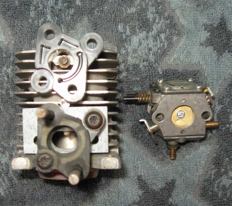

Anyway Hears my question: I started tearing down my Homie 30 and the stock intake runner is only 12.5mm, and the cyl. is the same. The WT-258 11.11mm carb I intended to use is 15mm at the manifold.
Do I have to re-work the intake port on the cyl. or get a different carb?
I do intend on getting a "twister" manifold and I assume the runner will be larger than the stock manifold runner.

If you are going to change insulators eventually, just leave your old one alone. It will run pretty good without inlarging it. But would run better if enlarged.
Some of the 11.11 mm carbs have smaller diameter butterfly diameters but they are all bigger than the stock insulator dimension.

So, what your saying is I don't necessarily have to modify the "insulator" for now.
Even if I change the insulator or enlarge the existing one, the port on the cyl. is still going to be the size of the stock insulator, then what?

Here is a picture of a Homelite "twister" manifold, modified for a larger carb. You fill in the areas around the throat with JB Weld or similar, then enlarge to match the carb throat. You also enlarge/bevel/smooth the intake port to match, but do not remove the little "nub" in the top of the port as this is to keep the ring from catching in the port at BDC. Once you modify the manifold like this, you have to set the carb up for external pulse to operate the fuel pump. Note that I do not recommend trying to drill out the manifold, as the large drill bit can easily "catch" in the relatively soft material of the manifold, and break it or tear it up. I use a drum sander in my Dremel to enlarge them. It goes fast...

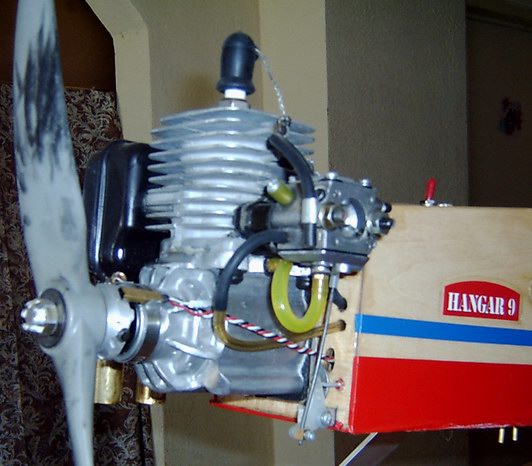

The third pic is of a Homelite with the external pulse setup on the carb, but that particular installation does not have the "twister" manifold. It has the normal one, but also modified as shown. Man, it took me an hour searching through all the pics on my computer for these pics....

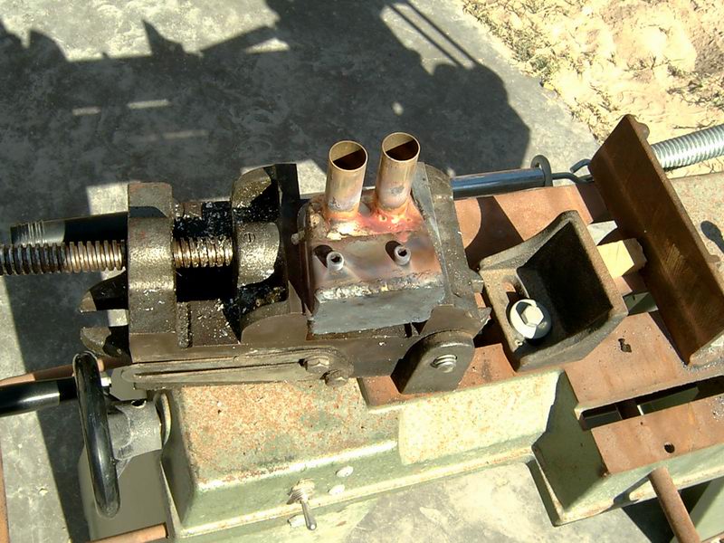

I converted the stock muffler today. It was a pain. I ground off the crimp instead of bending it open and brazed halves back together and installed a 1/2 inch EMT conduit for an outlet. It's rough looking but functional. The engine is stock except for the now modified muffler. I got 6800 RPMs. with a 17/8 Xoar prop. Thats an increase of 500 RPMs over the 6300 box stock configuration. I was hoping for more after seeing how much baffling was in the muffler. I'm still a long way from the 7500 to 8000 some are getting. I'm planning to remove the 9.53mm carb and test with a 11mm carb on stock intake to see what will do. I'm not expecting much though maybe 200 RPMs

I think the hot muffler setup is twin 3/4 inch outlet pipes. Maybe your exhaust is still too restricted. Maybe do a search on Homie mods, I am sure the muffler mod was somewhere on RCU.
Your muffler looks fine. It just needs a good wire brushing and painting.
I like two outlet tubes of at least 1/2" i.d. for 25cc engines. Bigger is better...
