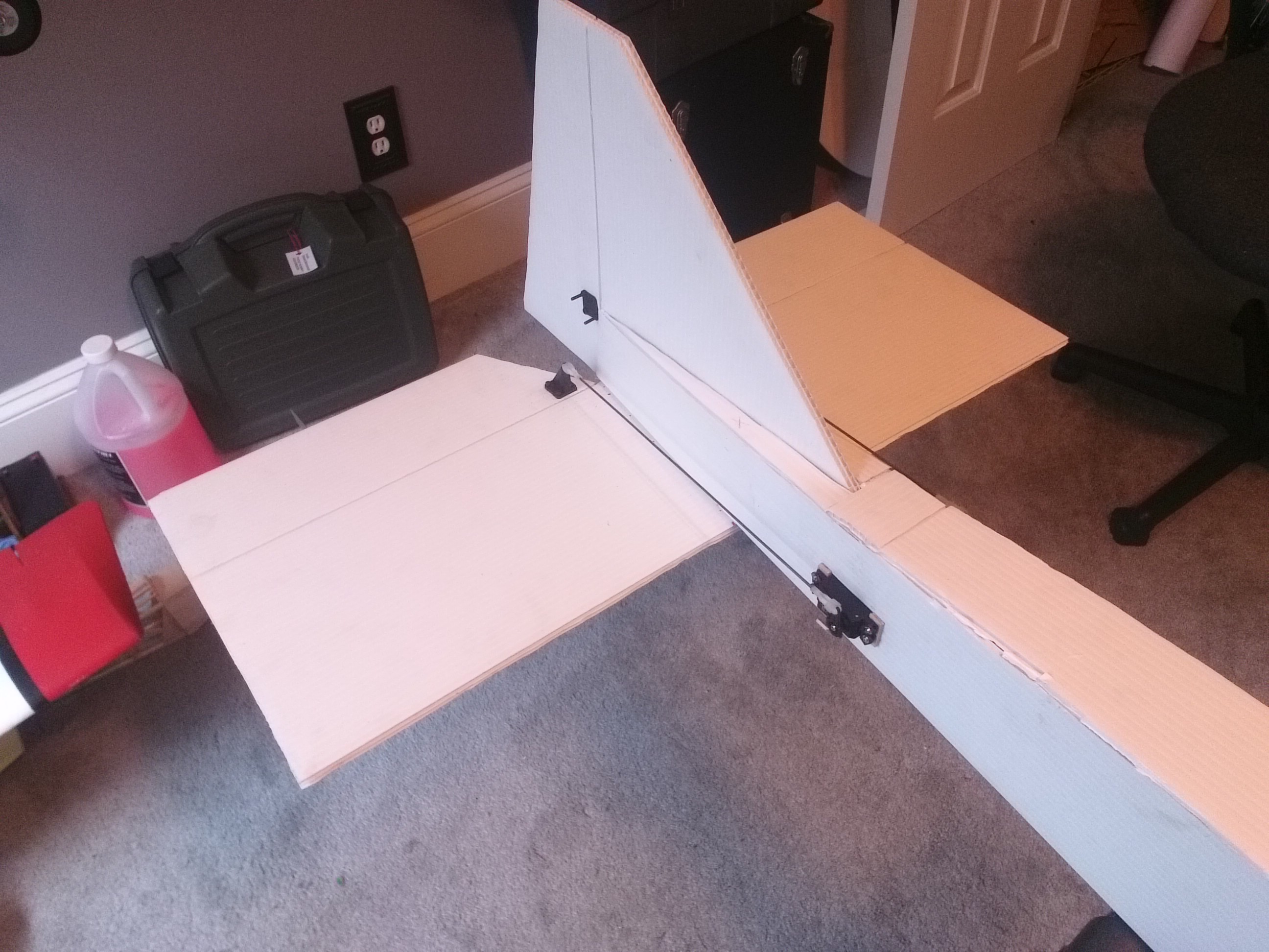

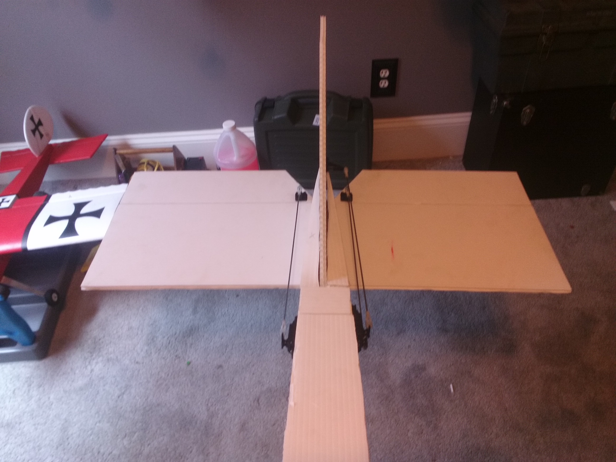

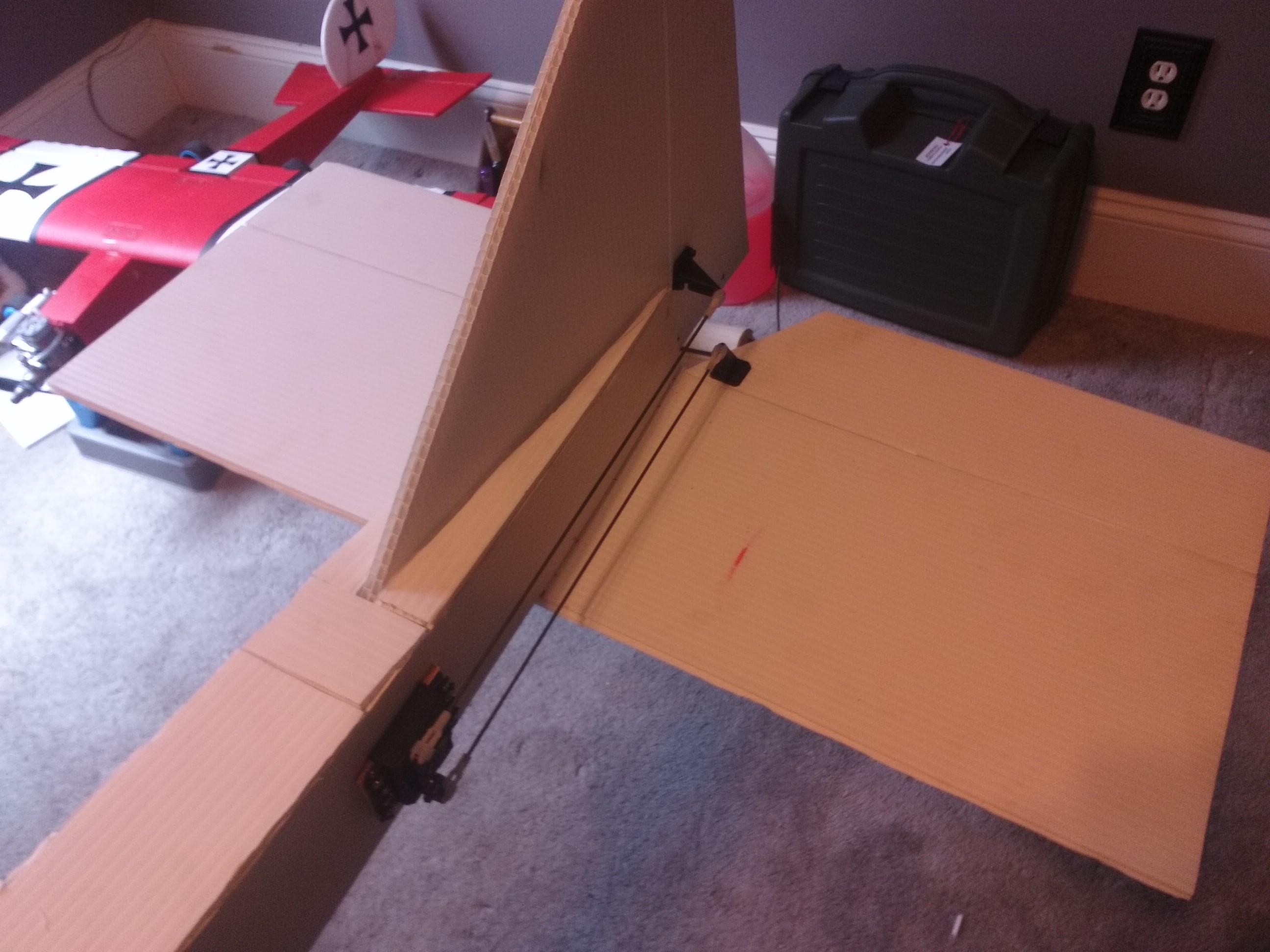

sierra_bravo 08-07-2015 12:26 PM
3 Attachment(s)
thanks for the start up tips av8tor.
I got the servos installed and hooked up and here is what the(for the most part) finished tail section of the fuselage looks like.
http://www.rcuniverse.com/forum/atta...mentid=2113133http://www.rcuniverse.com/forum/atta...mentid=2113134http://www.rcuniverse.com/forum/atta...mentid=2113135
I'm going to buy some white electrical tape to made the edges of the plane look cleaner since right now they aren't very nice. Hopefully tomorrow i'll be able to install the motor
-Sam:cool:
