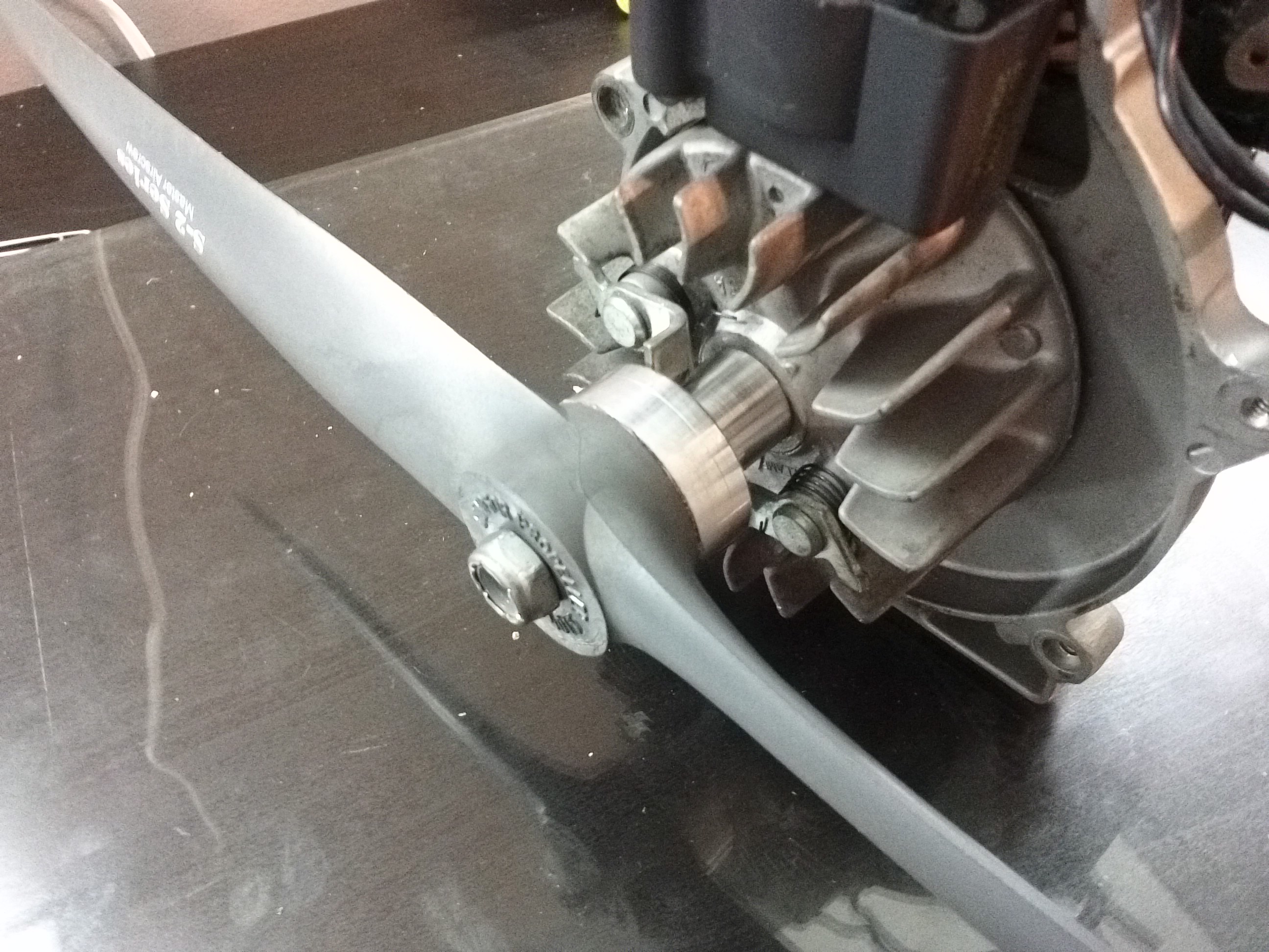

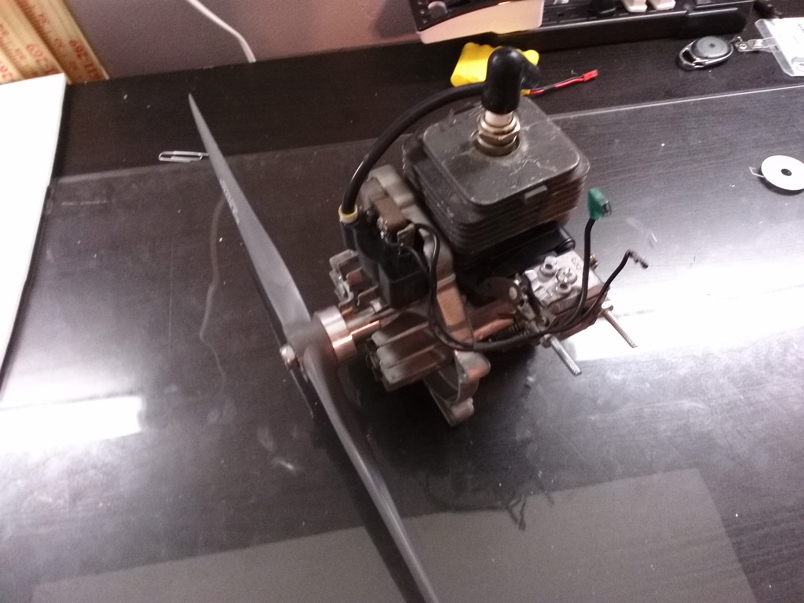

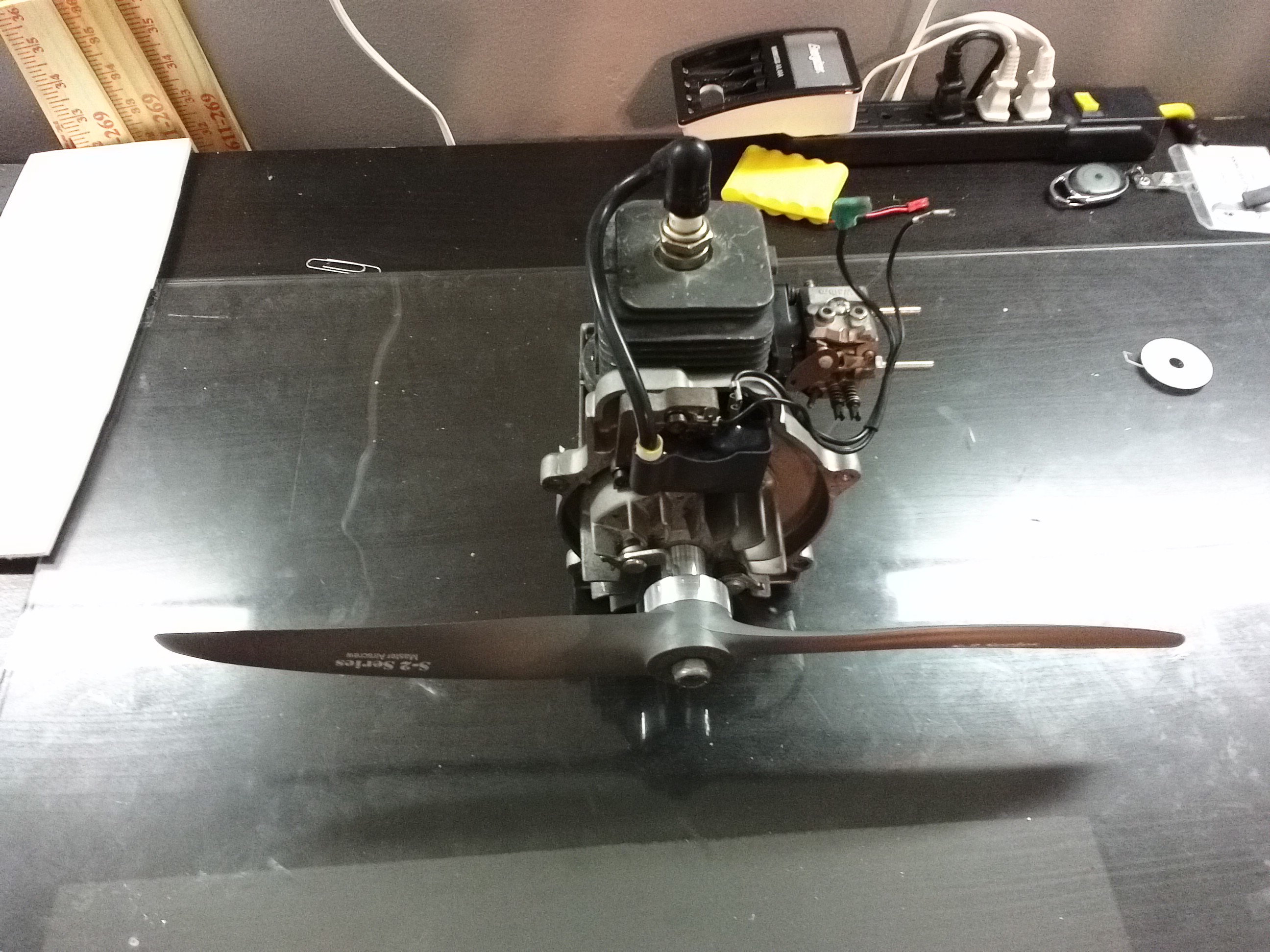

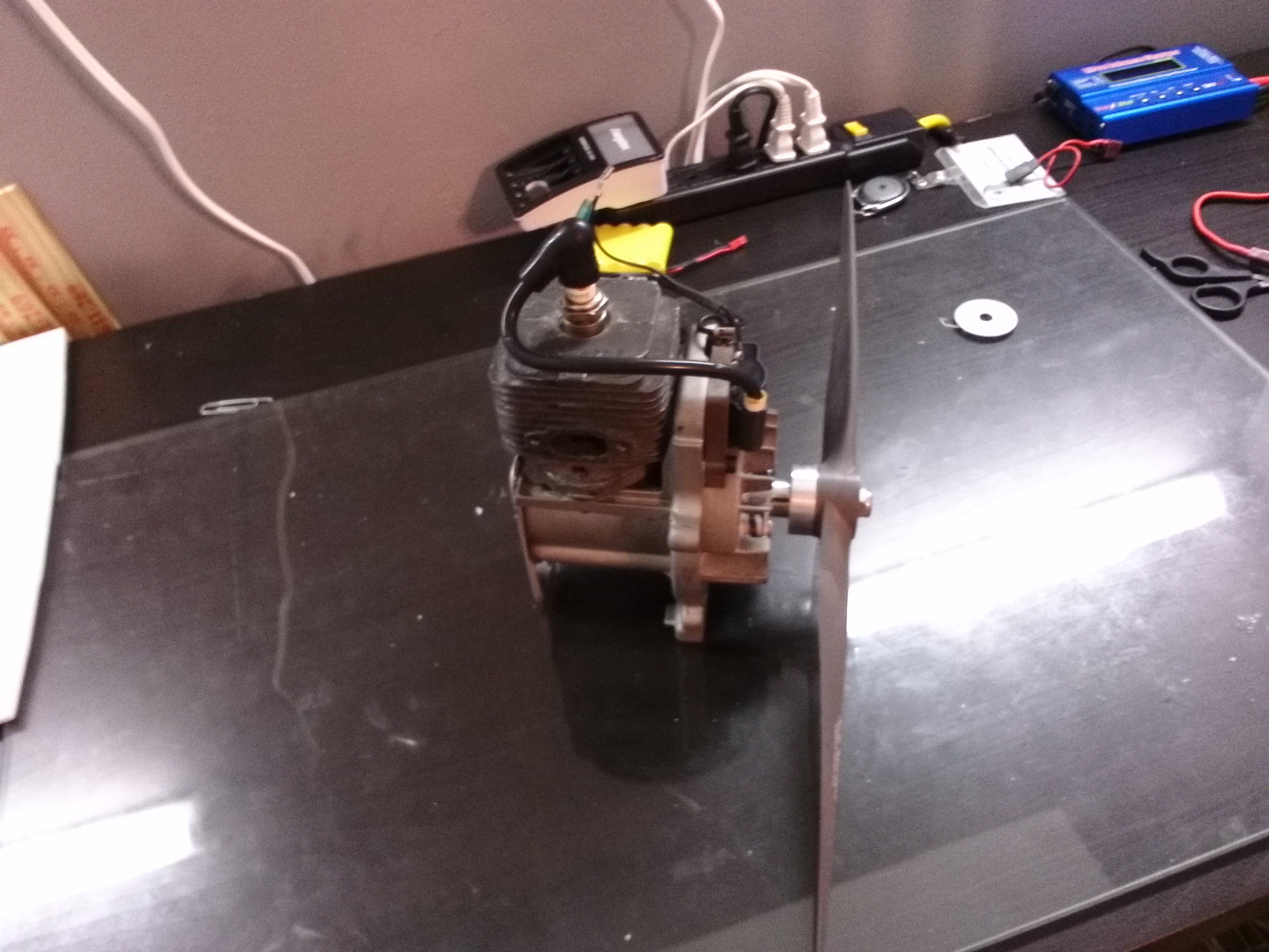

I got the shaft threaded the prop installed and put some new oil on the piston. I got some photos of the prop installed but not mounted to the airframe.
http://www.rcuniverse.com/forum/atta...mentid=2113946http://www.rcuniverse.com/forum/atta...mentid=2113947http://www.rcuniverse.com/forum/atta...mentid=2113948http://www.rcuniverse.com/forum/atta...mentid=2113949
The locking nut does not thread all the way so I probably have to go back to the machine shop to get the hub trimmed down a bit. I could also sand down the center of the prop to make it thinner.
-Sam:cool:
av8tor1977 08-11-2015 12:47 PM
Don't modify the prop; that's dangerous. Wouldn't it just be easiest to get a longer prop mounting stud?? You really need a large flat washer under that nut against the prop anyway.
If all else fails the Top Flite or Zinger props are thinner at the hub....
AV8TOR
sierra_bravo 08-11-2015 05:12 PM
Yeah i though that moding the prop is a bad idea due to is getting badly unbalenced and losing strength. The engines crankshaft is the prop mounting shaft so i cant make it longer. I have a flat washer( you can seee it in a photo) but if i put if on there would'nt be enough thread for the nut. I'll have to look into a topflite prop if I cant find another solution.
-sam:cool:
spaceworm 08-16-2015 05:50 AM
-Sam:cool:
Strongly suggest you remove the starter pawls from the flywheel. Drive the pins that the pawls rotate on from the back of the flywheel. Remove the pins and the springs also.
While you are at the machine shop, have them cut down the fins on the flywheel, but NOT below the hub level. The prop hub is plenty thick, I suggest you thin in down enough to allow the use of the thick washer and the locknut. Radio Shack here in Guilford is out of business, but Ace hardware or true Value should have toggle switches. JMHA.
Sincerely, Richard
av8tor1977 08-16-2015 04:21 PM
As I understand it, your crankshaft goes all the way through the prop hub and then becomes the means for attaching the propeller. An easy fix is to just have the machinist cut off the shaft 3/4" past the end of the flywheel when it is mounted. Then you can obtain and screw a stud into the prop hub adapter, long enough to engage the prop hub by at least 3/4", and also long enough to allow mounting of your propeller, a proper flat washer, and propeller nut.
AV8TOR
sierra_bravo 08-16-2015 04:32 PM
now I see what you meant. I'll either do that make the top of the hub thinner like spaceworm said. I did find a source for the coroplast for the wings. My local piedmount plastics sells 4'x8' 2mil sheets of coro for $11 a sheet. To save some waight I'm going to make the wing out of 2 mil coro not 2 and 4mil coro like the plans said. I plane to mount the motor with some round 3/4" spacers and the bolts coming from behind the firewall.
-Sam:cool:
av8tor1977 08-17-2015 07:38 AM
When you assemble everything for the last time, use Loctite on the crank threads and the stud that will screw into the prop hub to hold the prop, washer, etc. Let dry overnight, then bolt on your prop without Loctite.
AV8TOR
