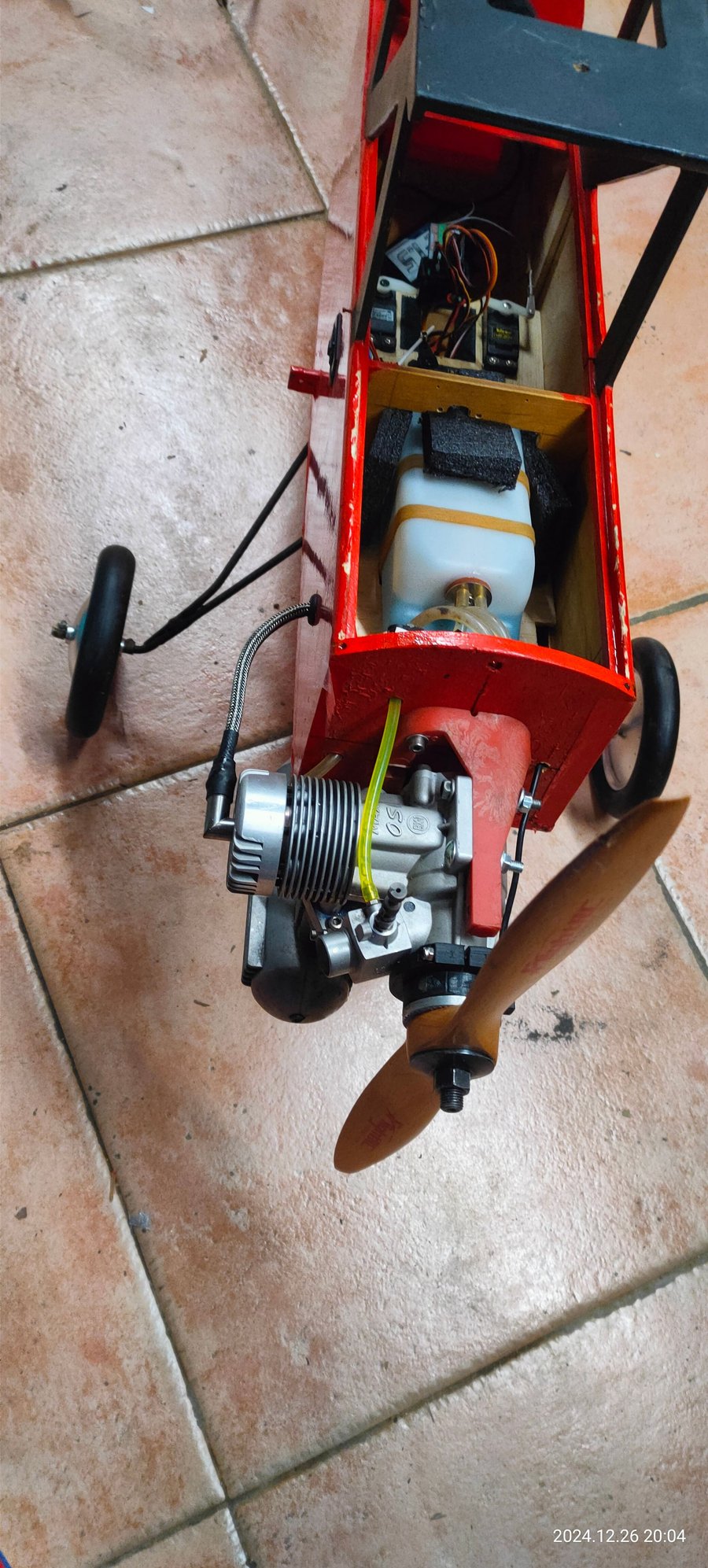

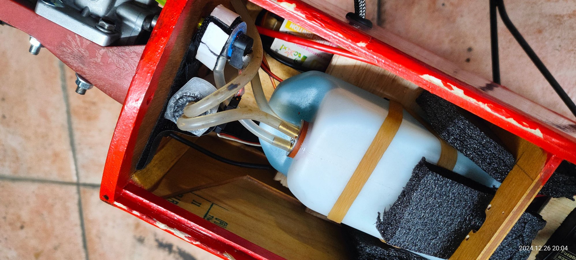

Hi all, today I did a new gas conversion on a OS BX1 108.
I made all parts myself (solenoid controller and solenoid housing), and the first time I had an issue with the mosfet of the controller like Fxdr.
I bought IRLD110 on AliExpress and all seem defective:
https://a.aliexpress.com/_mMfQg15
So, I replaced the IRLD110 of AliExpress, by a IRLZ44N bought on Amazon with a 2.2kOhm 1/4w resistor and all work fine now.
The BX1 engine is just incredible, it started with some prop flips, and without breaking in it runs very smooth with a good idle and flat solenoid curve, I'm just amazed!!
https://cimg6.ibsrv.net/gimg/www.rcu...0ca5fef56e.jpg
https://cimg7.ibsrv.net/gimg/www.rcu...64c6245be3.jpg
https://cimg8.ibsrv.net/gimg/www.rcu...dba89fabca.jpg
Tomorrow, the maiden flight!

The maiden flight was a success! The engine ran very well. Just a little too rich in the first half of the throttle. Bert, when your mixture is good on the ground but rich in flight, how many percent do you typically decrease the curve points? (I know it's different for every engine, but this is to have a general idea)

Ok, I will try again tomorrow. But sound of the engine is clearly like "four stroke" so for me it's too rich.
But like you said, with the solenoid I can go forward and backward on mixture ratio. So I will try percent per percent in each direction to find the best ratio.

First, I installed on my Taranis a switch with a potentiometer that allows to add an offset of -10% to +10% on the curve, with an announcement of the offset value. This solution with the limited offset, allows me to find during the flight if the engine is too rich or too lean for each throttle position, and I can adjust it.
I found that my two converted engines (40FP and BX1) are too rich on the first half of the throttle. Now, the running is almost perfect. As you say, in this throttle range, I am just looking for smooth running and not power, and without risk of dead stick.
I am very happy with this fine tuning method.
