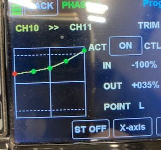

Combined with this earlier remark about the program line you made for Ch 5:
QUOTE:
Should it provide for full -100 to +100 to provide the range required?
In other words, like this:
https://cimg4.ibsrv.net/gimg/www.rcu...c700c6f463.png
END QUOTE
As said before, Ch 5 should have weight 100, offset zero, and I cannot see a reason to use the values you used, but I think this might be part of the issue.

Regardless of this phenomenon, which is engine/carb determined, IF the knob S1 would have the proper control range, the engine SHOULD have fired.
That is why I think your programming of Ch5 is the issue, and you have misled yourself by accepting the "change of sound" as proof of a full control range.
That is why I asked you to use a servo as a simple visual check of having full control range on Ch5, or alternative, confirm with a scope whether the solenoid driver covers the entire range from 0 to 100% dutycycle.
Because the mixture not getting into the ignitable range is the only reason I can think of, for the engine refusing to fire.

Re-reading this thread, the bolded in the quote above, to me suggests that the solenoid at the time of that test was silent with knob S1 in the outer left position.
It does not say explicitly whether the solenoid was silent in the outer RIGHT position, but the programming line for CH 5 as posted, to me suggests it was not.
Meaning that the solenoid, limited by the programming of CH 5 only utilised half of its availlable control range.
Since Chris' posts suggest that the Stihl carb needs about 70% "opening" at around idle, that would indeed mean that the engine never was able to fire due to too lean mixture.

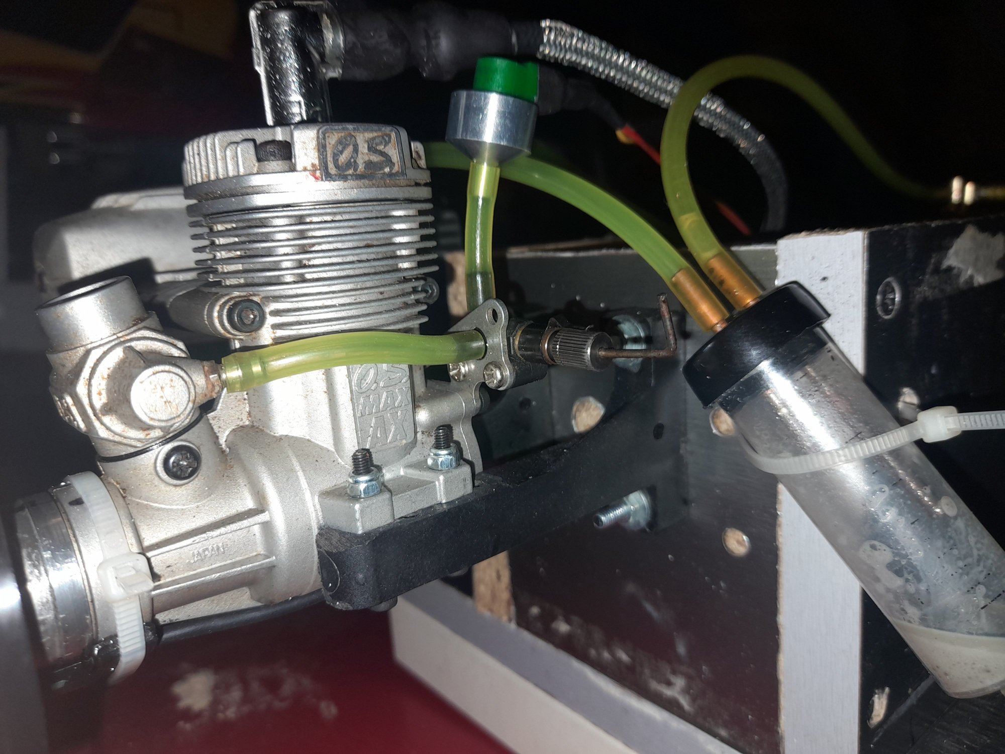

ronron1 12-21-2024 12:35 PM
hi,
thanks for your answers, here is the picture, as you can see the pipe are made of polyethilene, buble were coming from the valve exit and getting bigger until the engine stopped.
https://cimg6.ibsrv.net/gimg/www.rcu...676386a746.jpg
1967brutus 12-22-2024 03:38 AM
That metal part is probably close enough to warm up the plastic NVA sufficiently.
Try what happens if you unscrew the two small crosshead screws, and reroute that tubing so it does not pass through the hole in the braacket anymore.
The bubbles after the solenoid should be extremely tiny and normally are no problem.

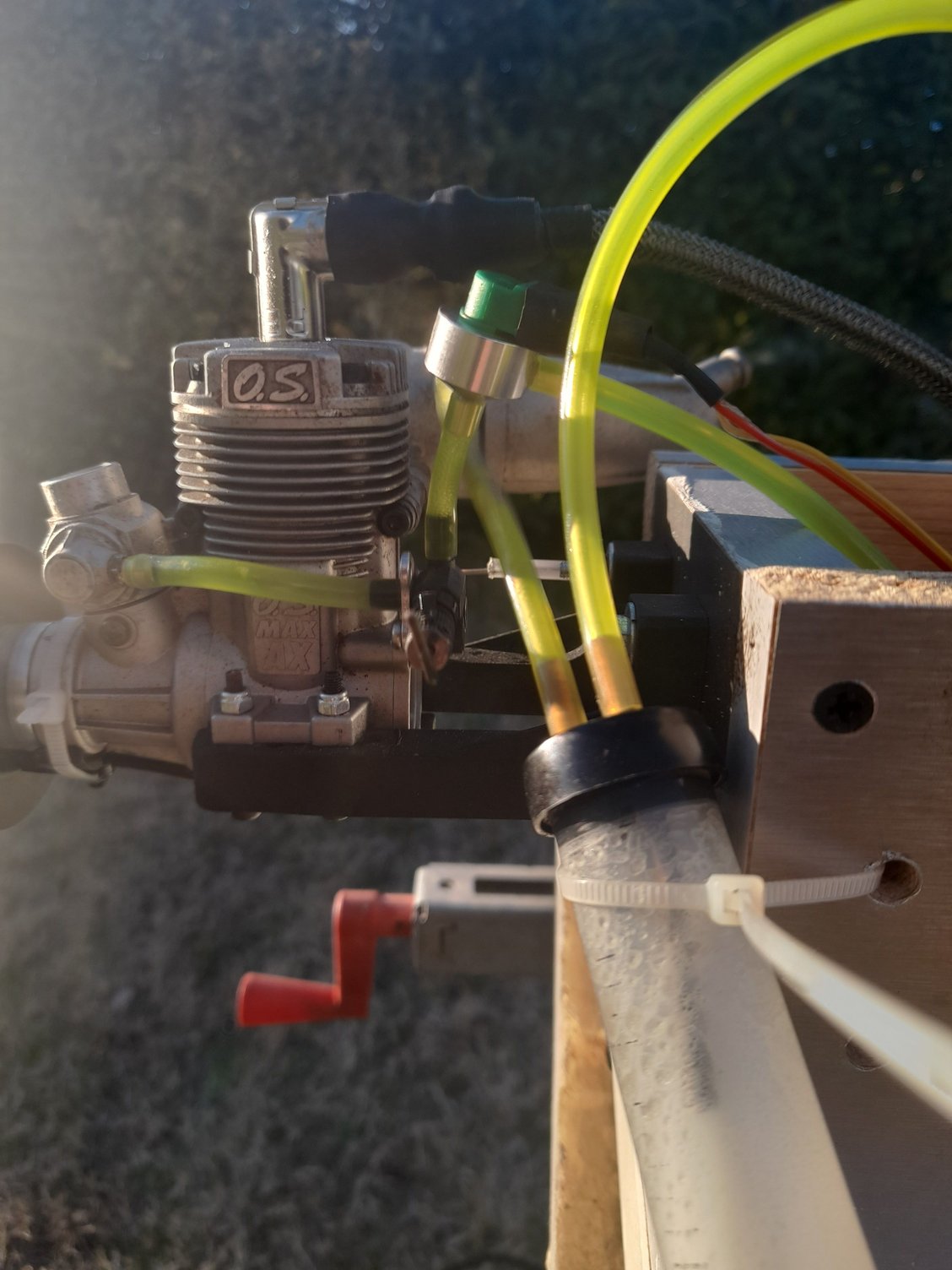

ronron1 12-24-2024 07:36 AM
ok i've shorten the thank tube and now it's bettter i can run it 0 to 100% without any problem , i run a full tank at 50% for today, but i still have buble between valve and needle like you see in picture, i wonder if the tank filter is ok, i'm using this one : https://fr.aliexpress.com/item/10050...yAdapt=glo2fra and i order this one to replace it :https://fr.aliexpress.com/item/10050...yAdapt=glo2fra , thanks for your help
https://cimg8.ibsrv.net/gimg/www.rcu...b371089eef.jpg

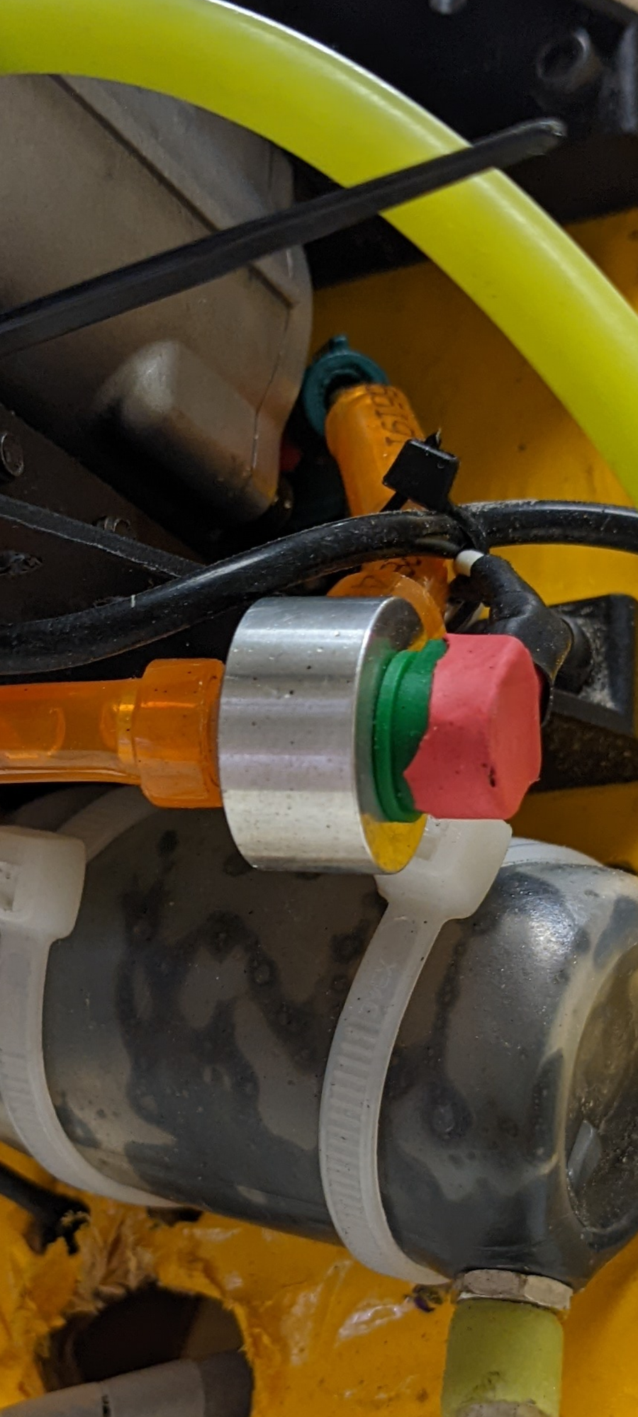

Raleighcopter 12-24-2024 07:46 AM
Cut 1/4" (6mm) pieces of tubing and use them as clamps at all the tubing joints in and out of the tank, solenoid, and engine. See if that stops the air leak.
https://cimg2.ibsrv.net/gimg/www.rcu...1ab0d7f5f9.png

Raleighcopter 12-24-2024 08:29 AM
Maybe but I know short bits of the same size tubing works well.

Glowgeek 12-25-2024 03:40 AM
As the solenoid is not a pump, the tank should be mounted as close to the engine as possible. The centerline of the tank should be mounted very close to the same height as the high speed needle.

1967brutus 12-25-2024 08:00 PM
In the final installation, in a plane, this is important.
On the testbench, only the height of the tank matters, but the distance can be up to one metre (3 ft) without issues, as long as the fuel tubing is "immobilized",
Glowgeek 12-26-2024 07:21 AM
True. There was a vast improvement with the tank closer to the engine, however there may have been a tank height change made as well.
