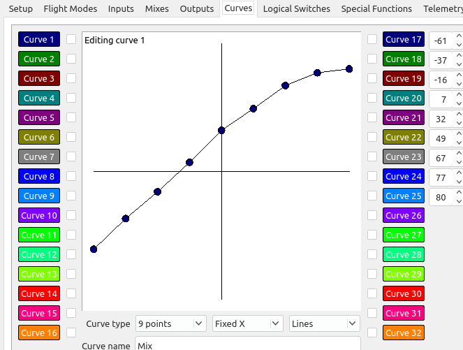

Jim.Thompson 06-16-2025 03:19 PM
Check if there is an indexing on your gimbal..............
There is no mechanical indexing on my RadioMaster RM16S
The throttle curve should be set once, like a progressive curve, and preferrably NOT be modified unless really really necessary. Ideally, you want an as linear as possible stickposition-RPM relation............
I have no throttle curve in the set up...yet. Mainly due to my infinite ignorance. I will go back over the huge thread and find posts describing how to establish one.
As to your question on the set-up with the switch, I have never been able to figure out a programming in Open TX that would allow me to tune the mixture "on the fly" in flight.
There is some mis-communication here. I may have asked that question last year some time, but that has been resolved in the negative as far as I know. My use of pot S2 (to operate the solenoid driver directly) yesterday for the first successful startup was only very temporary to confirm the engine would fire up and run in the very first instance. I recall you describing this earlier on. Temporary measure only.
Make a habit of checking your exhaust residue at the end of each day, the cleaner it gets, the closer you are to "perfect", and with this set-up it actually IS possible to achieve a virtually non-black exhaust residue. It's NOT a necessity (a little bit blackish crud does NOT indicate a problem of any kind), just that when it turns to brown and "recognizable as oil" that means you are darn close to perfect.,,,,,,,,,,,
Excellent! Well noted. The exhaust is dirty black currently.........for reasons that will be obvious.
Many thanks once again for you detailed reply Bert!
I have some way to go yet, but I'm confident now that I/we can get it sorted out to operate real nice.
Jim.
https://cimg0.ibsrv.net/gimg/www.rcu...8cb7bad5f1.png
This is the curve that I have operational at present.

1967brutus 06-16-2025 11:32 PM
Ok? That's too bad, because that would really help with setting up.
Maybe there is a way to improvise one? Like simply sticking some 1 mm grid paper to the side of the throttle stick?
Just rattling off something off the back of my mind?
No need to go over the entire thread...
Here's how to do it: Provided the mechanical linkage between servo and throttle lever is 1:1, linear and symetric, the following curve will yield very acceptable results:
(9 point curve)
-100, -90, -75, -55, -20, +20, +50, +75, +100.
Use "smooth" function, and if needed, modify to suit
Without the throttle curve your engine will allready be well above the middle of the practical RPM range with less than 1/4 stick.
The issue is not so much "controllability of the engine" itself (which, I can assure you, REALLY helps to grease those landings once you're used to it), but it is that in that low throttle range, mixture requirements are fairly critical. If you use a linear throttle curve, assuming 9 point curves, there is only 2 points on the mixture-curve to cover well over half the usable RPM range, which simply is not enough to cover that wide a range. Then you have 6 points to cover a MUCH smaller RPM difference, and there is no need OR use for that much resolution in a rather uncritical part of the carburation.
The purpose of the throttle curve, is to "spread the RPM spectrum out" in a linear fashion over the entire stickrange. Doing that, now you have FOUR points covering a smaller RPM range, which will allow a much better control, and you will be rewarded with a very smooth engine response.
PS: that curve looks pretty decent for a linear throttle set-up.
Notice, that your fuel curve is steep off idle and flattens out towards full throttle.
A progressive throttle curve will cause your fuel curve to be steep at the high end and flatter at the low end, allowing for finer fuel control, and a cleaner exhaust residue, which, while absolutely NOT a critical thing to have, I am sure anyone can appreciate cleaner planes. Makes it easier to justify the hobby to one's significant others :D :D :D

Jim.Thompson 06-18-2025 01:22 AM
Matching throttle output to each successive point on the curve.
I plan to experiment on an alternative way to do this.
In Otx. 2.3.15
If I select "fixed X" in the parameters entry in the curved set up page, then each of the nine points will be separated by 12.5% of the 500 uS between max and min throttle stick positions.........(My channel output displaying 1500 to 2000 when the stick is moved from min to max.)
I simply need do a quick bit arithmetic and make a list of the 9 positions value in mS.
That is:
1500 1562 1625 1749 1812 1874 1740 1937 2000
Then set the throttle on each figure as displayed on the RadioMaster RM 16S tx. channel outputs page, and then adjust the corresponding point on the curve..
I plan to try this tomorrow and improve my solenoid tuning skills!
Jim.

I don't use stepped throttle or a mechanically indexed throttle to determine throttle position while using otx. I simply set up a momementary switch to play an audible throttle position in flight. Adjustments are then accomplished on the ground at the same throttle position. Can't get any more simple or accurate than that.
Jim.Thompson 06-18-2025 03:35 AM
Originally Posted by Glowgeek (Post 12821403)
Jim,
.................. I simply set up a momementary switch to play an audible throttle position in flight. Adjustments are then accomplished on the ground at the same throttle position. ................
Very good suggestion. I will try that tomorrow.
Thanks.
1967brutus 06-18-2025 05:49 AM
Jim,
Now dammit! THAT is a clever solution!
And stuff like this, is what makes this forum so valuable! Thanks!
