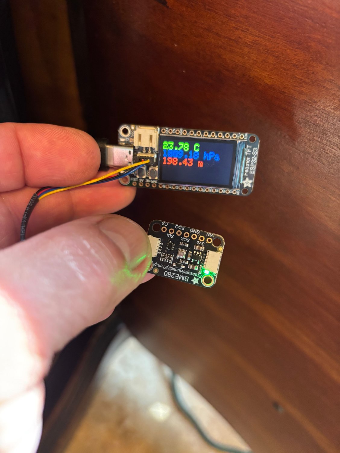

xanaphyst 02-28-2026 11:17 AM
Originally Posted by Bernett (Post 12830936)
xanaphyst. What am I looking at in your latest post? I'm definitely interested in what you are doing. Thanks
Its nothing more than a copy of the hard work already put in by other people. The only difference in my setup is I had to change out some of the programming
code because I used a different environmental sensor for pressure and temperature. I am however working on a small PCB design that will very compactly put
all the parts together neatly and offer a very simple building and wiring solution. That PCB will still use the already proven design from Mr. "raleighcopter"
https://github.com/raleighcopter/my-mixture-controller
I'm planning for the future to develop my own version using a different controller that has all the components integrated into a single board. The board for this purpose is
a:

xanaphyst 02-28-2026 11:27 AM
Adafruit Feather board with initial programming for the BME280 sensor on the I2C interface. The wired sensor board at the bottom will not exist in the final version as the sensor will be embedded.
This project while ongoing is not priority at this moment though.

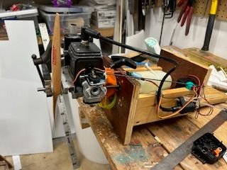

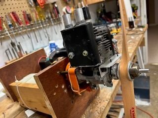

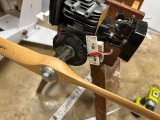

I have added some photos of the Echo and Stihl conversions in case others are interested in some of my methods. Both have pull starts on them.

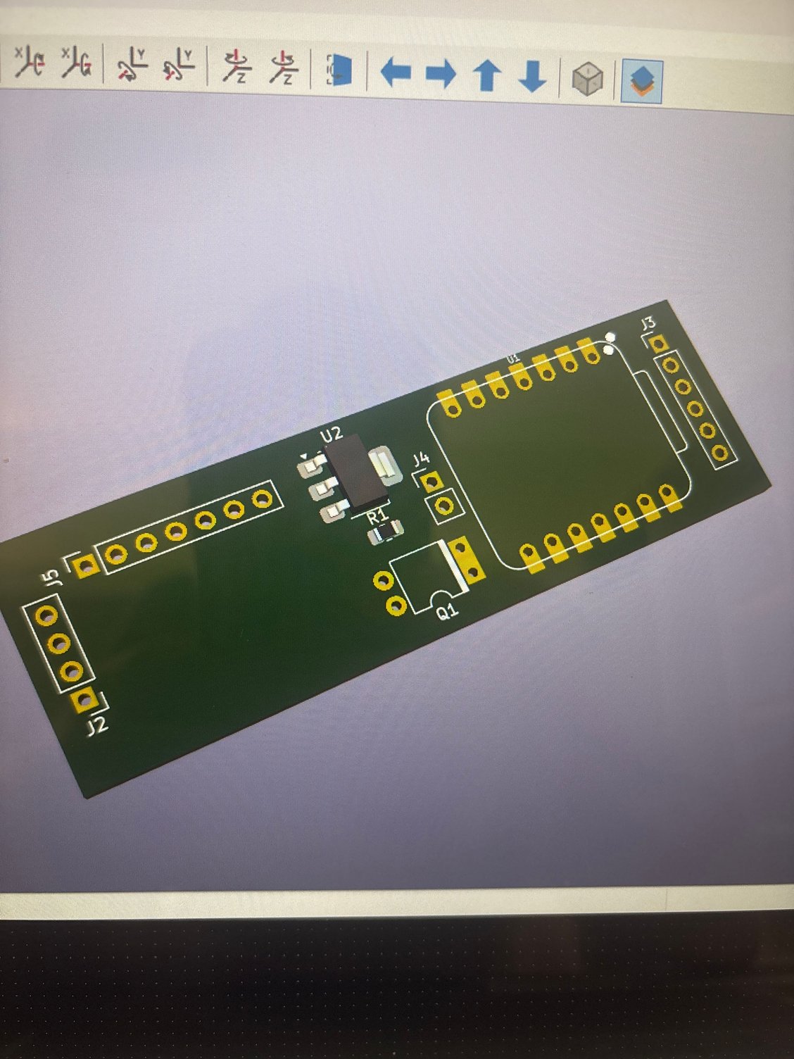

xanaphyst 03-02-2026 09:44 AM
Almost there……
https://cimg9.ibsrv.net/gimg/www.rcu...566fa13891.jpg

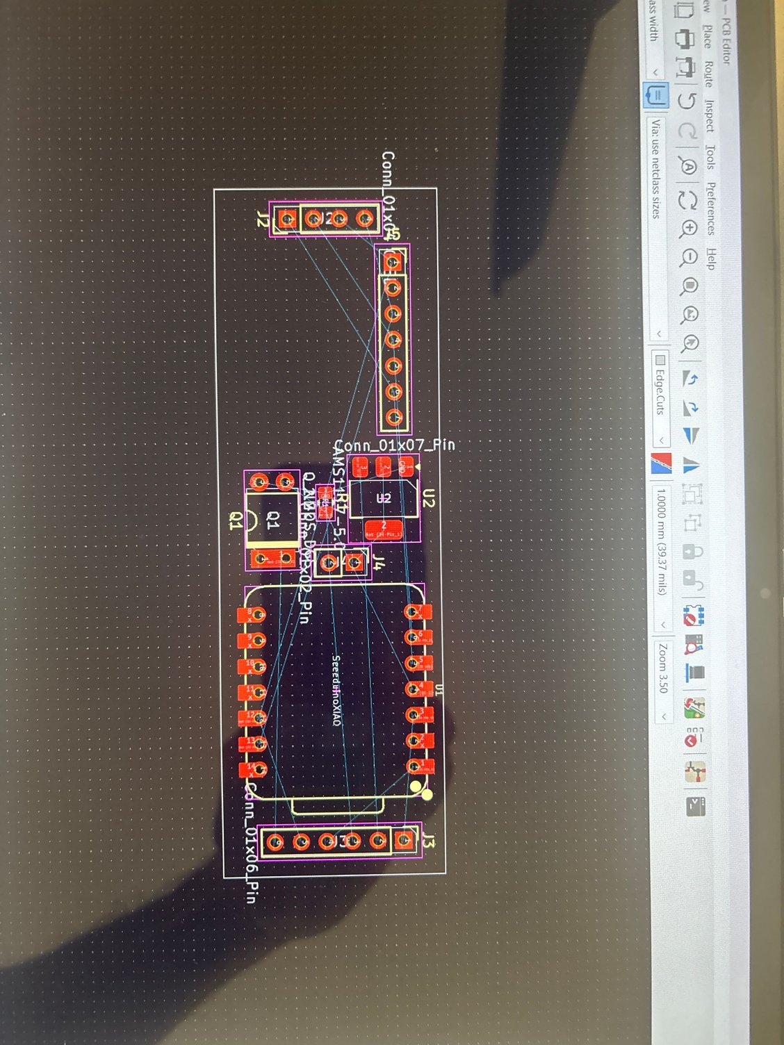

xanaphyst 03-02-2026 09:50 AM
Layout
https://cimg8.ibsrv.net/gimg/www.rcu...81841676de.jpg
BME280 J5 will be on same side as Seeeduino with OLED J2 mounted on opposite side. Diode of original design replaced with SMD voltage regulator so you can use any voltage supply from your reciever up to 18 volts. 6 pin header J3 used for clean wiring. J4 is the jumper to GND and VIN pads on the underside of the Seeeduino.
