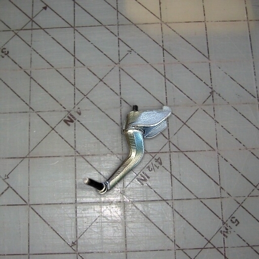

Thats basically the same process of sintered powder metal parts forming. Its versatile, and can be used in many applications though... Being able to print it rather than form it in a mold, certainly makes it more user friendly.
This is a 1/4 scale scotts tailwheel I cast with the lost wax process, Its a lightweight alloy cast around a .125" OD music wire core, bent to shape and then supported in the plaster mold.
Attachment 2272055
