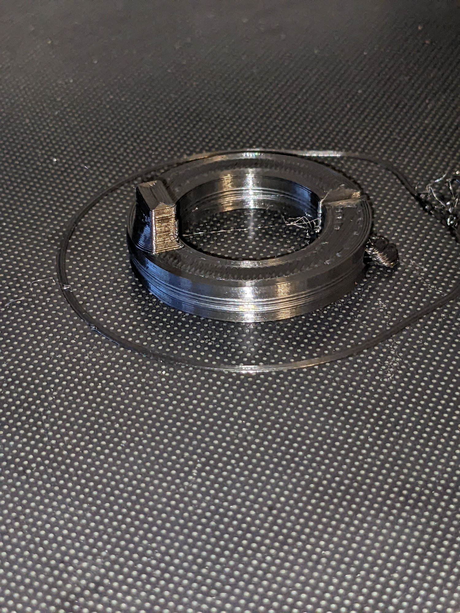

about damp filament
Pla will get brittle with it gets damp; this can become so extreme that is breaks just by unspooling it.
Also the boiling off of that water when the filament is in the heat blok part of your extruder can cause it to get blocked.
Or you get uneven flow making prints ugly.
So when you are not using it then keep it in a ziplock bag.
When you are trying abs make sure the slicer includes a skirt/fence around the print.
This will reduce drafts and that will reduce uneven clooling and the warping that is a result of that.
