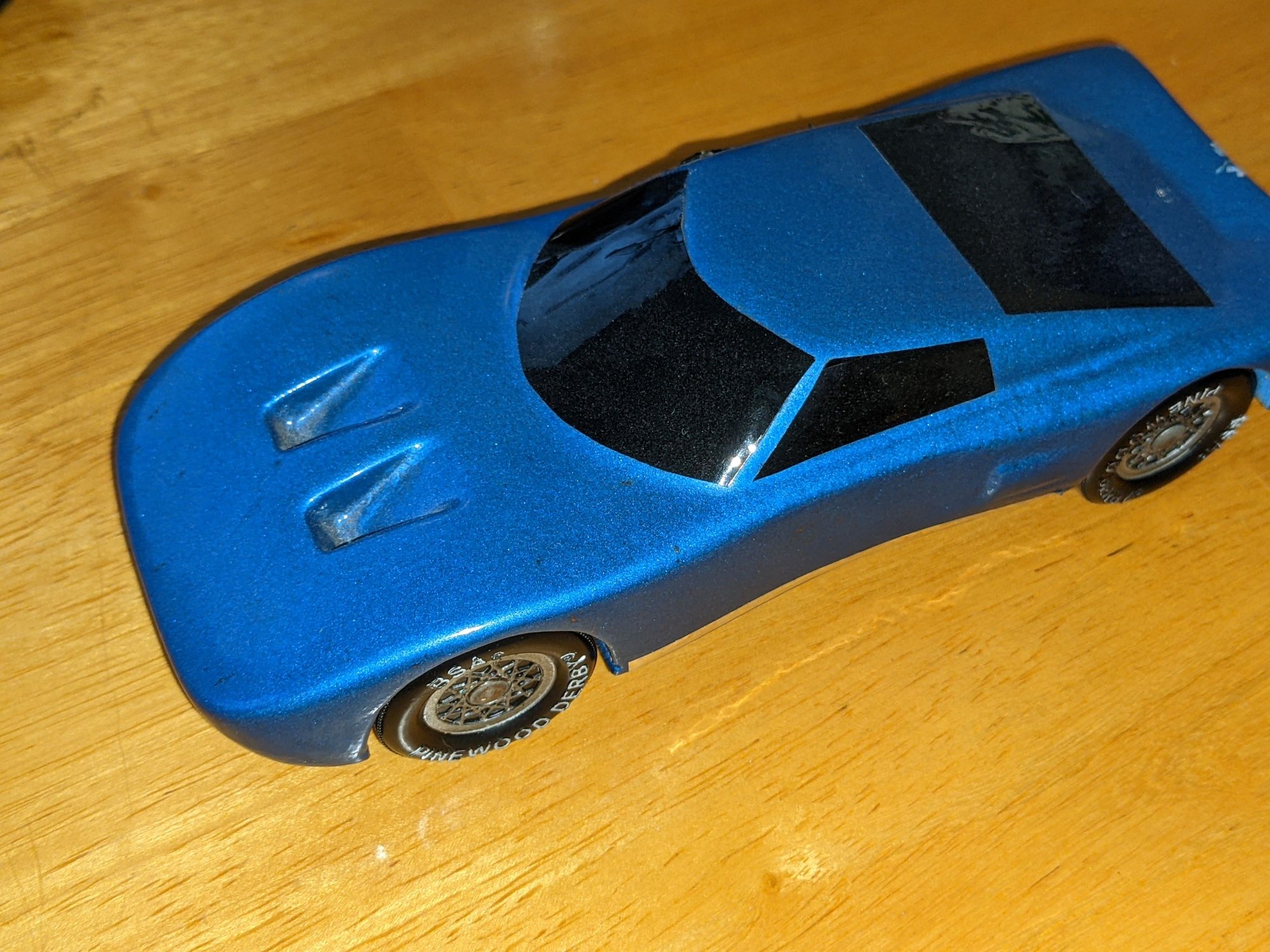

chris, i gave up on watching CNC machines long ago after i built my router table. it is painfully slow due to a poor stepper motor selection, especially doing 3d paths with a ball end mill and 25% stepover. i mainly use 1/8" bits on it for the final pass which can take hours on a relatively small model like this pinewood derby car my son and i built years ago. i now mainly use it to v-carve lettering into metal panels where its 30"/minute max speed isn't painfully slow. my son does enjoy babysitting the new printer but prints, even at 100mm/sec (i know, i'm switching measurement systems but 3d printers seem to be described mainly in metric, about 240"/minute in real units), take much longer than using my router table. i'm perfectly fine letting it grind away on its own, especially since cura provides a pretty good estimate of when to return when it's done.

Sharp looking machine! You won any space cash with it?

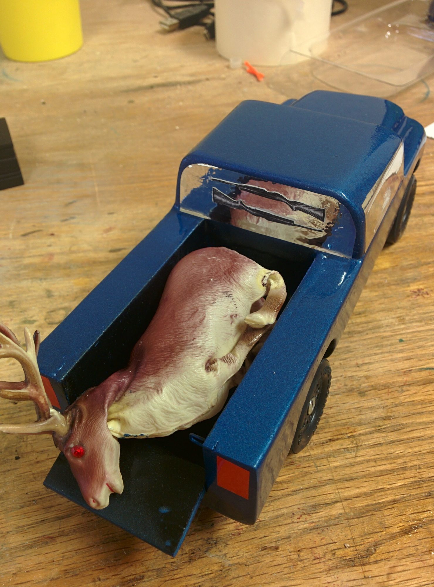

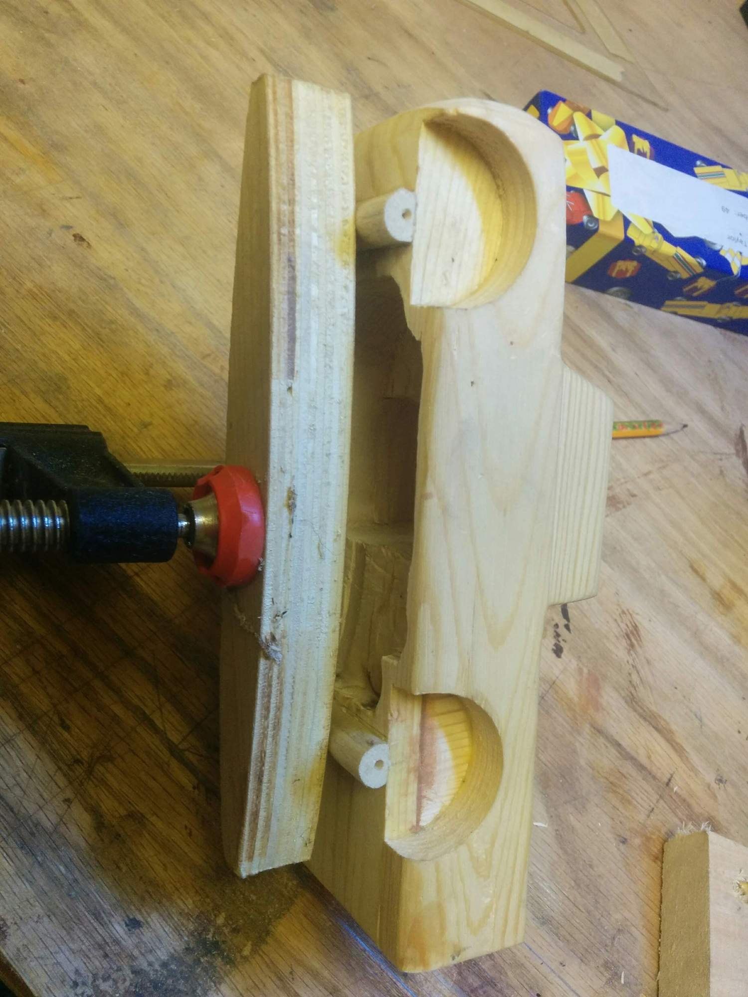

no, but he won best nature theme, best animal theme, and most original with this pickup truck that sat almost twice as tall and wide as the standard pinewood derby wood block car. we added a lift kit, fenders, and a a dead deer in the back. it was apparently "redneck fabulous." ben got to use the wood lathe, belt sander, drill press, and the foredom with the power chisel. not bad for an 8 year old.

Thats Awesome!!!! most original is an understatement!!! Should have had a Saskatchewan licence plate on it just for true effect!!!! Of course the deer would have had to have been bigger... Monsters up here!!!! ;)

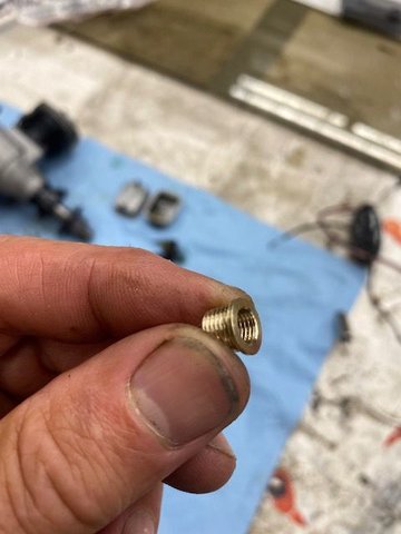

Had a few spare moments and my lathe was crying from loneliness, so I gave GG's insert a whirl as a test... Got it almost right the first try - even got the "short tap" almost right I think.. The backwards reverse thread up to the flange was not as bad as I thought it would be and easy to index except for the fact that 32tpi is beyond my visual resolution.. Had to pull out my old man magnifier... :)
Willing to give this a whirl Lonnie if you want - will give you a call to discuss.

Please excuse my "working man fingernails". Was doing some auto "Brake Work" before play time....

Insert looks good Cat... Indexing you can only get it wrong half the time without reference... all to do about nothing really. :)

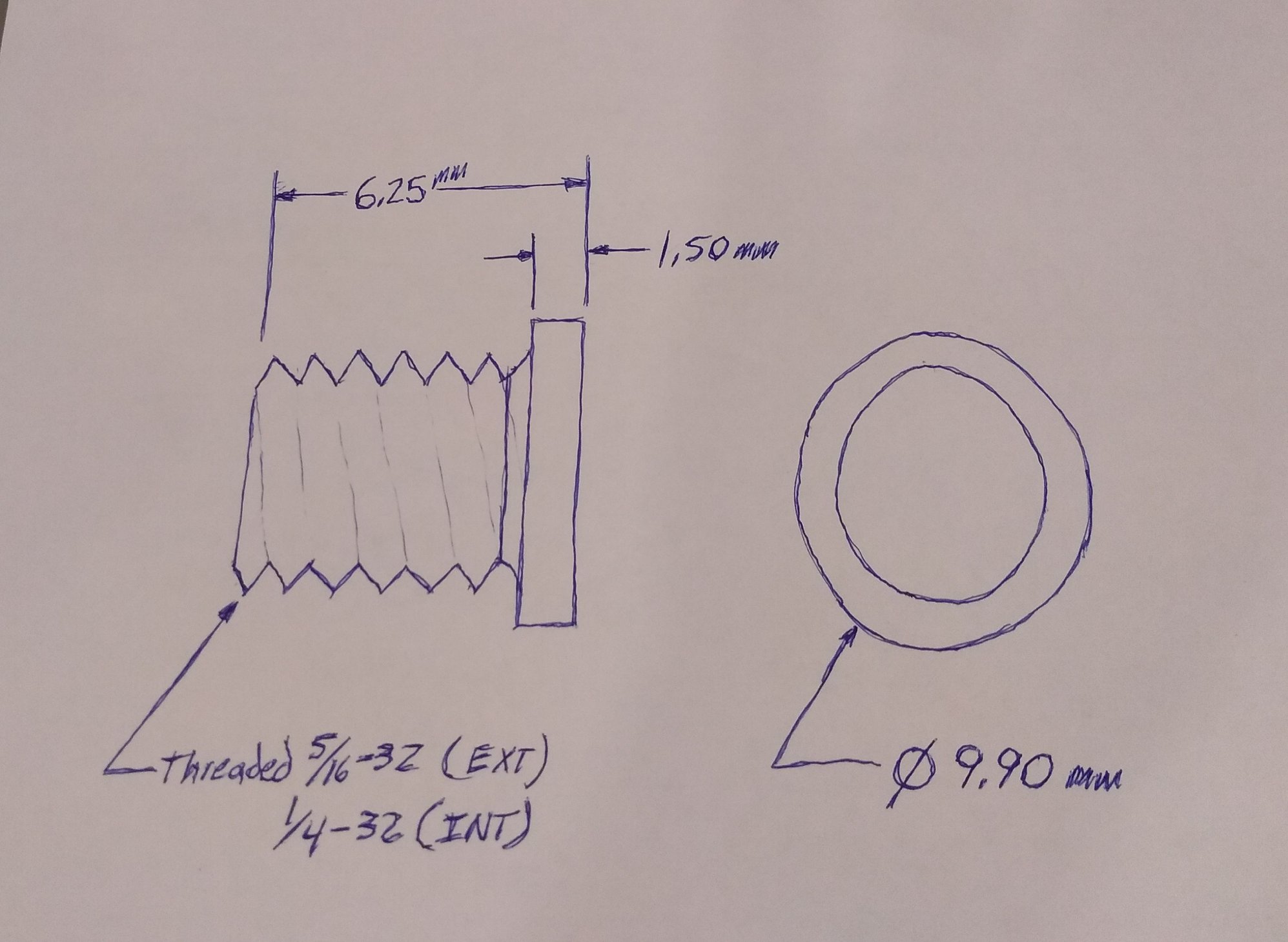

Wow, I haven't even received my material yet and you've already whipped out a part. I really don't understand how you find the time for all these projects but very glad you do.:)
Crappy drawing, but dims are accurate.

Thanks Lonnie - Thats what I needed - Will leave the OD slightly big and you can run it into your incoming Die if need be... Hopefully will find bit of time this weekend to knock out a few...

Got it! Looking good, should work very nicely.

Thanks, a few will do. I'll be sending something your way in return. I'm sure you'll like it.
No need to leave the OD oversized, my 5/16-32 tap and die arrived and the tap fits very snuggly in the cylinder threading. .312"/7.92mm OD is fine. 1-1/2 to 2 threads for swaging should hold the insert in place.
