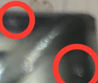

these dots
these dots look like spotwelds there are a few more around the joint.
https://cimg5.ibsrv.net/gimg/www.rcu...917d437284.jpg

Those are not spotwelds, as there is nothing to weld there, also not on the inside. They are probably clamping marks from the welding jig used to hold the two halves in position when welding the two halves together.

is this joint a weak point?
It appears only to have welds on the side and not the inside and outside of the joint.
And does it limit the amount of heat this cap can handle if i choose to solder?
1967brutus 08-20-2022 10:32 AM
I have never seen one of these welded caps fail. The older units (pre 2014 IIRC) were soldered, I had several, they kept well but could snap in a crash. The ones I soldered myself, held less well. One of them came loose under normal use.
I tend to replace the ignition if the cap gets damaged.

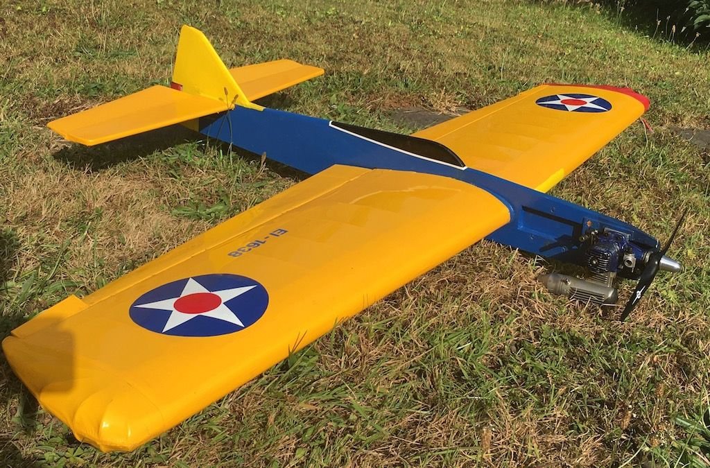

this does not look right
Don't think this plane is designed for .40 engines.
Mounting does not line up at all.
Lets see if other engines fit better.
https://cimg5.ibsrv.net/gimg/www.rcu...2aeea3b922.jpg
big plane, to small engine?

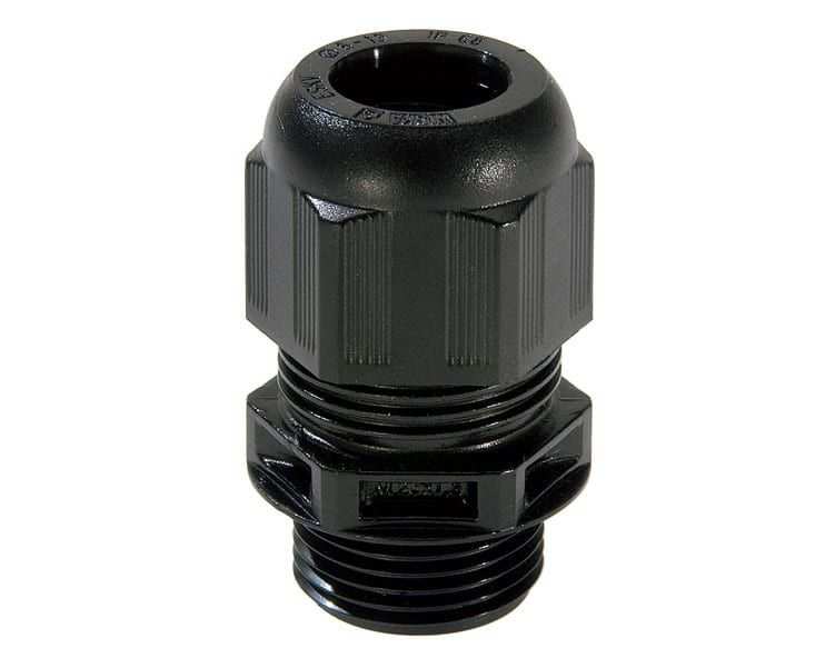

about spark plug caps
The impression i get from looking at mine is that they are just a tube for shielding/ground and a resistor that contacts the center of th spark plug.
There are 2 plastic spacers and a spring. That is all i see.
Should not be too complicated to copy with a lathe or tube bending tools.
What if the plug side is make like a "gland" used with junction boxes.
like one of these
https://cimg1.ibsrv.net/gimg/www.rcu...c111f9706e.jpg
Make a metal version that mounts upside down (compaired to thte picture) and tighten the nut to secure.
If really paranoid about vibrations include a setscrew to lock the nut in place.
The other side could be tube bend with a radius so it can be one piece.
Likely way to expensive to mass produce but as a home made unit it might outlast all others

That would work... a compression collet type fitting, or just two flanges pinched together, that you tighten after positioning the plug lead... it could be made of metal much less bulky than your plastic example.
Full scale aircraft engines use something similar,
https://ibb.co/tKhT90x

In "real" aviation, I have no idea how it is nowadays, but in the past, sparkplugs would have threads, and the HV leads would have some sort of screw on plug, a bit like that gland. At least, I have seen that on the big radials. EDIT, I see John allready posted that, and better than me, with a linky... :D
