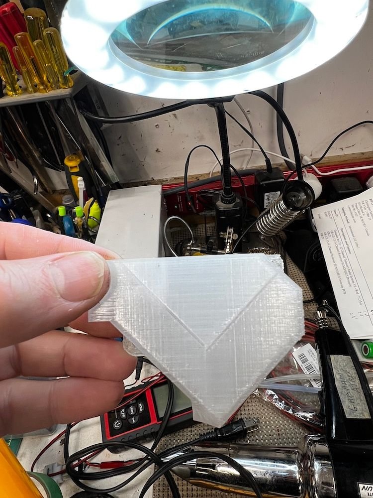

Cat 1 02-16-2023 08:28 PM
Love how this project has these little "detours". I can confirm that 3D printed sealed vessels are possible as discussed. Air tight and fuel tight and fuel (mixed) resistant. Here are a few pics and a video of some of the fun...
https://cimg7.ibsrv.net/gimg/www.rcu...8e9d07f116.jpg
https://cimg9.ibsrv.net/gimg/www.rcu...b80f0c9f5a.jpg

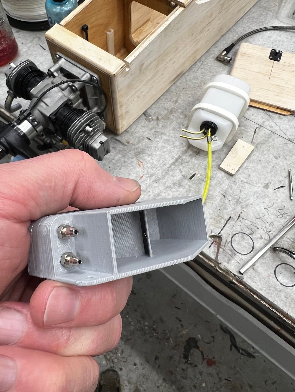

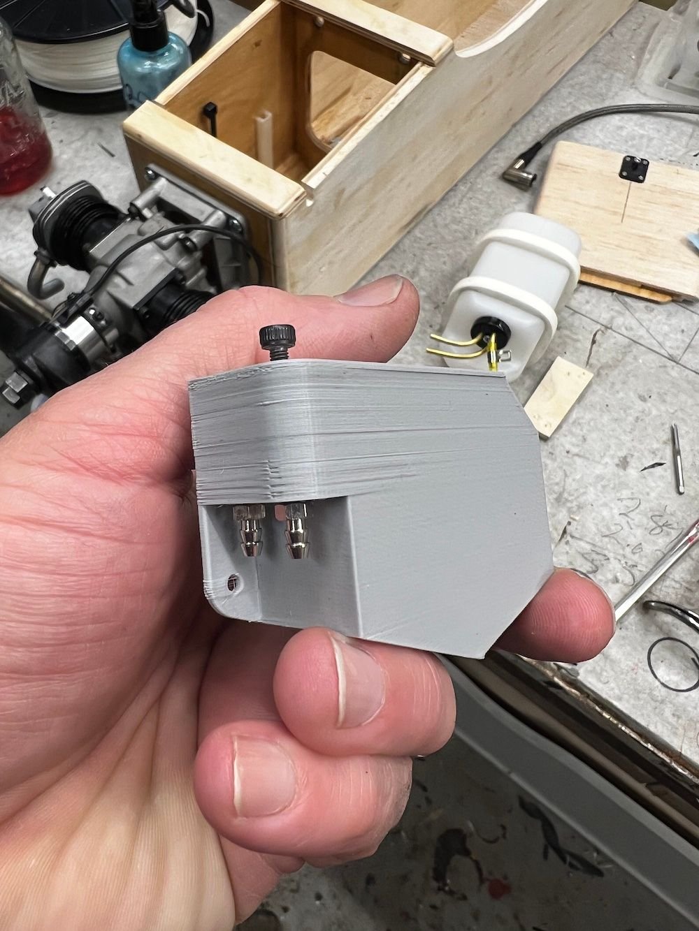

Cat 1 02-20-2023 07:29 PM
SO .... I have a working unit... This is a BT for the Boxer install... fit much better than the aluminum one I made..
I did have a small issue - When I tested this one for Leaks (pressured up to 2 psi under water) I had a few tiny bubbles along a few of the corners - They were very tiny and I don't think they would have even leaked fluid as it held pressure well - None the less I came up with a trick..
I pulled a vacuum on the tank with the little air pump and gave it a quick spray with "plastic part prep spray". Its an aerosol can prep used to make paint stick better to plastic auto parts.. Its a thin clear coat with solvents that bite into most plastics a bit. Tank is now 100% leak proof..
I think the tiny "holes" are the result of the Layer starts - I will try playing with the settings to keep them from "lining up" or to add a little extra material on the layer change.
This part will make my install so much cleaner as lines and connections will be more organized.

Cat 1 03-03-2023 05:14 AM
You guys still Kickin' out there??? Been slow here, but the Boxer mule is ready for covering.. Have the fuel system located and will install after covering.
I did print a "Trap" in Clear PETG and it worked well. Translucent and airtight - Can see contents and structure - Will take a few pics and send.
We are having issues here with Our Regulatory Body (Transport Canada) and our Federal Organization (MAAC) and it has us "grounded" right now but hopefully its sorted soon. Long story but Modellers up here are "very angry" but we are working through the process to get flying "legally" again. We went from having a "Cadillac" agreement and exemption for our flying , to a generic "everything is a drone" rule book because of a lack of oversight and some troublemaking and vindictive organization members. Most troubling.

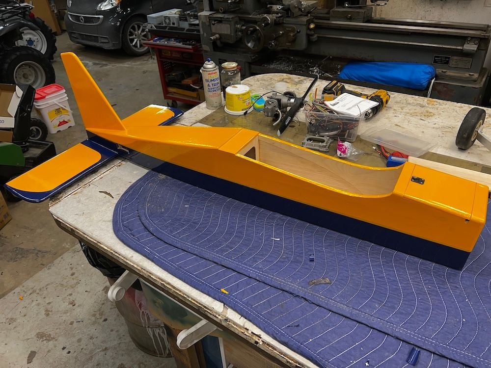

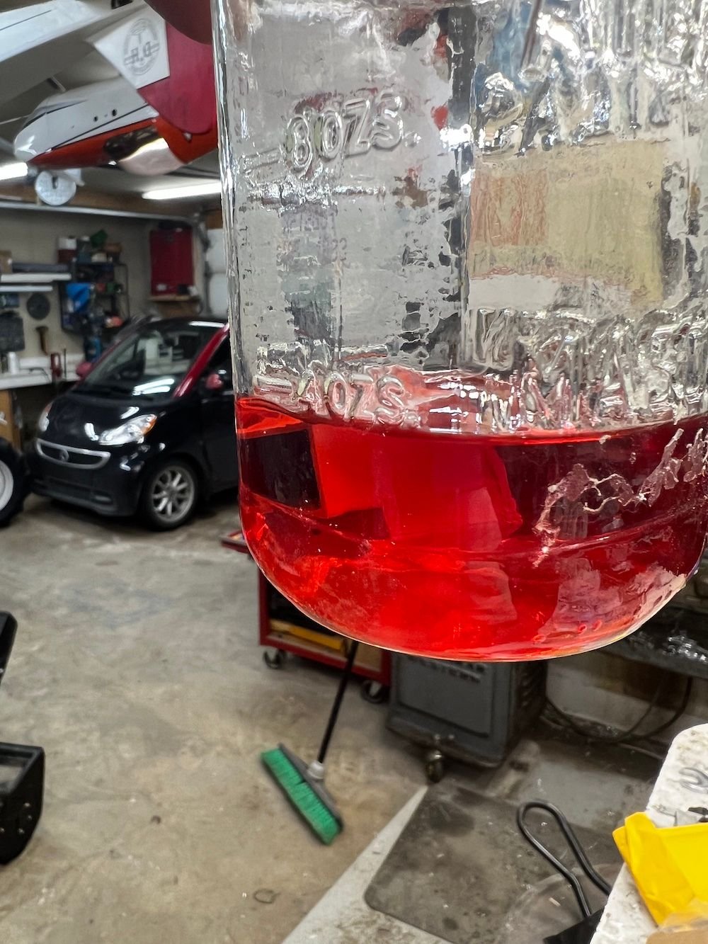

Cat 1 03-04-2023 07:36 PM
Happenings today... Made a deal on the Webra.. Probably paid too much but very rare to see a good one up here. Will a have a close look when it gets here to see if we will try gas.
Got the Boxer Mule fuse covered... I hate covering but once I get started it goes OK... Colors were off the "bargin rack" at the local hobby shop - But I think they work...
Picture of the "clear" trap as promised - Put some water in it and can confirm level is easy to see even with water - Works well as a trap too. Didn't get a picture with fluid in it.. :(
