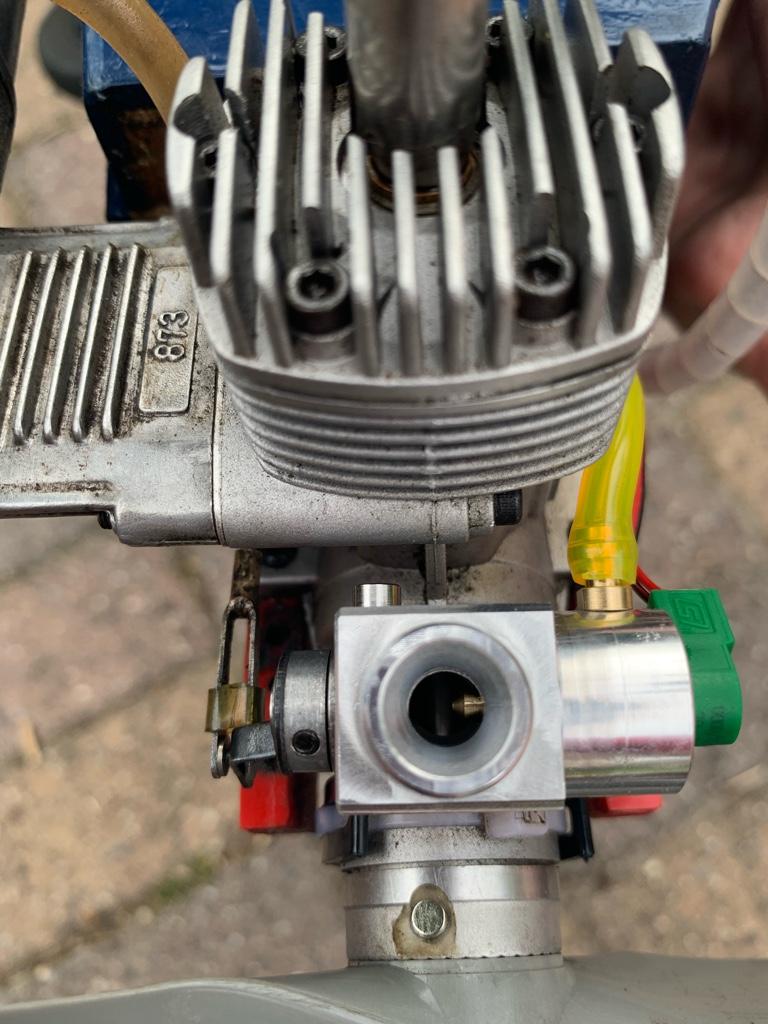

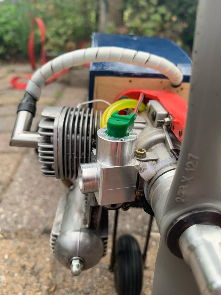

Posting this for Rob.M, because he does not yet have the possibility to link pics or vids:
Attachment 2271991
Attachment 2271992
If the links won't work, I'll figure something out...
https://www.youtube.com/watch?v=G9ZnHzLDWPU
This is yet without airbleed. Rob has flown it, and reports excellent behaviour in the air, and good adjustability of the fuel curve, BUT, same like Chris, a slight irregular idle, so his next step will be a tiny airbleed hole to see what happens.
Having given this a bit of thought, I think, that this irregular idle is caused by the pretty low fuel opening values of the curve: the solenoid is open for a very short amount of the total time, and due to its fixed frequency while the engine runs "whatever it likes to run" some valve openings are in the middle of the induction stroke, others are while the induction port is closed, and some induction strokes occur with fuel supply, others without, resulting in a varying mixture strength in the buffered mixture in the crankcase (at idle, it is my estimate that the total refreshment rate of the crankcase volume is less than once per 10 revolutions so when supply is intermittent, that leads to varying average mixture strength).
The use of either an LS needle OR an airbleed will force the fuel curve upwards, which causes the solenoid to be open for a larger percentage of time, reducing this effect.
Anyway, whenever Rob has time, I think I'll have a few 2-strokes that could do with a new carburettor :D :D :D
What is nice to see, is that also THIS idea, is repeatable by others, and for that, a big thumbs up to Chris, and just as big to Rob for proving that.
I love seeing these developments, and I an sentenced to spending a month on a ship in the gnawing knowledge that when I come home, there will be a plane at the clubfield that I am going to be "slightly jealous" of... :D :D :D
WOW!!!!WOW!!!! - Only thing more exciting than having my own carb work is actually seeing another one work!!! Bravo Rob!!!
I agree with Bert that the idle issue is caused by the low "duty cycle" of the solenoid at idle - The air bleed made an immediate improvement on mine but I think its still a item to be worked at - Would like to try a "oblong" hole on the top of the barrel - Rob's issue at idle sounded exactly like mine.
When I get time I might also try a "Slide Barrel" style carb. - Have also considered the thought mentioned previously with an "Air valve" with a fuel injection point after the air metering (Webra dynamix was like this) but I think the "suction" might cause issues as we see with the fixed jet carb of excessive idle fuel flow requiring a very low open pulse on the solenoid. I think a slide carb could be made with "cutouts" like a round slide Mikuni to correct the idle suction and flow and would still offer a better "Venturi" area than a barrel carb.

1967brutus 07-13-2022 10:24 PM
Originally Posted by cmulder (Post 12735094)
There is nothing in those forum rules that the first 10 (?) post have to make sence.
Post about the weather or what desert you had for dinner.. No one here is going to complain ;)
just a thought (and another post to inflate my stats :)
Nah... he's not the type of guy doing that...
1967brutus 07-13-2022 10:34 PM
Originally Posted by Cat 1 (Post 12735125)
Bert and Rob...
On the air bleed addition - here is the issue with the one noted in my "revisions" I sent - It does get the idle setting off the bottom but its effect goes away quickly off idle - Can be seen by the dip heading to mid range. I think an "asymmetric barrel hole"
might work better.
https://cimg5.ibsrv.net/gimg/www.rcu...a9d228d060.jpg
The LS needle carbs show a similar shape of curve, at least, most of mine do. That has so far never shown to be a problem.
The biggest issue is that at low RPM, there is not much kinetic energy in the system (the mechanical side of it, the moving parts) which make small irregularities pretty noticable.
With the tech availlable, not much to be done about that electronically, and solving it by means of an airbleed or asymetric throttle bore might turn out to be fairly critical and engine specific because of lack of adjustability.
I would think an asymetric bore of the throttle body might be a good solution and perhaps a slightly tapered bore of the barrel might prove to have general better behaviour overall. The trouble is: there is only one way of determining the needed assymetry or taper and that is empirical.
I would hope for something more user adjustable to maintain the "onesizefitsallability"...
Reality for me however is: If I put my heart into it, I can get an engine to idle indefinitely on the ground. No probs and not even a solenoid needed. Lookey here...
I mean, that is .52 fourstroke tuckering away indefiniteley at 1700 RPM, on gasoline, 6 years ago and no solenoid yet... The trouble was that it would not respond well to throttle when tuned like that.
I found that a nice idle on the ground, well, it is nice, but it is not what you necessarily need in the air.
Most of my planes, on the ground I need to "help them a bit" (run a slightly elevated idle) to keep the fire going, but in the air they simply don't quit, no matter what I do.
I would in general advise to tune for flight, not for the ground, and before any adaptations are going to be made, first work out how it functions in the air, because it might turn out that what is done to improve idle on the ground, works out negative in the air...

Just a general question to you and also Rob: How many hours did you guys spend fabricating the body and barrel?
Rob.m 07-14-2022 08:41 AM
Bert.
the milling time for me on the 5 axis milling cutter was a total of 25 min. the rest was turned by hand and only the square hole in the gas valve was milled and was 4 min. programming the housing took about 2 hours, all in all, to get a complete product, it takes me about 4 to 6 hours of work.
John_M_ 07-14-2022 09:32 AM

Cat 1 07-14-2022 06:12 PM
I would concur with Rob's estimation - I could probably build one on my Manual equipment (second time around) in 3-4 hours. Its not a complicated part but its still a part best done on automated tooling - I have done a few limited run projects on manual equipment and it quickly becomes tedious and monotonous and not worth the time investment. CNC changes everything as this should be a simple setup for a limited production run but not sure what that's worth nowadays.
1967brutus 07-14-2022 10:06 PM
Then I am not going to pursue that... Too many uncertainties.
1967brutus 07-15-2022 01:11 AM
Originally Posted by John_M_ (Post 12735200)
You don't need the valve fully closed. you don't run an engine with the carb needle valve fully closed, all the solenoid is doing is replacing the needle valve and modulating the fuel mixture.
That's the thing... I doubt this solenoid will do ANY "proportionality" pretty poorly. I simply doubt that will work.
As I hinted at before, if you would make a valve with a Piezo-actuator, now THOSE would do proportionality pretty accurately, have no heat generation and no wearing parts... BUT... they need fairly high voltages to actuate them, and there is to my knowledge nothing readymade on the market for this kind of application. That is a whole different can of worms.
