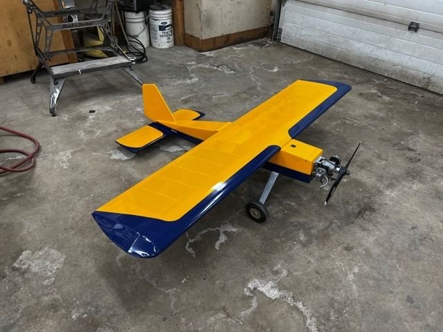

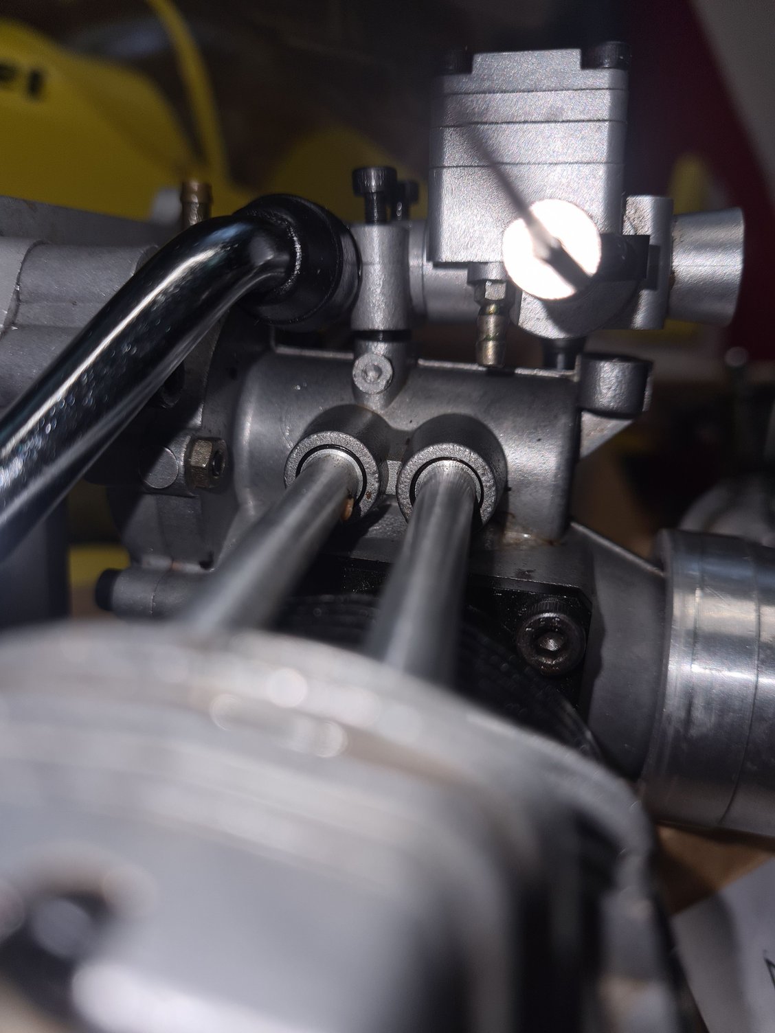

But these engines indeed are nice runners, I have one myself and it is a sweetheart of an engine. A bit picky on the prime (it wants a pretty "exact" amount of prime or it won't handstart, but when done right it is a first-flick starter).
In use, cooling is a bit marginal, and attention must be given to proper baffling/air guidance. The devil is in the details here, it took me quite a bit of experimenting before I got it right.
Just a note: Pass the fuel line OVER the HS needle extension, because the way it is arranged now, over time will chuff a hole in the fuel line.
