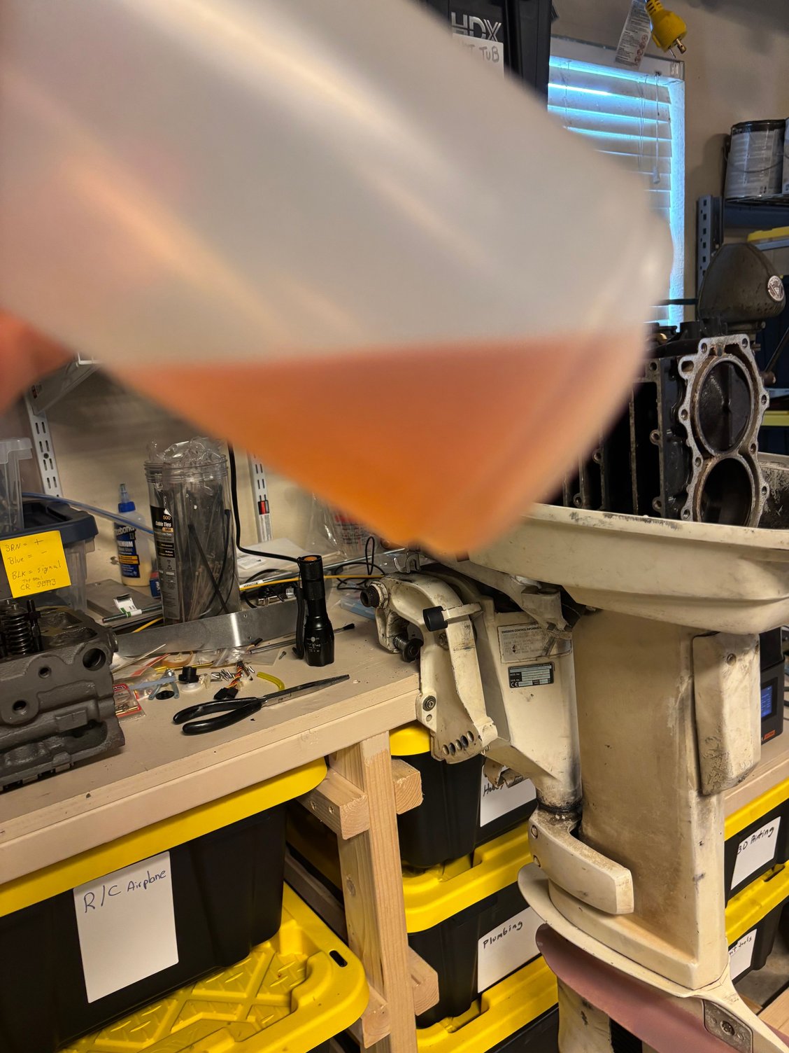

Bernett 04-07-2026 05:57 AM
https://cimg9.ibsrv.net/gimg/www.rcu...fbfe03faf.jpeg
https://cimg8.ibsrv.net/gimg/www.rcu...d2453dd85.jpeg
https://cimg0.ibsrv.net/gimg/www.rcu...fcdebc5f0.jpeg
My crap trap. It’s air tight and yet easy to empty.
1967brutus 04-07-2026 07:03 AM
Originally Posted by Bernett (Post 12832284)
Has anyone thought or tried to modify the backplate of a nitro 2 stroke to mount a walbro? I was thinking you close off the front and mount the walbro on the back. I know some of the rear mounted walbros use reed valves. I think some others don’t. It’s just a thought.
It COULD be a possibility, but it will near guaranteed affect pumping efficiency of the crankcase due to additional "dead volume".
This affects scavenging pressure, which in turn will affect engine performance.
Possible, but a lot of metalworking, probably adding quite a bit of weight to the engine, making beam-mounting awkward, and less power,
I cannot think of a single upside. Not even the use of a Walbro, which as I have said more often, does not have a place below 15 cc.
1967brutus 04-07-2026 07:09 AM
That WILL work.
Minor detail, it will work a touch better, if you bend that tube going to "half height" in such a way that it ends up at half height, in the centreline of the bottle.
As is, there is a theoretical possibility that crud could get into the fuel tank, and it takes just a very tiny bit of crud to turn your fuel into black dirty stuff clogging the feltclunk eventually.
Bernett 04-07-2026 09:40 AM
I added a tube to half the depth of the container per your instructions on how to build one of these.
1967brutus 04-07-2026 03:35 PM
Please don't take it wrong, I am really NOT trying to be pedantic here, but...
You missed something:
Originally Posted by 1967brutus (Post 12831834)
I typically use a 10 or 15 ml Syringe... Pull out the plunger and discard.
The nozzle is capped off and serves as drain, and in the top, I plug the barrel off, and one short tube, for connecting muffler pressure, and a second tube that goes all the way to exactly halfway the barrel, in the centerline, serves as the connection to the fuel tank.
Regardless of hos you turn, roll, elevate or otherwise move the plane, the crap cannot pass through to the fuel tank until half the barrel is full.
During fuelling, simply uncap the drain nozzle, and the crap drains out, AND it prevents that gasoline from overfilling reaches the muffler. For methanol never a problem, just a bit messy, but for gasoline, you might see some spectacular flames upon starting the engine if there is fuel in the muffler.
It is not a big deal, and depending on intended use of the plane, you can get away with your solution, but for me it is simpler to use only one single principle regardless of flight envelope.

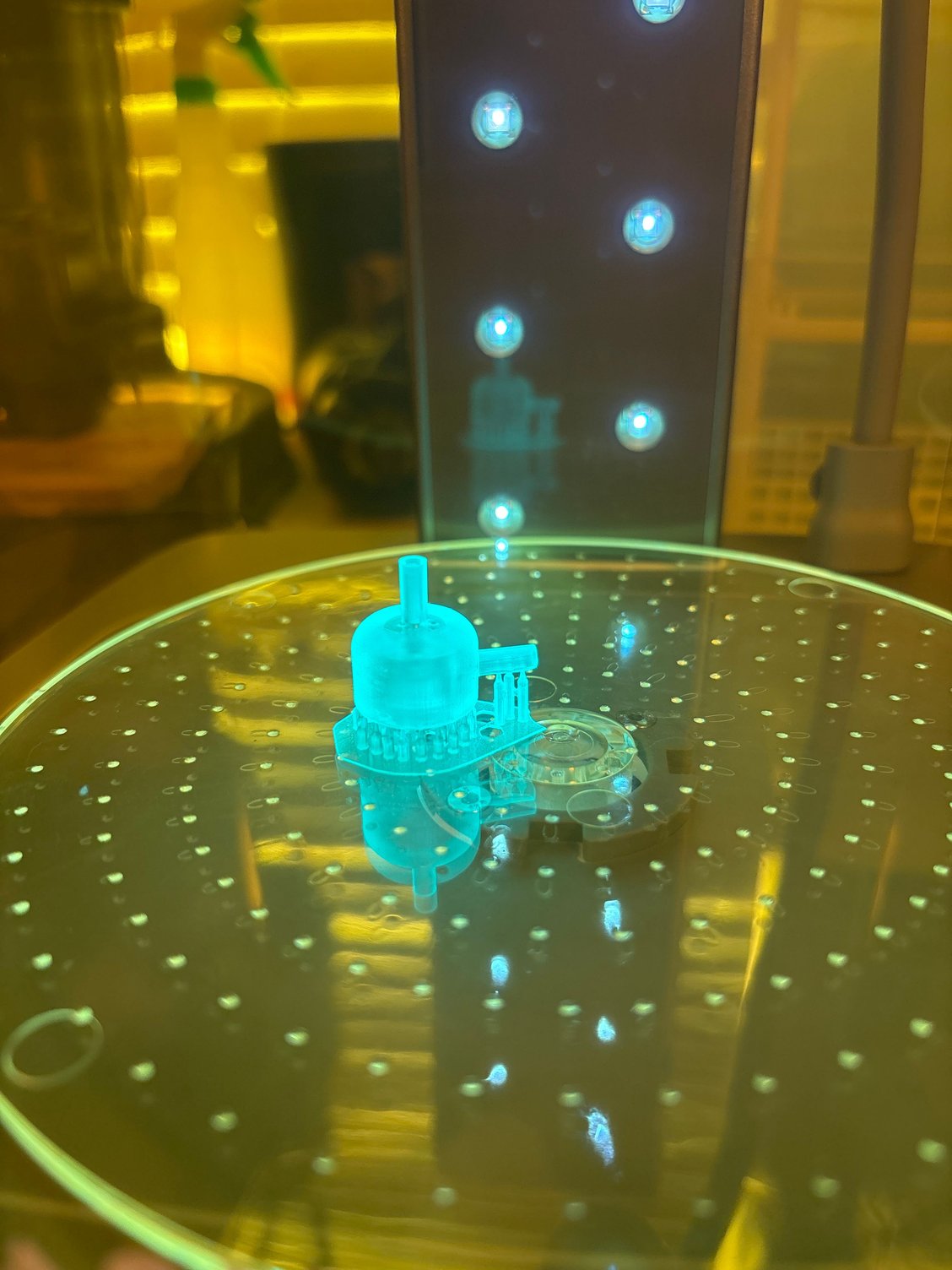

First 3d resin print of solinoid housing curing in the UV light machine. This is just a test fit while waiting for my fuel proof resin to arrive.
https://cimg6.ibsrv.net/gimg/www.rcu...f21f65214.jpeg
Raleighcopter 04-14-2026 05:30 PM
I feel like of you're going to load a resin machine it makes sense to print a bunch rather than just one but I don't have a resin printer. How much work is loading resin and then emptying and cleaning it when you're done printing?
xanaphyst 04-14-2026 06:08 PM
Well this was my first print ever so I figured I’d give just one a try. Adding resin was as simple as dumping a little in the tray. I haven’t tried to empty or clean anything yet so I really don’t know. I bought the machine to print solinoid housings as I didn’t have access to any other method at reasonable cost.

xanaphyst 04-15-2026 05:04 AM
Originally Posted by 1967brutus (Post 12832524)
Awaiting your results anxiously...
Print results look very good. The dimension check shows measurements are consistently 0.01mm too small. I believe this may be shrinkage during the UV phase. Measurements will be changed in the file to compensate
the offset. The fuel nipple is a good fit on my fuel line and the nipple is much stronger than I thought it would be. I applied a good bit of force to it and it did not break off. With this information I will change the hole in the side of the housing
to be another fuel nipple.

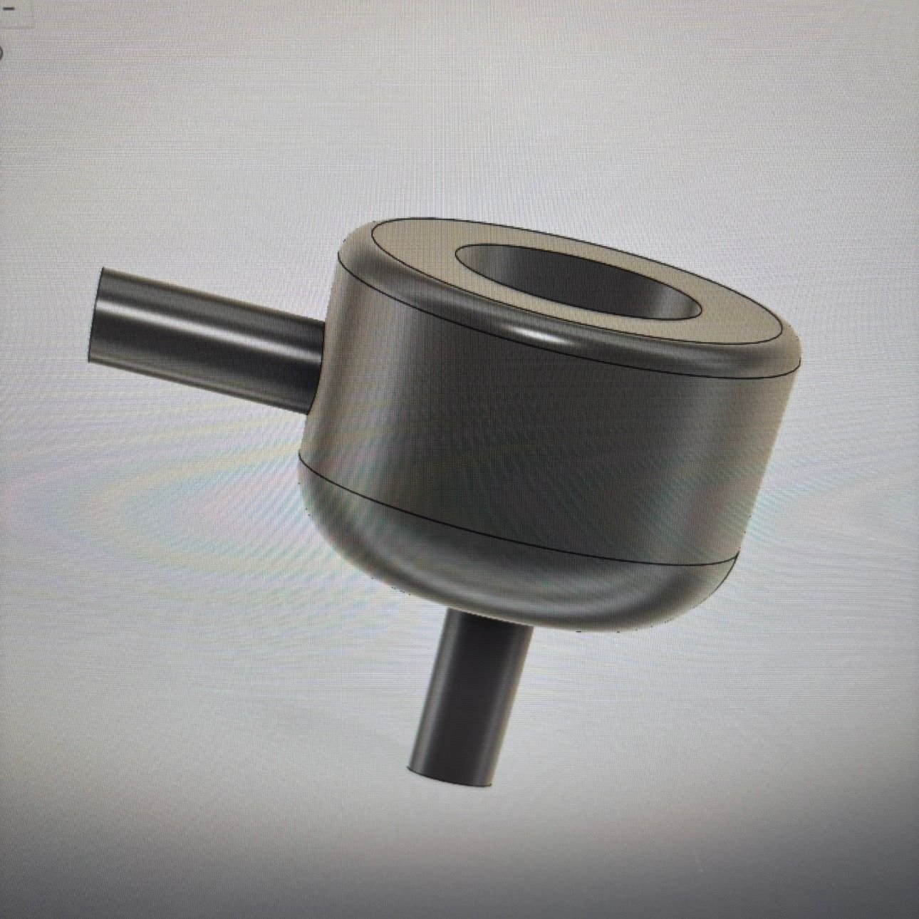

xanaphyst 04-15-2026 05:35 AM
Rev 2

Raleighcopter 04-15-2026 07:05 AM
not sure about your slicer but the slicer i use for my FDM machine has a setting to increase hole sizes in horizontal surfaces in order to compensate for shrinkage due to temperature change from printing to ambinent. there may be a similar setting in your slicer that will allow you to maintain the correct dimensions in your model and compensate in your print.

xanaphyst 04-15-2026 12:05 PM
Soak testing Rev 1 in gasoline. If it still feels hard after 24 hours of soaking I will try Rev 2 on my engine while waiting for the proper gasoline resistant resin to arrive.
https://cimg3.ibsrv.net/gimg/www.rcu...d5cb8f067.jpeg
xanaphyst 04-16-2026 10:18 AM
The good news is that my current resin seems to be no issue with gas.
The bad news is the sharp edges inside the solinoid housing appear to maybe have cut my oring because my assembly seems to be making air bubbles on the test stand when in use.
I went back and redesigned the solinoid housing so that the inside edges are smooth with an edge fillet.
Now I have to order a new solinoid but the good news is that the design should be finished now.

Raleighcopter 04-26-2026 04:51 PM
I would also add some fillets to the nipples that the tubing connect to. There's a stress concentration there and that's probably where it'll fail from vibration induced fatigue. Better yet would be to build the resin part so that it has holes where the nipples go and epoxy in some brass or aluminum tubing instead. It may make the housing a bit taller but it'll be vastly stronger.
1967brutus 04-27-2026 07:15 AM
Possibly also a better seal between tubing and nipples?
