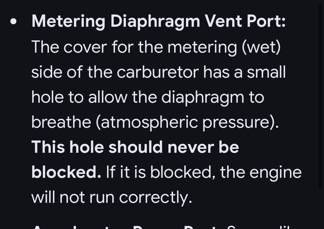

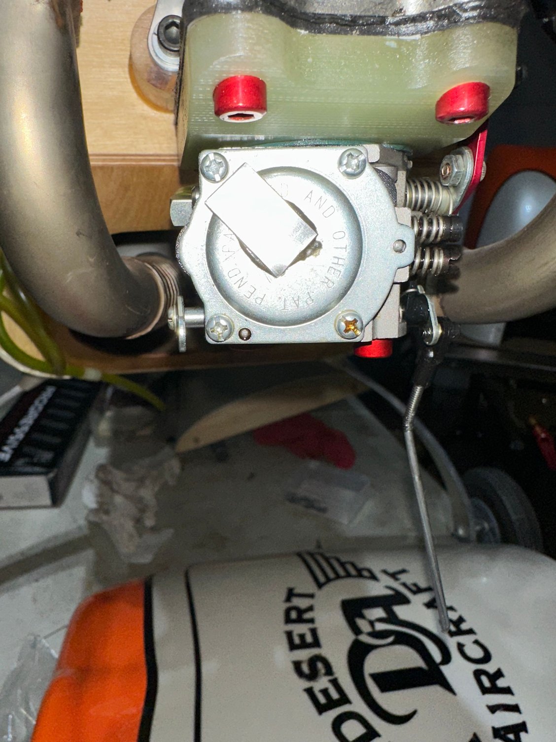

Just pick up a used Carden with a DA 100. Was told that it had running issues. I think that I found the problem.

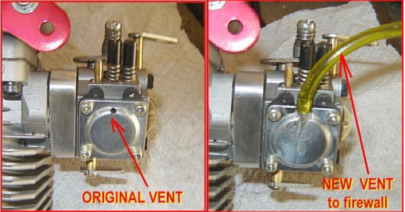

Yep think you found it Solder a tube in the hole,and run the line inside the fuselage
that sounds like a good plan. I’m going to put all new lines in too and maybe a fresh stopper. It has a Dubro tank but has aluminum cap instead of the black one.
