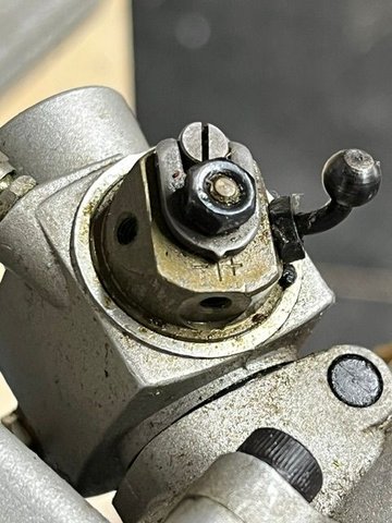

I have an OS .61 that has a ball throttle hook up on the engine. The ball is about.186 Dia. I cant find any ball connector that will fit. Anyone have any suggestions?

I have used the Dubro 2-56 ball link, just pop the ball out and attach to the carb.
SKU 367
