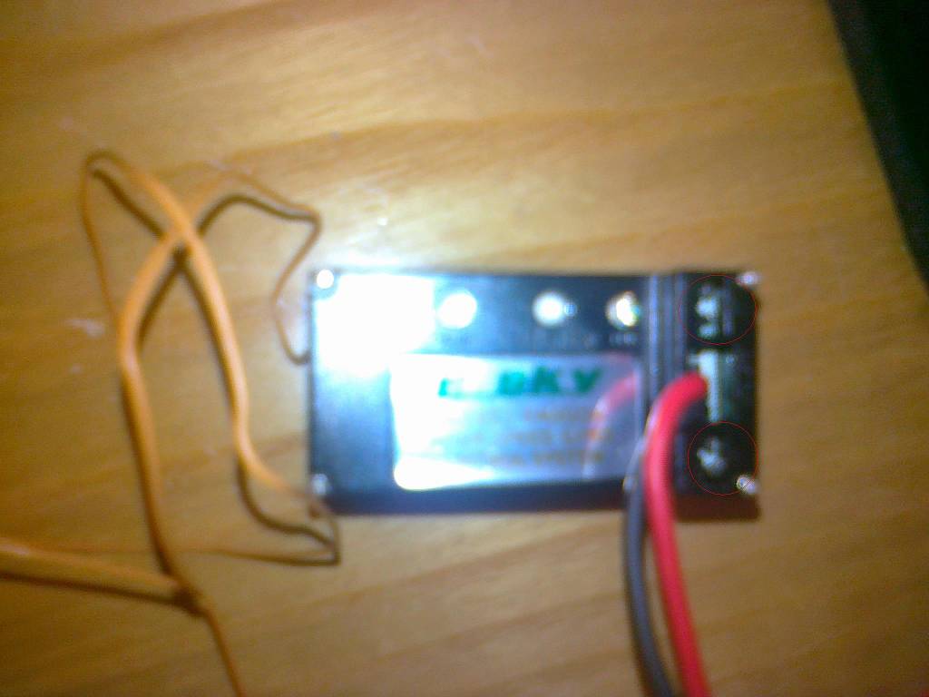

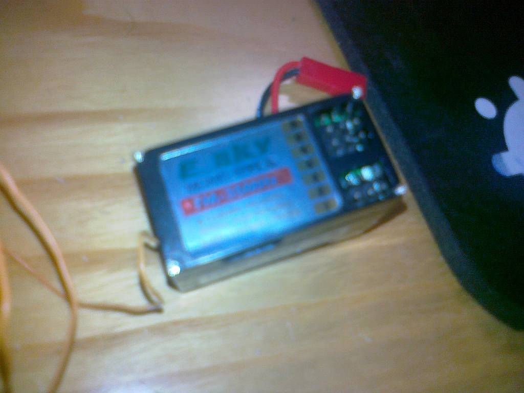

Hello a friend of mine gave me an esky twister 6 channel(see pic) couple of days ago. I decided yesterday to check if it works coz it was in his basement like 2 years... thereciever didnt work so i bought a GWS R8MSL+. I connected the servos and they were working fine but when i connected the motors both were accelerating to full and i couldnt control them from the transmiter. I noticed that servos have 3 cables on each plug(brown orange red) and motors have 2(red and black) so i guess thats why i can't control them from the transmiter. Also the old reciever had 2 special plugs for the motors, probably thats why i can't control them from the normal plugs that servos also fit in... so any ideas how to fix this?

First is the RX you put in a 4in1 type as the twister is just a Honey Bee CP.
The 4in1 has the Gyro, Tail Motor control and ESC in it along with being the RX.
I would think that most of the parts for a Honey Bee CP would work.

TO conver to a standard RX you would need 2 ESC's one for the Main motor and one for the tail rotor, and a gyro, much cheaper and easier to get teh correct RX for the heli.
It is niot just a matter of replacing the 4 in 1 with the items they all have to be set up to work together, and the tail motor control is a real hassle.
Get teh 4 in 1 for teh Honey Bee CP it should work fine. Ido belive you could also use the E-Flite Blade CP, but I am not sure about that.
The new RXwill not come with a crystal, you will use the one in teh old RX that came with the heli. That way you have a matched set.

The picture that you posted of teh 4 in 1 is fuzzy, but there should be an Esky part number on it. As I could still read Esky, so Esky Honey Bee FPparts will work.
