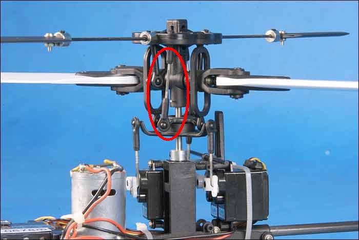

Whiptail: Yes, the pitch connector is attached to the swahplate at one end, and the pitch rocker arm at the top.

ORIGINAL: deves
Is this the pitch connector adjustment?

No ...if u look an inch or so to the left of were your pointing u'll see a little metel rod with plastic ball links on either end...this is the pitch link

Ok so i adjust this on both till i am level-ish?

If u make that bar longer it will increase pitch for that blade...make it smaller to decrease....So if u are tracking your blades and blade A is lower..then u increase pitch to this blade only
